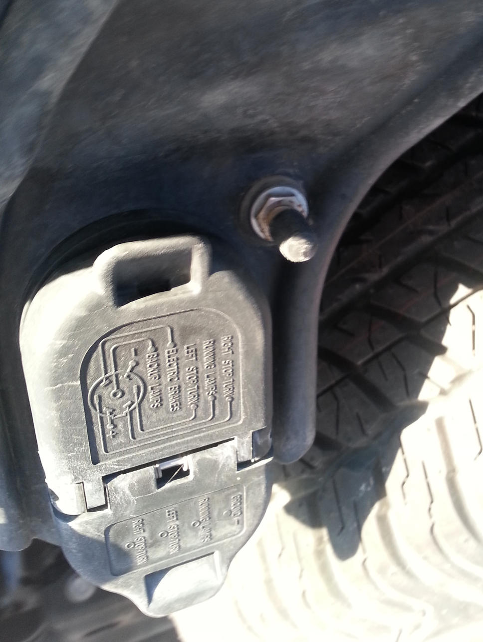

Installed them myself and they work perfect - towed a 2700 lb trail manor with no issues. - on the install I just cut out the bump stops only 4 of the 5 levels even though they recommend all 5 - ran the hoses to the rear where the 7 pin trailer light connector comes out.

Raven, I ordered model #60809 from Auto Anything. On the website it shows that the air bags are for 2003-2012 4Runner; however, they fit my 2015 just fine.
