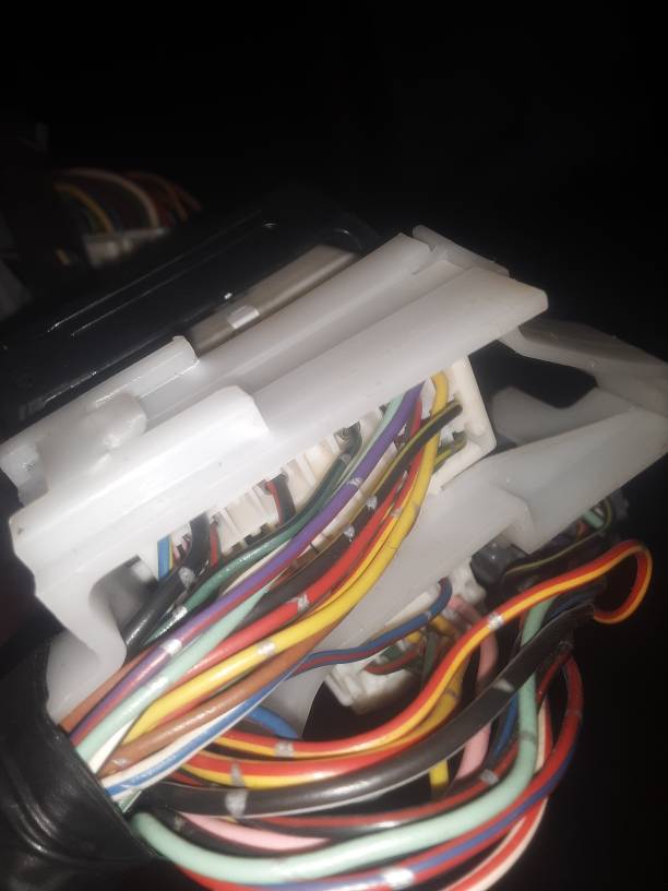

Looks to me like all the colors match. I know the small connections do and It sure looks like the large ones do too.
Verify with your 98 engine harness and if they do. It maybe best to swap that engine harness over to the 98.
I try to check tonight thoughly on that large connector. I just out of time now. :)

Oh no. Actually I may. My 98 that i am stripping was mfg 4 /98. I believe my limited is a 1997. If this is the case. I will not need this engine harness. I need to verify this to make sure I am correct. As I be swapping a 1997 harness to this engine.

if the harness has this part number on it? it's the one I need.
82121-3D391
turns out that is a very special year of wire harness.... and not many around really.
<a href="https://imgur.com/dOjPBmS"><img src="https://i.imgur.com/dOjPBmSl.jpg" title="source: imgur.com" /></a>
right now this is my wire harness... it's a lot easier to get them off when the body is up in the air... ouch my fingers!
I'm kind of bummed because I separated the starter portion out. at least in 97 there is no physical connection between the engine harness and the starter portion. to my knowledge none of the years had any connections. they just wrapped them up together for easy packaging I would think.

Well I just checked my limited and its mfg was 11/96 so it's a 1997. I wont need the 1998 harness. However the 1998 is a limited. So I need to check those numbers. Hopefully tonight we will know. :)
