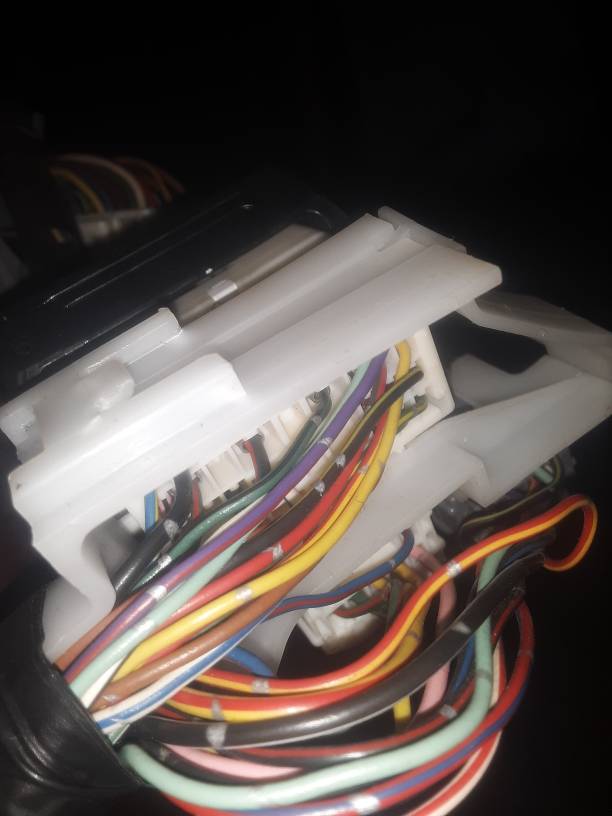

I went thru the E9, E10, E11, E12 and I don't see any differences. The only thing I do see is they changed one of the Symbols, but the wire color and the condition, STD Voltages are the same. so just a document change.
it has to be in the II1 and II3 plugs
<a href="https://imgur.com/bo9LmNj"><img src="https://i.imgur.com/bo9LmNj.jpg" title="source: imgur.com" /></a><a href="https://imgur.com/4oQR5iw"><img src="https://i.imgur.com/4oQR5iw.jpg" title="source: imgur.com" /></a>
if I could find out what those plugs are supposed to be plugged into for each year? 97,98 I think that would make things work? I think.

LOL.. I am an Electrical Engineer I can read them.
So you are thinking the 2 Glove Box connections II2 and II3 have something different from 1997 to 1998?
I always thought those were just engine harness disconnects. As with the other plugs for the engine harness that go directly to the ECU..
I see in the morning here on my parts rig to see if these wires change colors when they go through that glove box connector.
As I have the dash 95% out its easy to look at those plugs and verify.

in this case because they are the 97 from engine harness the plugs are Version 1997. the connections are version 1998.
physically comparing the V97 vs V98 and connector type
1997 II1 dark grey -> 1998 II1 dark grey
Pin 1 black/white->Pin 1 black/red *mismatch color
Pin 2 violet->Pin 2 violet
Pin 3 yellow/green->Pin 3 empty *mismatch
pin 4 light green->pin 4 light green
pin 5 black/yellow->pin 5 black/yellow
pin 6 black->pin 6 black/white *mismatch color
pin 7 black/blue->pin 7 black/blue
pin 8 red/blue->pin 8 red/blue
pin 9 red/yellow->pin 9 red/yellow
pin 10 empty->pin 10 white/red *mismatch color
1997 II3 White ->1998 II3 White
Pin 1 violet/red->Pin 1 violet/red
Pin 2 light green->light green
Pin 3 black/red->black *mismatch color
Pin 4 blue/yellow->blue/yellow
Pin 5 white/red->yellow *mismatch color
Pin 6 red/green->red/green
Pin 7 white/black->white/black
Pin 8 green/black->green/black
Pin 9 black/red->black/red
Pin 10 blue/red->blue/red
Pin 11 empty ->green/red *mismatch
Pin 12 pink/black -> rest down match fine
Pin 13 black/yellow
Pin 14 red/yellow
Pin 15 brown/red
Pin 16 green/red
Pin 17 white/blue
Pin 18 black
Pin 19 pink/blue
Pin 20 white/blue
Pin 21 green/yellow
Pin 22 green/black
Pin 23 brown
Pin 24 yellow black
Pin 25 green white
Pin 26 yellow red
so just the mismatch is

Looks to me like all the colors match. I know the small connections do and It sure looks like the large ones do too.
Verify with your 98 engine harness and if they do. It maybe best to swap that engine harness over to the 98.
I try to check tonight thoughly on that large connector. I just out of time now. :)

97 Pin 3 II3 white Starting circuit for the 97 is all B/R So it comes out of the 97 engine harness B/R and then goes black to the 98. If you can find the color for the starting circuit on the 98 you might be able to match them up. FYI the wiring foe the 97 is unique to itself. Even the auto and manual of 97 have different wiring even though a lot of it lines up pin placement and color wise
