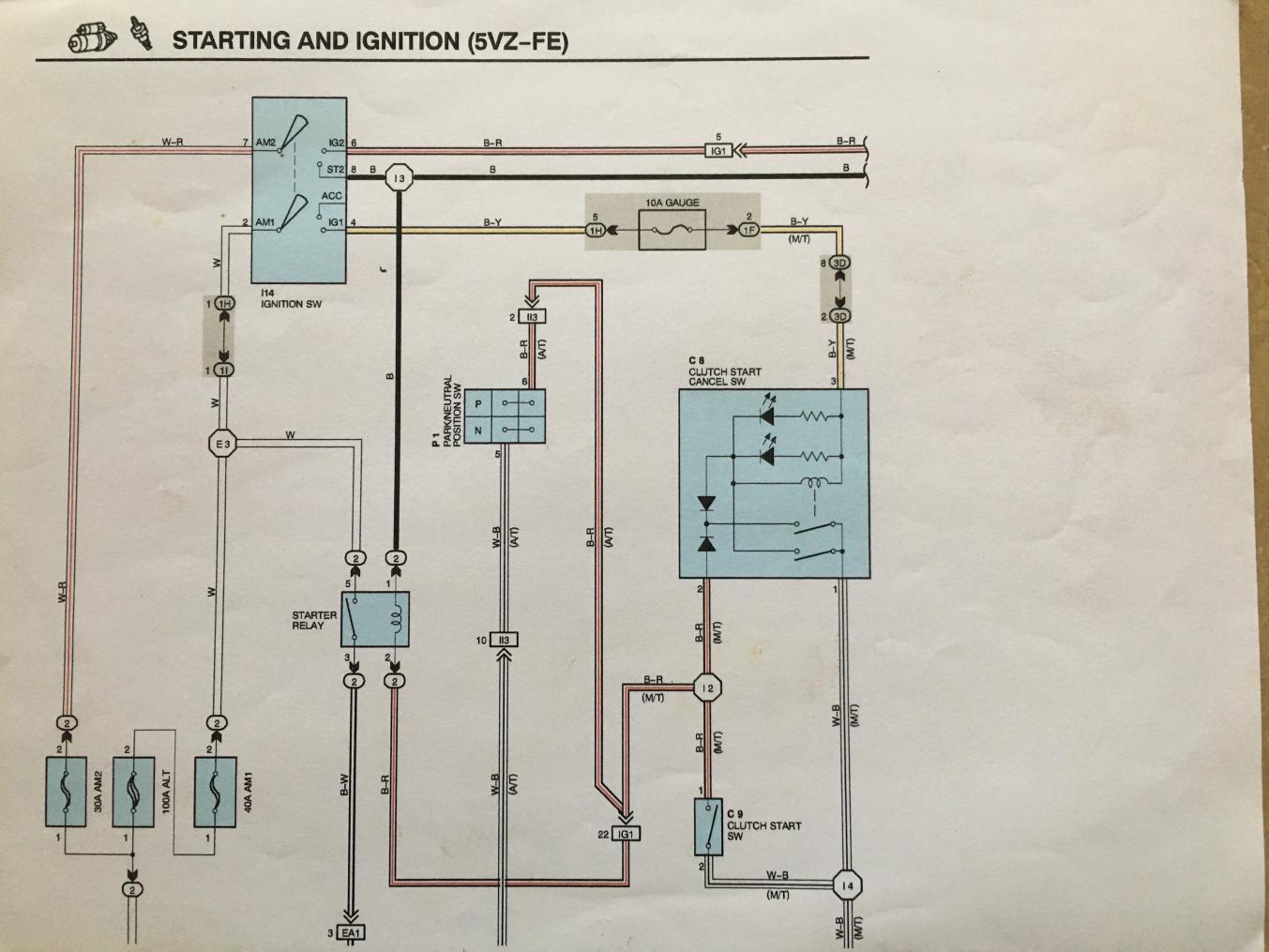

The FSM
S1 (A), S2 (B) STARTER
Points closed with Park/Neutral position SW at P or N position and ignition SW at ST position
I14 IGNITION SW
7-6 : Closed with ignition SW at ON or ST position
7-8 : Closed with ignition SW at ST position
P1 PARK/NEUTRAL POSITION SW
9-6 : Closed with A/T shift lever in P or N position
STARTER RELAY
3-5 : Closed with Park/Neutral position SW at P or N position and ignition SW at ST position

When I was swapping my 97 I found there were three wires on the 97 clutch switch and 4 wires on the 98. The point is there is another wire on the 98 staring circuit that the 97 does not have. Its possible that missing wire is not functioning and thus not starting. Check the FSM for both years and see if there are any differences
yours was a manual? correct? this is an auto so maybe not exactly the same deal but... at this point it's got to be the same kind of thing just an the auto version of that...

There has got to be some sort of difference between the trans wiring between the two years. Hopefully someone can post a 98 wiring diagram of the start circuit.
97 starting circuit

they changed the clutch start cancel sw between those years?
on C8 @ 3 wires in 97
on C8 @ 4 wires in 98
so... how the hell does a guy fix that? and I'm confused because with an auto trans not even sure why they show the stupid clutch start cancel? do I even have that? it's an auto?
