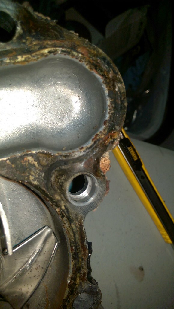

I looked at all the old parts, and definitely the weak part looks like the water pump. There was a slow coolant leak that I couldn't find, and the coolant looks like it was pushing out through the gasket.
Mine was the same way, and it seems to be pretty common. The gasket around the pump is pretty small.
You can see in this pic where the gasket had started to fail. Mine had 200k on it when I replaced everything, and as far as I can tell it hadn't been changed since the 80k mile service.
