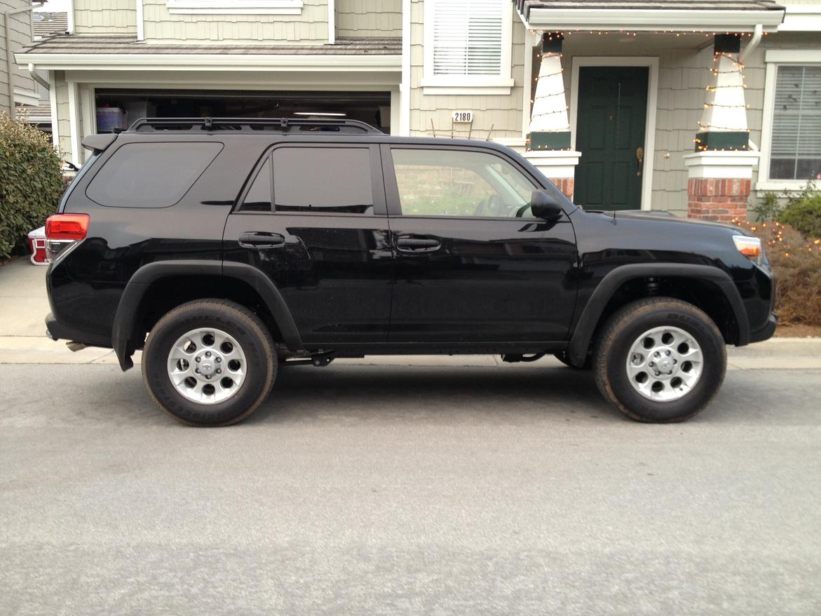

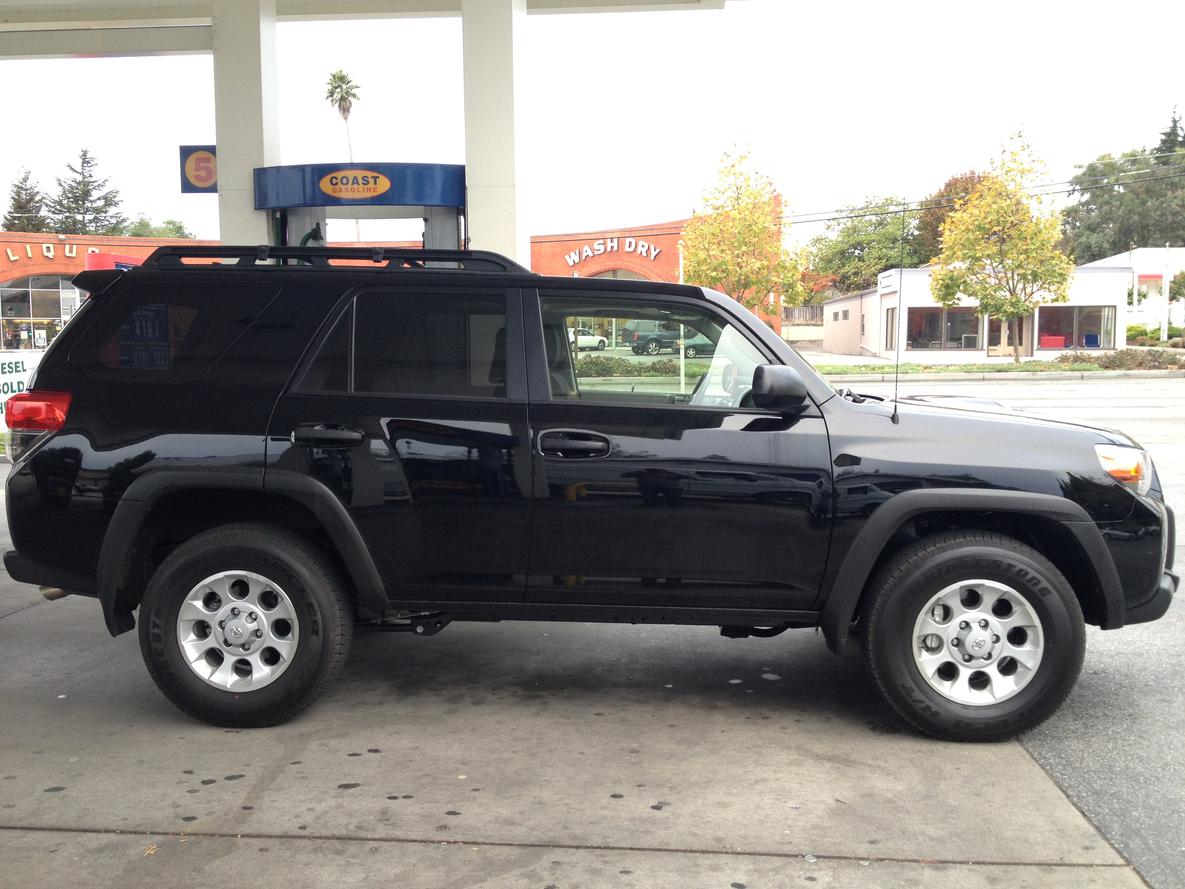

I was pretty much in the same position. My wife hijacked the 4Runner for daily use the second it came home. She let me add sliders, wheels, and duratracs. She really didn't want a lift but we both hated the nose dive under hard braking and the "soft" front end.
I ended up getting the Toytec coilovers (bilstein 5100 based) in the front and rear 5100's with stock springs in the rear. I set the coilovers to their minimum setting and it leveled the 4runner. Huge difference on the road. The vehicle drives and handles so much better. I know Icon's are the premier brand for suspension as far as everyone on the forum is concerned, but you may want to consider the Bilstein based kits as they are less expensive and still a huge improvement.
If you look at the 2 pics you will see one with stock height and the next with the coilovers at the min height. The vehicle only really started to feel taller after adding the 285 duratracs. I'm pleased with this set up for now. Hopefully it won't be too many more months until i'm able to convince the wifey to let me lift it properly. :)
