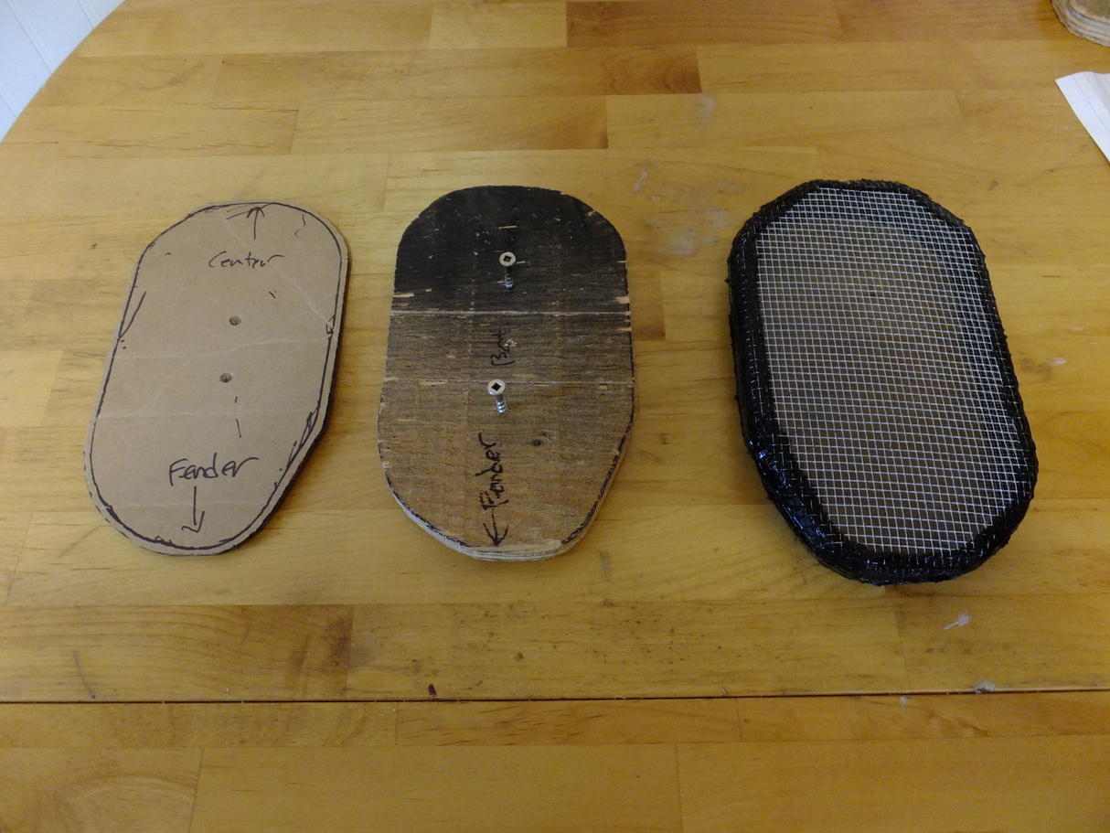

After 2x having mice get into the heater fan assembly, I finally got around to doing something about it.
1/8 in. galvanized mesh with fibreglass window screen under layer. Fits right over the air inlet port in the dash. Is't not the prettiest thing but it will never be seen again once it is put into place. Why didn't Toyota do this??
Surprisingly, it was easier to get the template than I expected. I worked upside down from below.

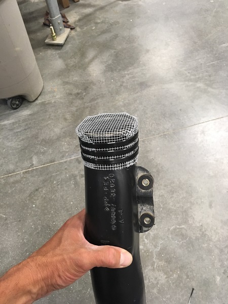

I had always worried about mice/rats in the airbox. I have occasionally found a poo in there. I had visions of a chewed air filter and me not noticing it for months. Decided to do something about it.
I pulled the front 3/4 of the plastic fender liner (easier than I expected) leaving it attached by the door. I took out the air snorkel. As expected, it was dusty inside as I am sure they all are. As expected, there were mouse tracks in the dust on the bottom.
A scrap of 1/8 welded mesh wire and 3 large tie wraps should do it! There is enough clearance that the mesh does not touch the body at all.
I was worried about air flow, but after reading about jziggy using a prefilter I decided this is not an issue. I wonder if it'll whistle at high air volume but I doubt it.

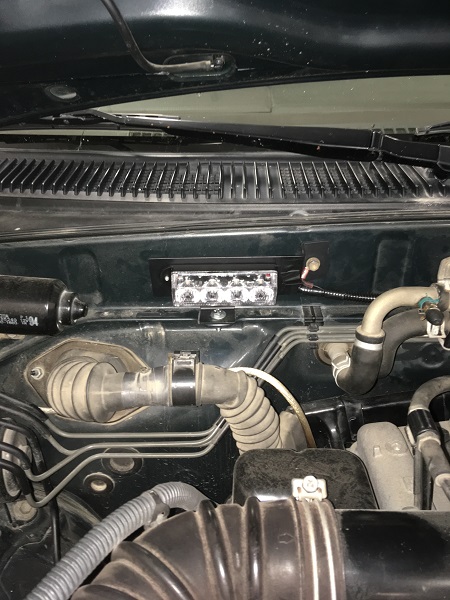

This one takes inspiration from RV'ers in Arizona. They use christmas lights around the RV on the ground or even flood lights underneath to keep the packrats away. As well, there is a product made in Arizona using a strobe to keep the rats out. Park rangers in Mojave leave their hoods propped up for the same reason I assume.
As we have camped in the 4runner for 6-8 months at a stretch on 3 separate occasions , I have had ample opportunity to experiment. I have been using a portable LED panel that I stick under the hood and connect to the battery. It works. Without it, critters come. With it on, almost never. The hooking/unhooking gets old though.

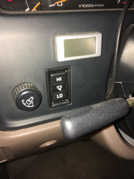

Hence, a permanent strobe light. Switched with a rear heater blower switch in the factory switch position in the dash. Low is for strobe and high is for fully on, as in under hood work light! The light draws 220ma which is quite a lot, but its duty cycle is 1/3 on and 2/3 off so it should be fine for a night or two. My old LED panel drew 125ma constantly and it was no issue to run it for 2 nights in a row.
Can't wait to try it out! Surprisingly, at night you really can't tell it is on. It illuminates the wheel well a bit and the ground a little bit but nothing obvious.

Well, mine are Xprite LED strobes available from amazon. They are a little larger than I expected but OK. They get good reviews. I bought a red one also and installed that one as a second brake light on my little street bike. It has held up for a 10 day trip which was very wet and rainy. Time will tell how it lasts in the truck running 8 hours a night. Since it is on a bracket it will be a simple matter to swap it out if needed.
Well, here we are camping in the desert. Mixed success with the strobe. It works great, doesn't noticeably affect the battery. On the mouse front, mixed results.
First to state an interesting observation. We only have rodent issues when camping in existing campsites. If we stay in a random unused site in the desert or forest, no issues. I'm guessing this is learned behaviour for the rodents much like the bears in Yosemite.
Generally we will hear a scrambling in the engine bay sometime shortly after dark. They seem to like the warm engine block and who can blame them, 20 degrees f at night. Most nights flicking in the strobe sends them packing but not always. Last night one went everywhere (from the tracks on the dust). They don't seem to hurt anything but the sound drives me nuts when trying to sleep.
