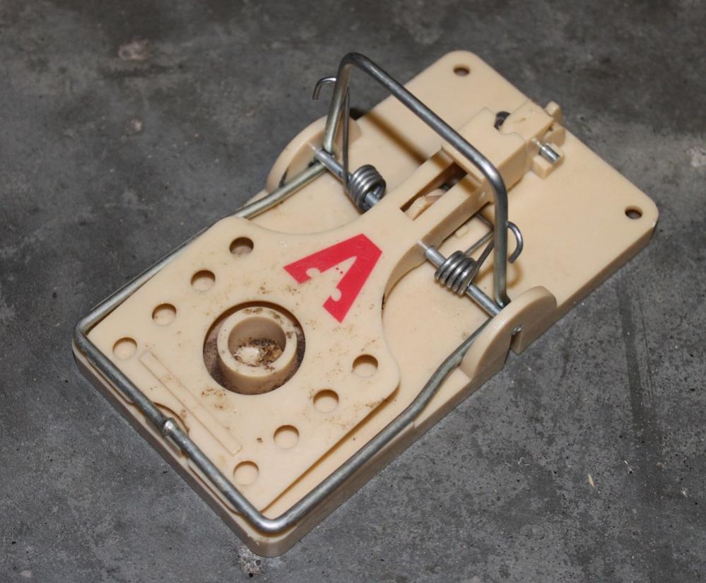

The new plastic Victor mouse and rat traps work very good, redesign with a 'cup' and large trip pad/trigger... with peanut butter.

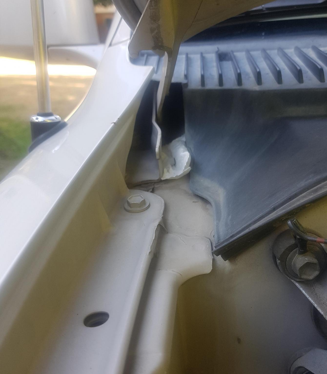

That whole channel under the cowl where the wiper mechanism lives is open right across the vehicle and it is open on both ends (inside the fenders). I think that's where they get in, near the hood hinge is where I've seen them duck in.
Yes, this. It is where water drains out that comes in through those visible vents in the cowl panel.
-Charlie
I think mice can squeeze in near the hood hinge and fender, I think if they can get in there then they can get down to that open vent, strange toyota doesn't put a large grate across those vent holes.
Ok copy all that . I'm going to tackle all this first thing in the morning , it was so hot out there when I got home you could bbq a steak on my hood .
Thats where I saw this guy duck into the day before , he went down in that opening where the hood hinge is . Report back later , thanks for all the direction .

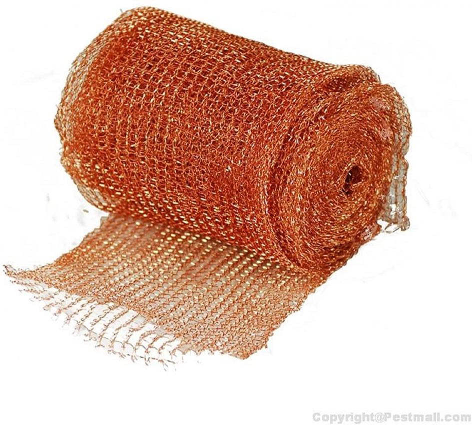

This is where my lil dude was going in and out of , the hinge area . I wonder if just packing that area with that mouse meshing on both sides would do the trick ?

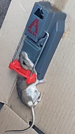

This is the one i was talking about... rat trap.
The trigger part is to complicated though and fails eventually.
The pan is a good design as it makes the rodet stand on it to get down into the bait/cup/peanutbutter.
Have gone back to the old school wood Victor rat traps, mice wont hardly set them off but gets these BIG packrats we have in central Oregon.
