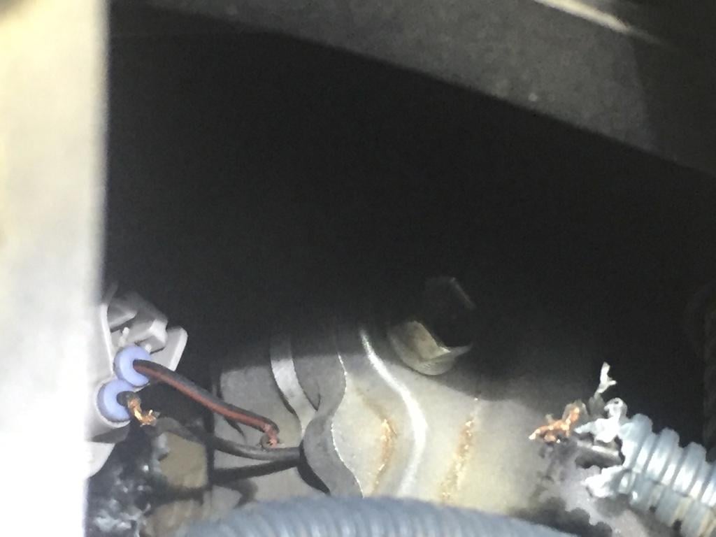

Great solutions and very thorough. My wife’s 5th sleeps outside and one morning it had a horrific misfire.
Investigation located some damage to an injector wire pigtail
Luckily Toyota is awesome and I had some spare pins with wires from my 95 scrap parts bin. Pins and wires were the same size 20+ year later. I was able to replace pins and reconnect the wires.
