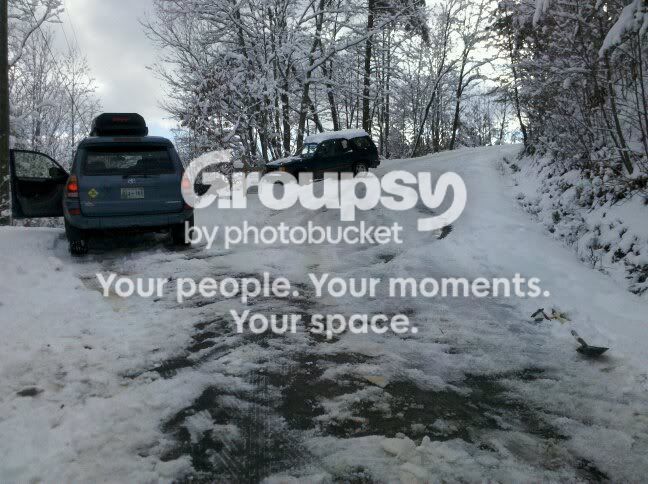

Here's a picture of the carnage:
100_2360.jpg~original
Note the tire skid marks in the foreground of the picture are from the tow truck sliding around when they turned around.

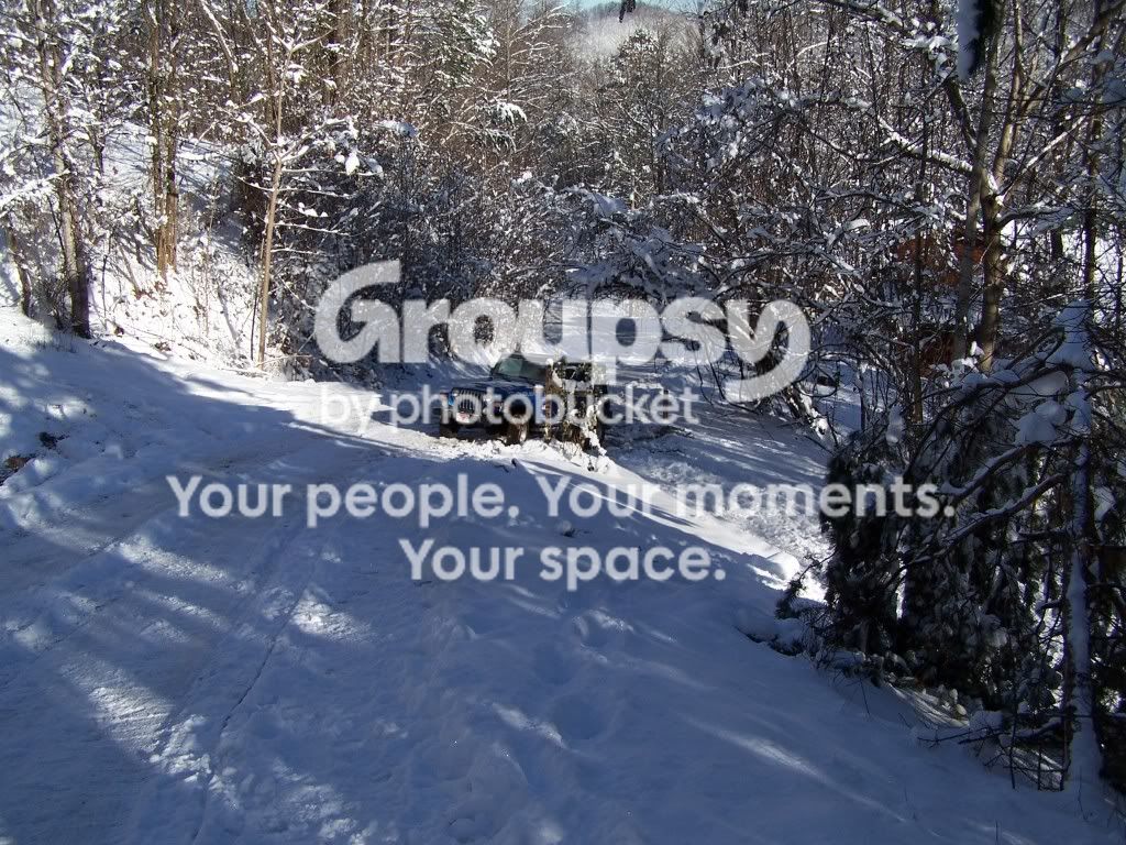

More views of the fun:
SteepestSnowCoveredHillEver.jpg~original
I was able to stay on the road once I started sliding. When I came to a stop, I was perpendicular to the road. I busted up the ice and pulled into the driveway pictured.
Luckily I was out of the road, when this the Explorer started sliding.
You can also see, the ditch on the right side of the picture looks kind of chewed up. That's the ditch the tow truck ended up in (they didn't chain up either). The tow truck driver managed to back the truck down the ditch by riding the edge and taking out and using the saplings lining the ditch for traction. At the bottom of the hill, he changed his underwear and took a smoke break before declaring that anyone stuck on that hill was just going to have to be there for awhile.

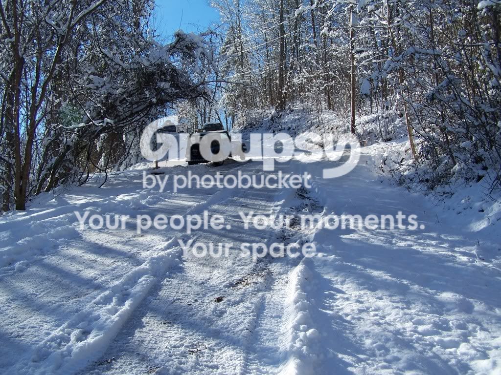

Looking down from about 1/2 up:
100_2357.jpg~original
