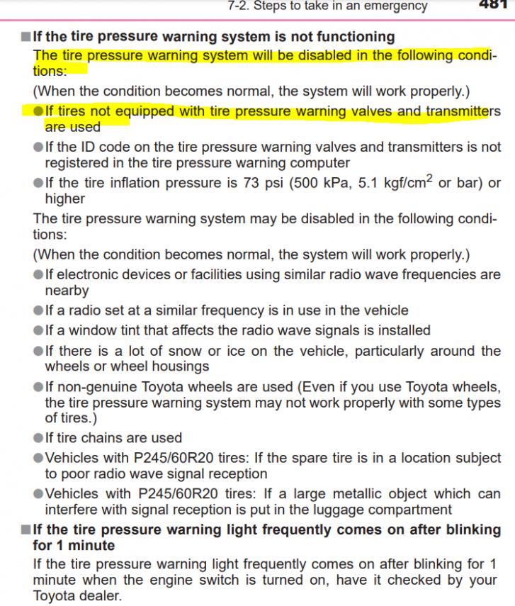

Update, we drove for a couple hours and no light has ever come on. It does come on during start up but disappears with the rest of the lights on the dash after a couple seconds. I'm pretty sure Toyota programmed it this way, sensing if all 4 sensors are missing or out of range, it disables the system completely. It's a great thing for them to do that!
page 481 of the canadian owner's manual. programmed this way. must be a new feature? I mean I have a 2012 so everything seems new to me now lol. the fact the light does come on at startup also shows the system is ready to operate vs simply not functioning at all
Thanks for sharing that, didn't even think to check the manual lol :frusty:
