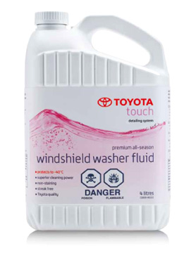

I use this Toyota windshield wiper fluid year round - just to avoid the issue you mention. Good to minus 40 Celcius.
This stuff works! It was in low minus 30 Celcius here this past week (low minus 40 Celcius with the wind chill).
I have never seen that stocked at our dealership...
Is that PINK washer fluid?! Because no one would ever confuse the PINK Washer Fluid with SLLC PINK Coolant? LoL
