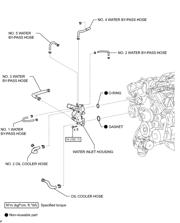

That’s bad news about the rear “L” bracket. I saw a guy on YouTube who jacked up the left front body (not the frame) to get to this bracket. Apparently, someone at Toyota didn’t check for access and glossed over it by simply stating in the FSM, “Remove rear bracket bolt to engine block.”
“Tensioner is surprisingly okay. I'd taken the bearing out and cleaned and repacked.” We’re on the same page … I’ve done that once or twice on other vehicles.
“… the belt very specifically snapped into the clamp on that hose, knocking the hose off and draining all the coolant out while on the interstate … (I’m) praying the time it took me to pull over on the interstate didn't warp the head or blow the head gasket.” I had to look at my T4R to see how that could happen. I think the tensioner played "snap the whip" with strands of your serpentine belt. I looked up the parts in this area. There are five (5) coolant bypass hoses and two (2) oil cooler hoses!!! I suggest using a small mirror to inspect the underside of these hoses for damage that might lead to a burst hose later. I'm guessing the No. 3 water bypass hose was knocked off. The oil cooler hose appears to be adjacent to the bypass hose ...

Everything is okay so far. Still no oil or coolant issues. Might've dodged a very expensive bullet.
The fsm just says "remove bracket" lol. Wish I'd seen that video
