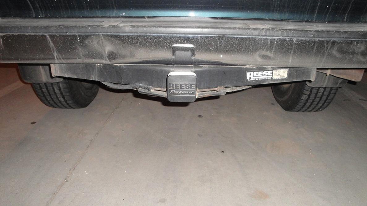

I have a Reese on my 97. It was dealer installed when I bought it new. Looks like it's just bolted to the frame. I don't tow much weight...just an 18' Hobie Cat and an occasional U-Haul trailer. It's solid as a rock and caused two cars to be towed for rear-ending me. The only damage to my bumper are the small dents you see in this picture (excuse to upgrade my bumper I suppose). But back to the subject, I also like the profile of the Reese tucking under the bumper around the spare tire toward the outsides.
