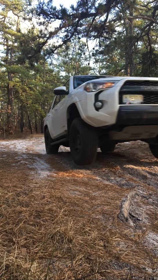

Last Thursday I finally got around to installing the Toytec Lifts' Ultimate FJ Cruiser/TRD Pro 4Runner 2" lift. The lift tested my patience haha. I'm so use to both spacers going on the top of the strut and the kit wasn't fitting. Luckily I have Scott over at Toytec on speed dial and was able to get ahold of him for help. I forgot I could have looked at the TRD Pro lift question thread; I guess I was just in panic mode haha. The larger spacer goes at the bottom and the smaller spacer goes at the top (see photos). The lift definitely looks bigger than 2" (see comparison photo). I'm measuring 37" from the ground to the middle of the front fender flare and 39" from the ground to the middle of the rear fender flare. I still have the 265s on there for now until my tax return hits my checking account.
Those are about the same numbers I got for the Toytec lift and I even opted for the SAW 1 and 1/2" rear springs instead of the Toytec 2" super flex. The spring rates were different (12% for SAW and 10% for Toytec) so that may be why I am still getting 2" lift for the rear.

Today I went and picked up the new hardware to fix the rear lower trailing arm bolt. While I was at the dealer I saw another 4Runner and decided to get a side by side shot of the SR5 and my TRDPro with the 2" lift and stock 265s. Definitely a difference but not too much. You can totally tell if you look at the fender gap between the top of the tire and the bottom of the fender.
Just a heads up man, sure you already know the deal with the FJ and stuff. When installing all my suspension and rear links and rear UCAs I was shocked at how loose everything was from the factory, especially the bottom shock bolts front and back. I retightened and used lock tight on all the moving parts. Glad no damage happened!
