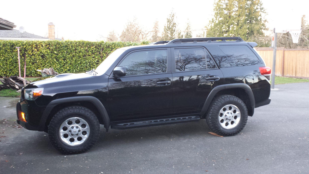

Camera phone pic from the first day:

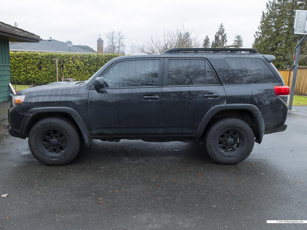

PRE and POST lift pics
Measurements: [center of hub to underside of fenderwell trim]
Before
fronts: 19 1/4"
rears: 21"
After
fronts: 22 1/4"
rears: 23 3/4"

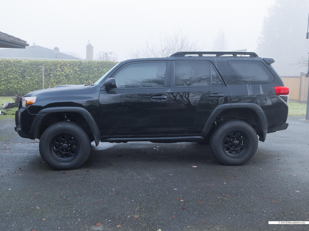

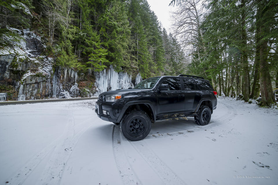

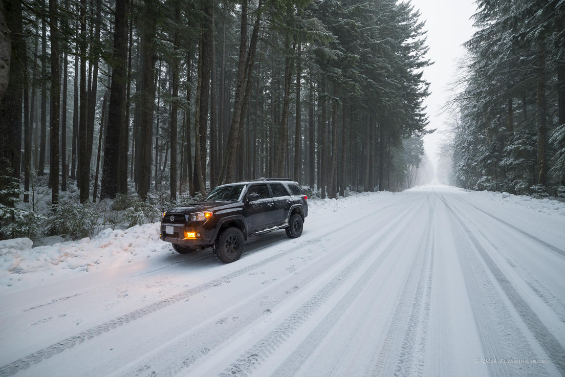

Couple snow pics from Mountain Loop Hwy
