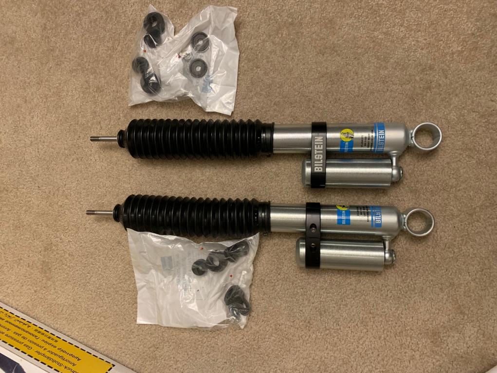

I got these 5160 rears installed a few months back. I bought from Wheeler's Offroad (one of the board sponsors).
