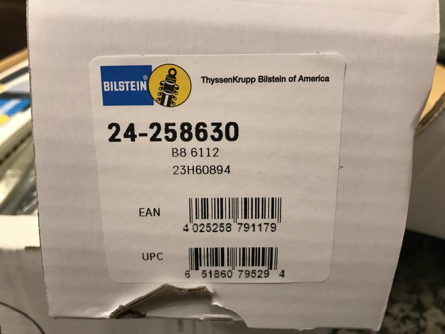

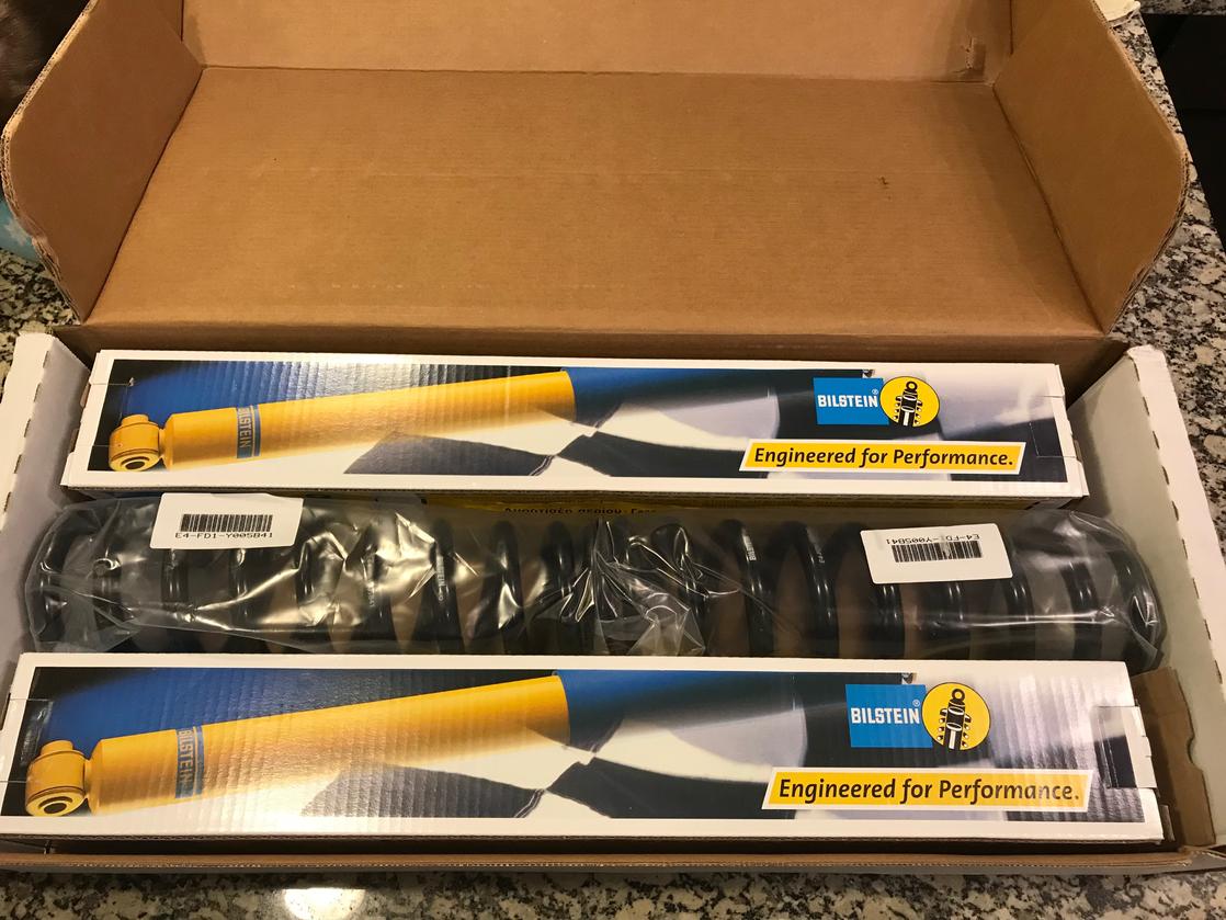

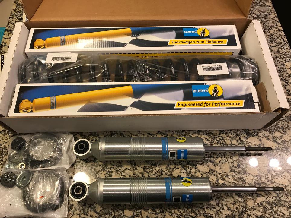

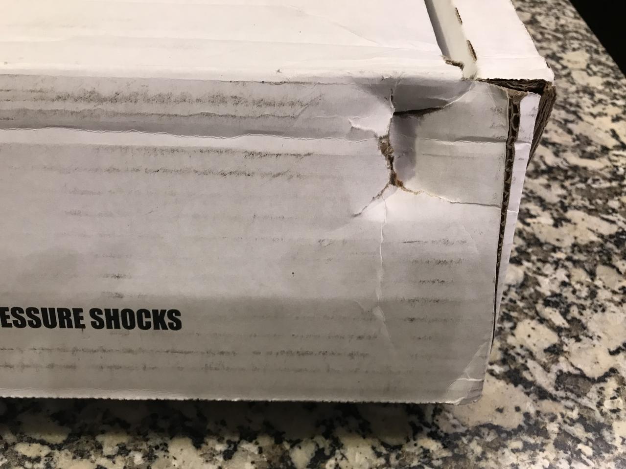

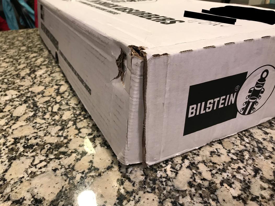

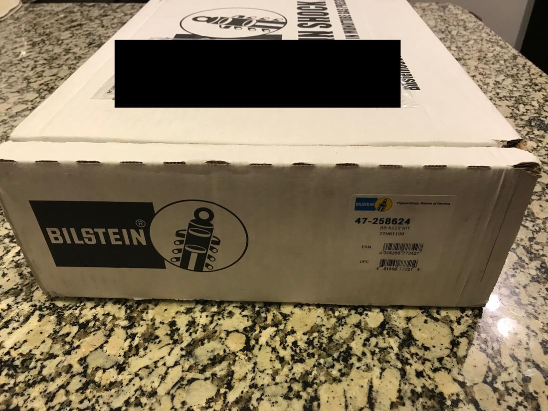

Received these this afternoon!!
I'm sort of disappointed in the packaging. A little more care could have been taken on MRT's part to secure the contents. No tape on the package at all. FEDEX didn't want to leave it on my doorstep in fear that someone would open it up and take off with the contents so they left it at my leasing office. Everything is there just a little bit of tape would have made all the difference between me having it left on my doorstep or having to skip out of work early to go pick it up from my leasing office.
Another nice touch would've been to put the Bilstein branded box inside another unlabeled box so that passers by wouldn't see the Bilstein brand all over the box and know the contents. Wouldn't be very hard to snap a pic of the part number on the side and know exactly what you have there. Again, just a side note.
Pics (Exactly how package was received)

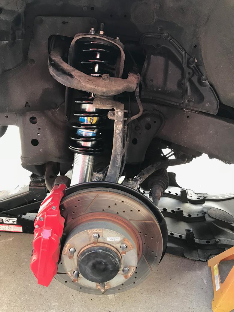

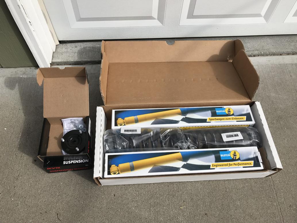

Finally got the time to install my set of 6112's. Went in pretty easily.

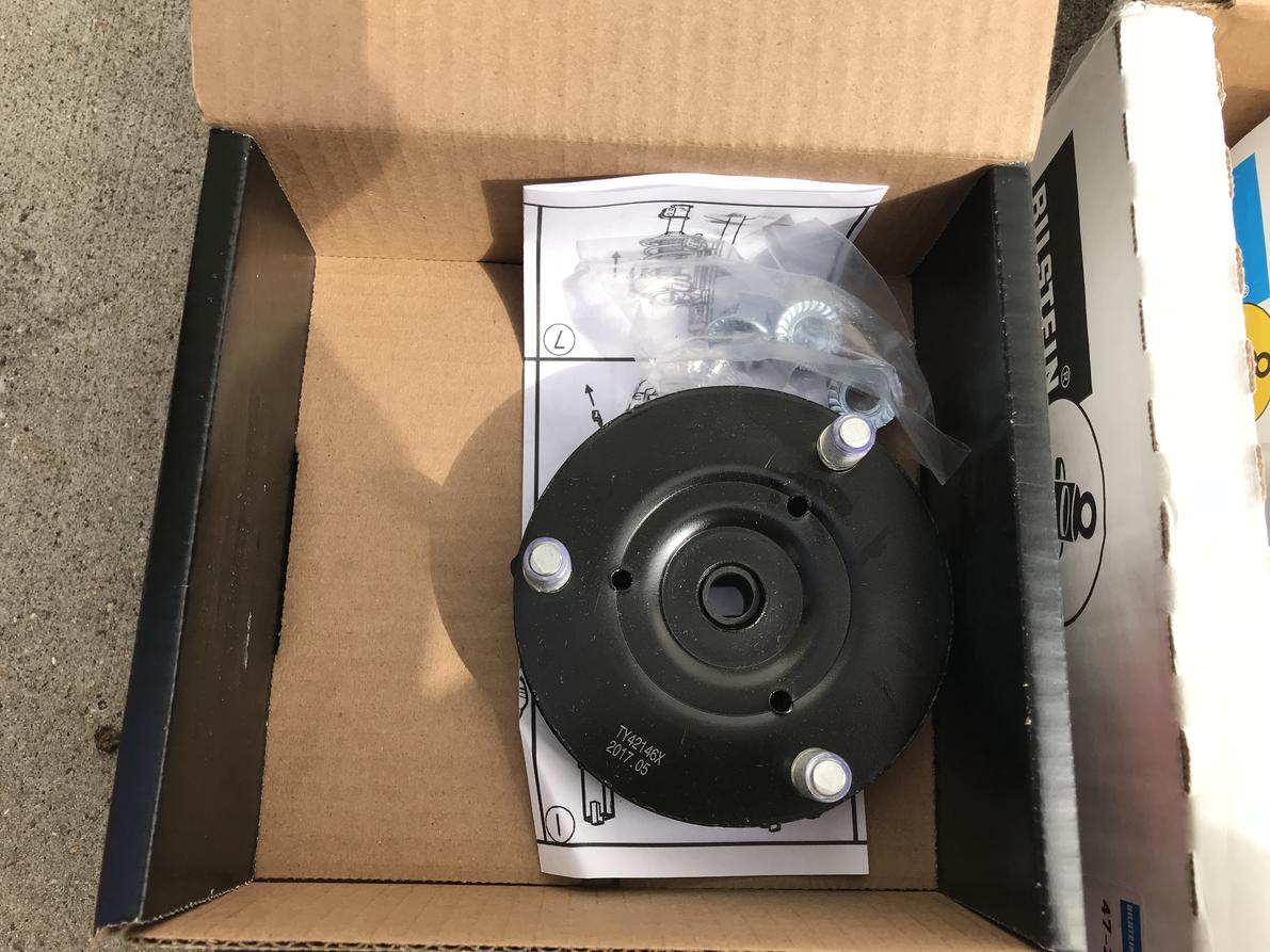

My spread of parts. Bilstein 6112 kit from MRT and KYB strut mounts.
KYB strut mounts (if anyone is curious the KYB mounts do come with new nuts. All the images I saw of them do not show the nuts being included.)

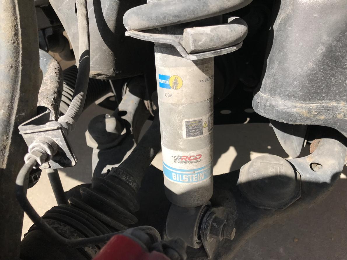

Current 5100's Installed

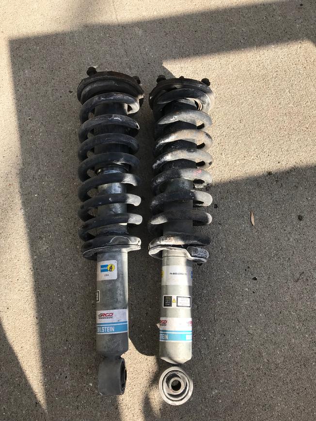

A look at the 5100's I'm replacing. These are the RCD 5100's for the 4runner.

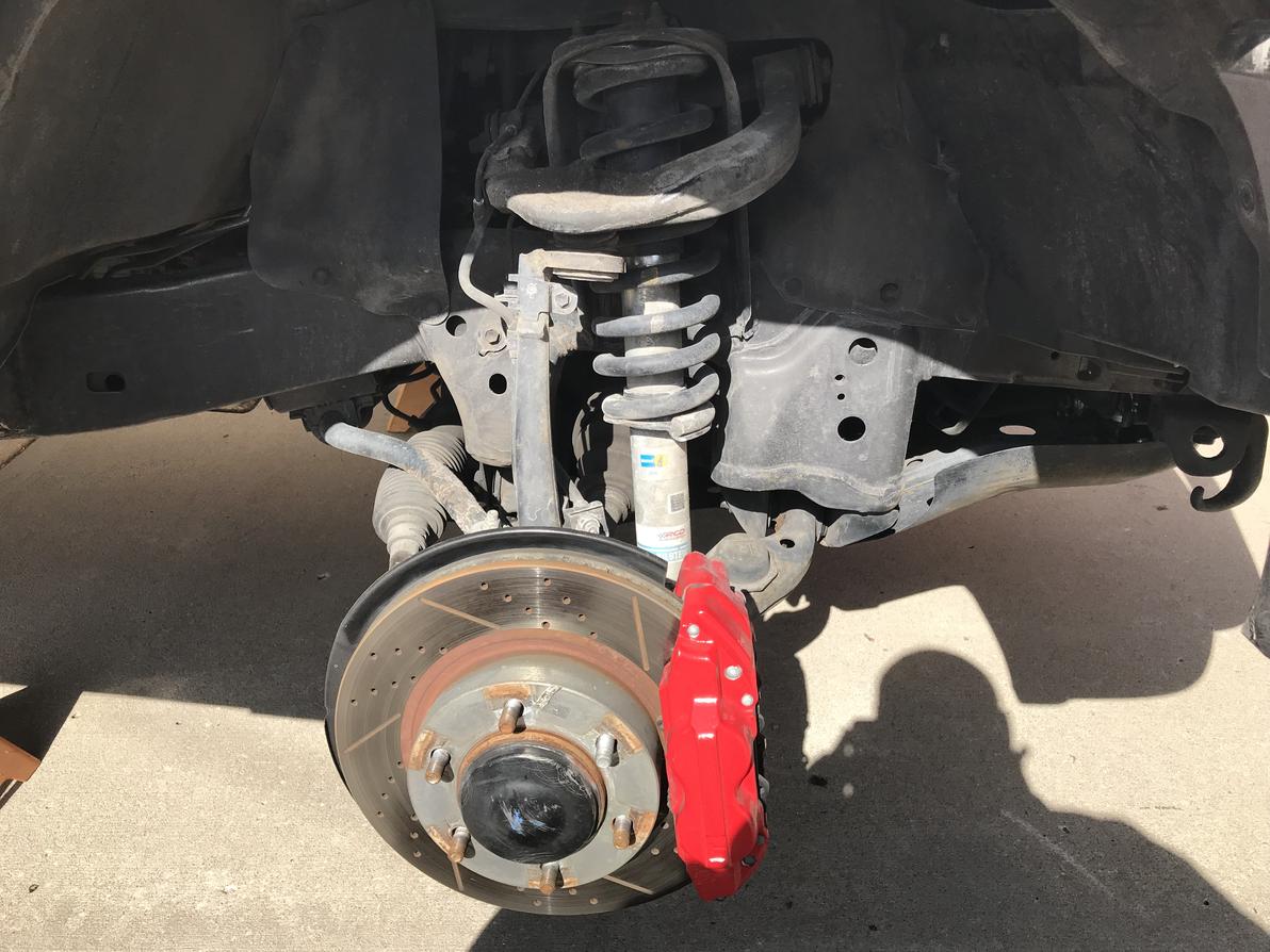

5100 on the passenger side removed.

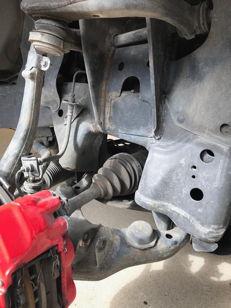

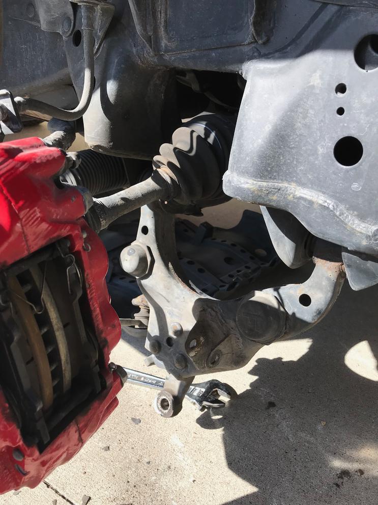

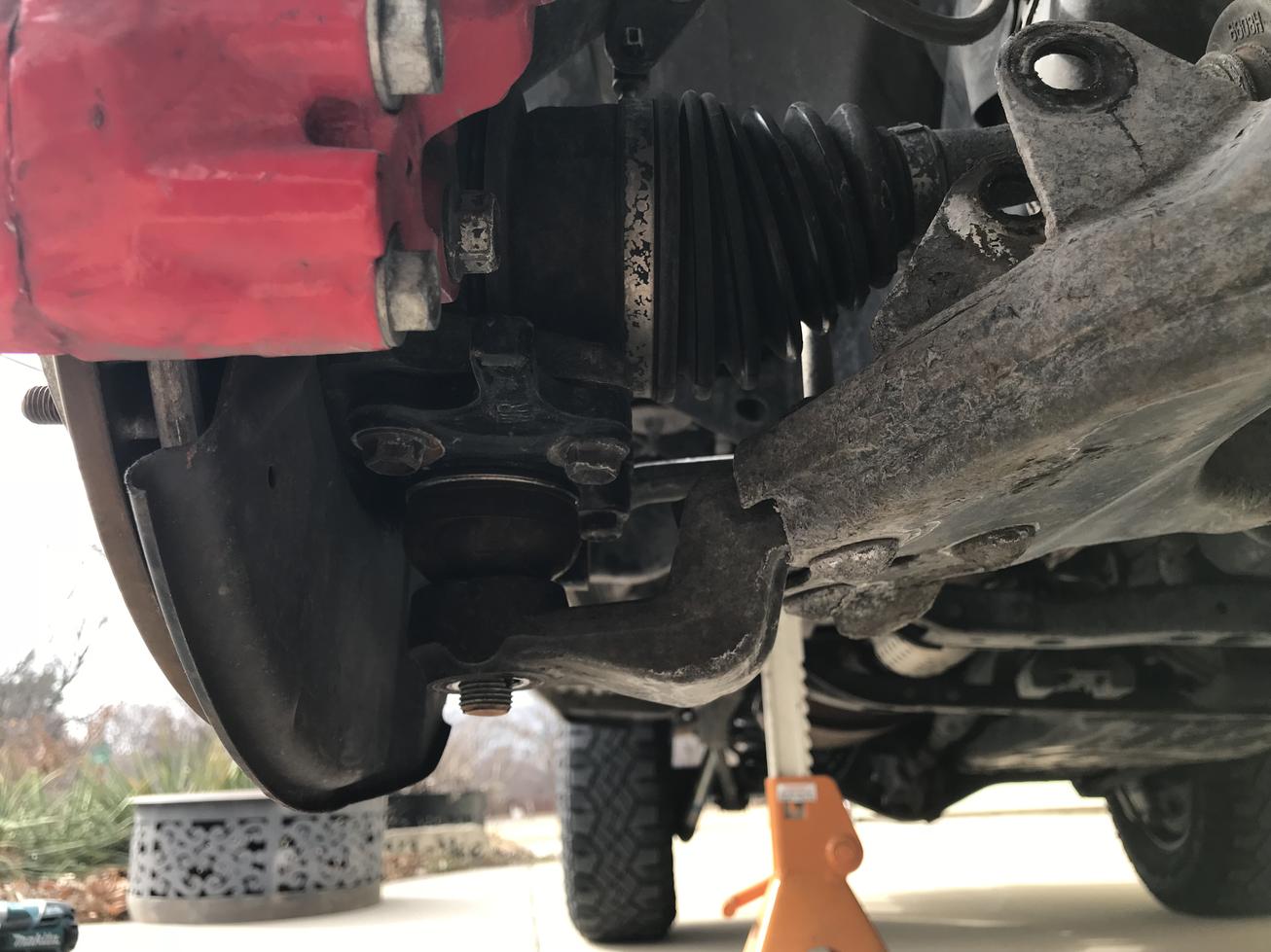

I'm doing this without a spring compressor. I removed the lower balljoint nut and separated it from the lower control arm.

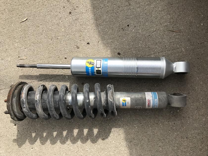

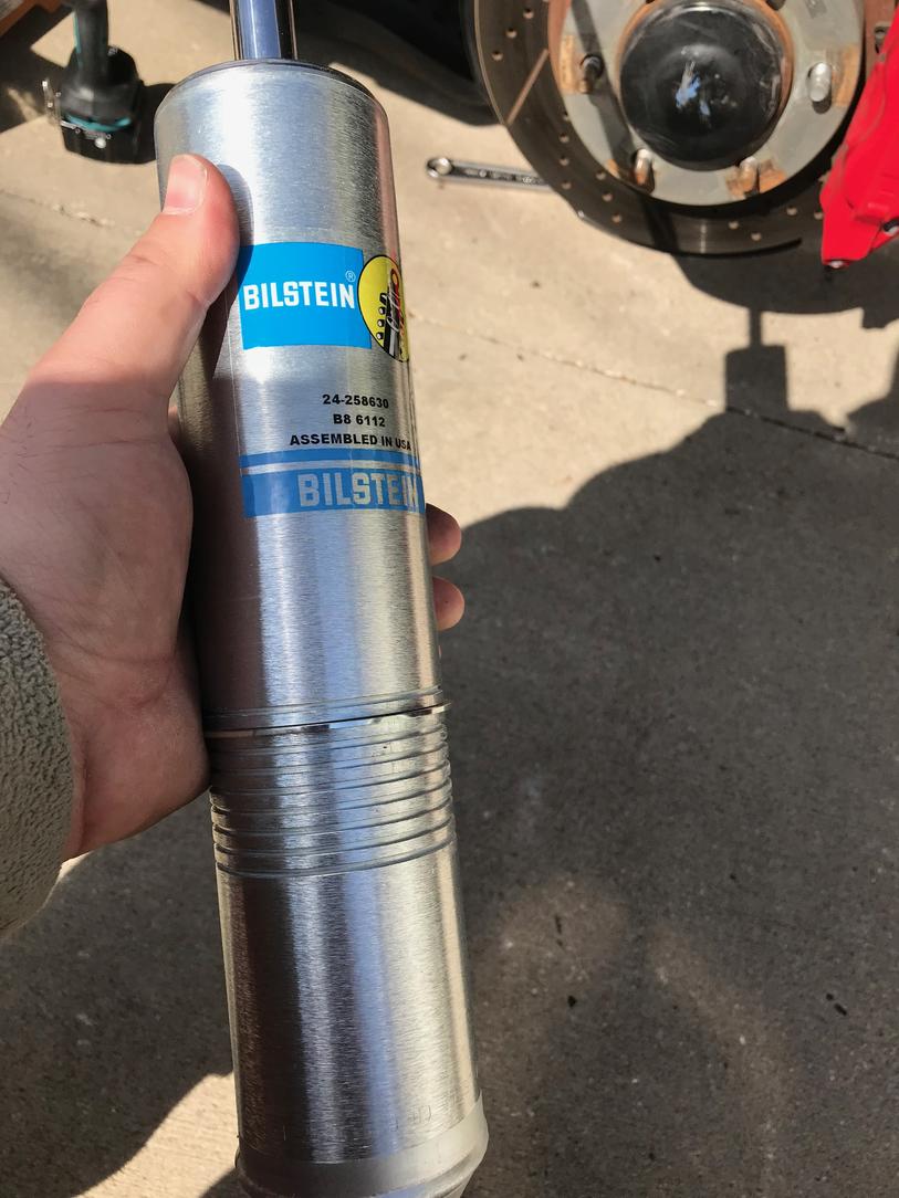

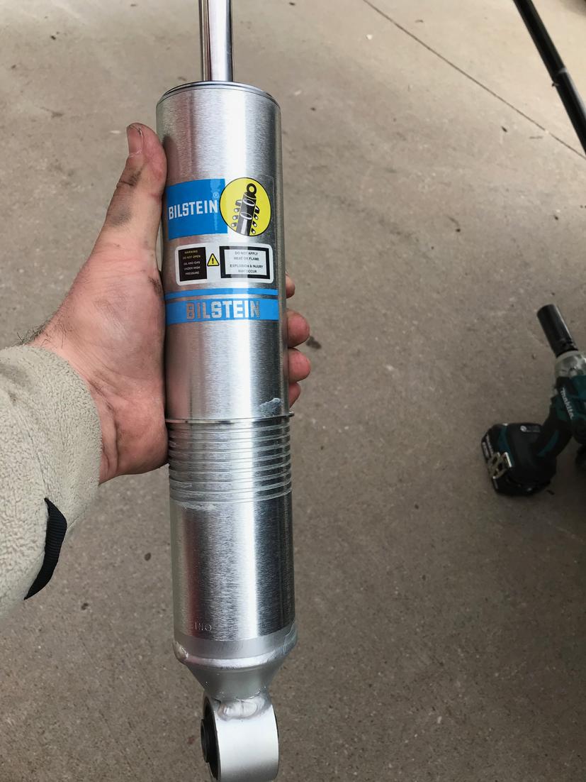

Comparison of 5100 to 6112
This is passenger's side so it gets clip position 8.

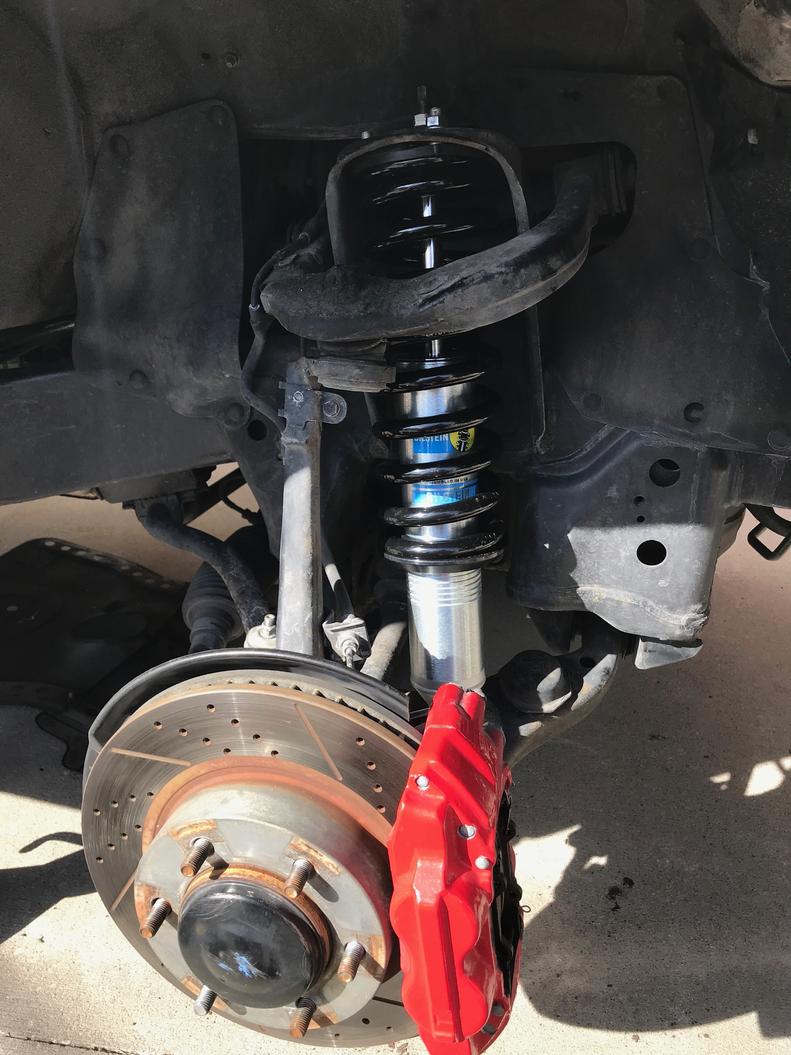

Marked and loosened the lower control arm adjusting cam bolts and swung the arm down and out of the way.

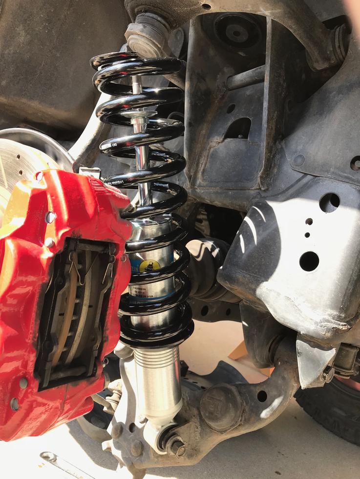

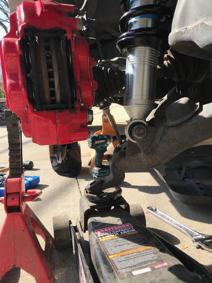

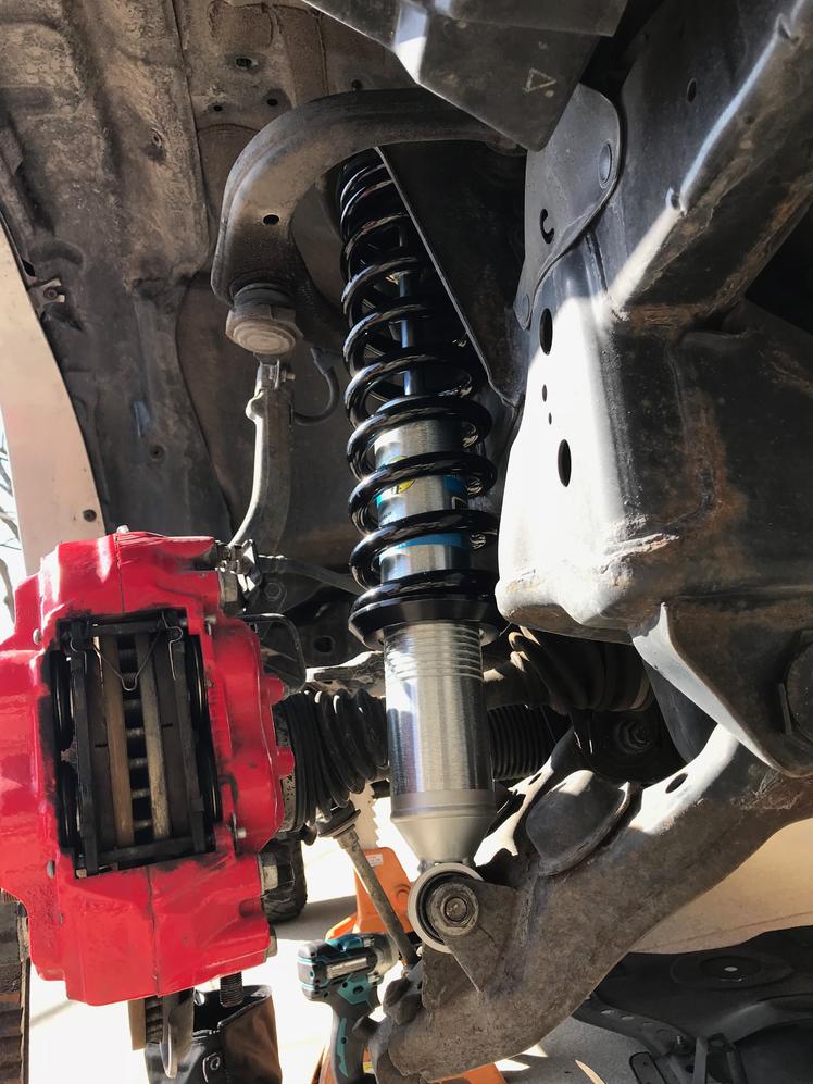

Placed the shock assembly in place and slid the lower bolt in to hold it in place.
Aligned the bushing and the shock rod
Getting everything aligned and ready to use floor jack to compress spring.

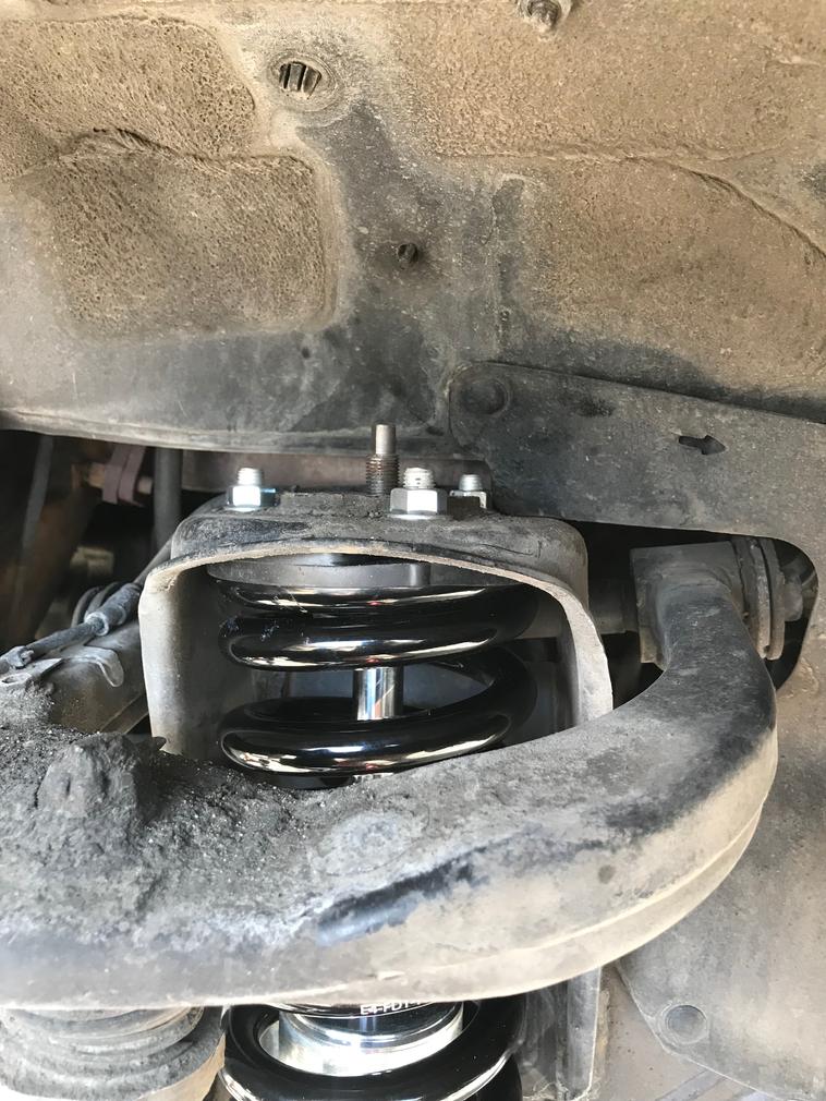

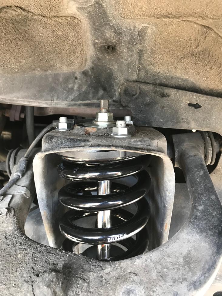

Use floor jack to apply pressure to lower control arm raising the shock rod through the strut mount.

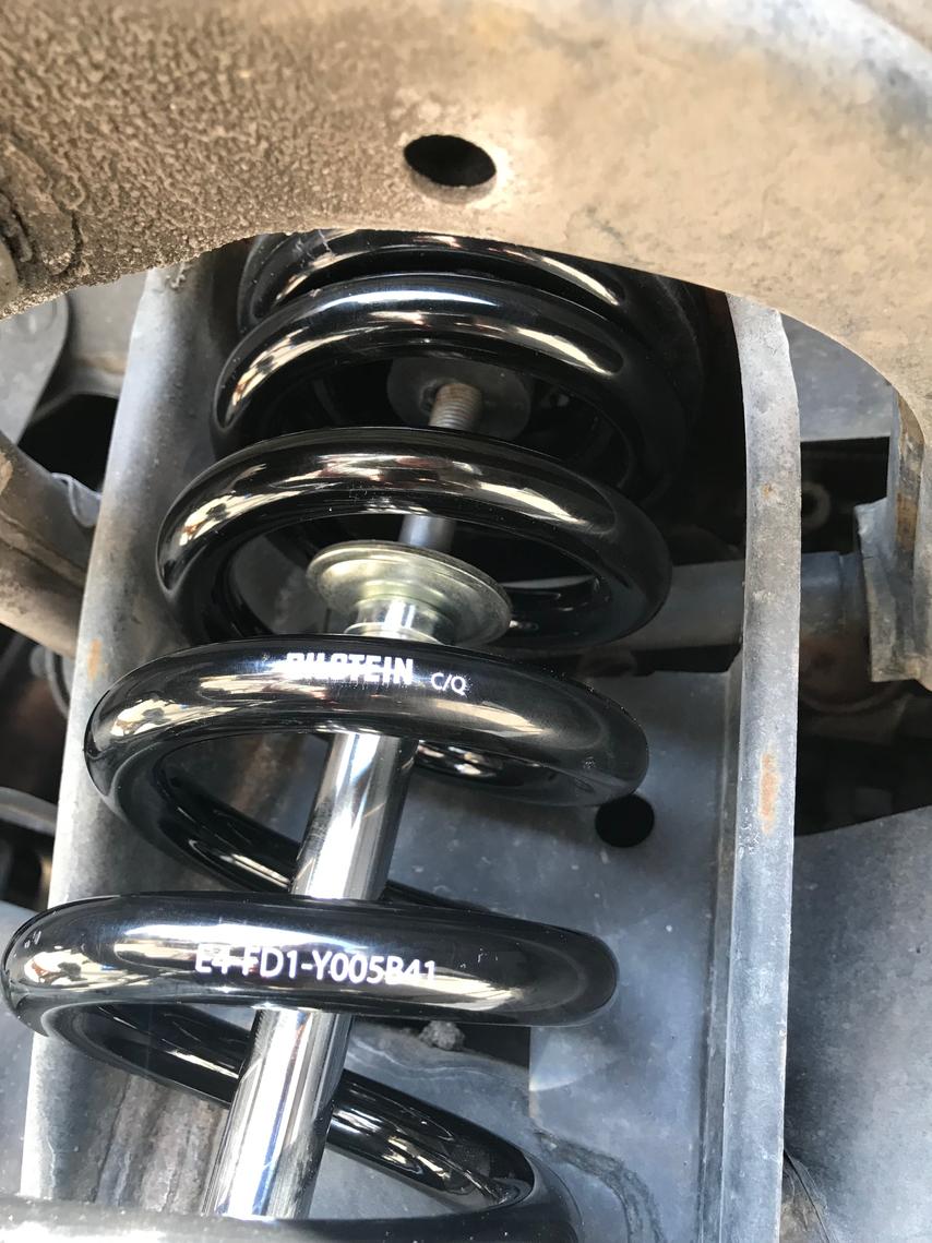

Shock rod will raise through the strut mount and you can capture it with the bushing, washer and nut.
Affix the bushing, washer and nut and torque.
Balljoint reassembled, swaybar reconnected. Passenger side is done.

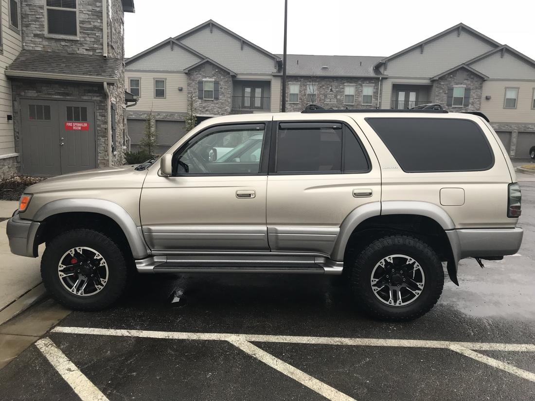

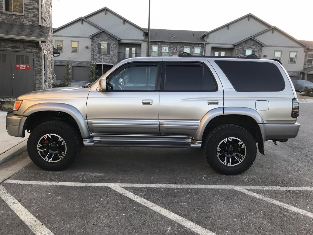

Before:
After:

Measurements before were:
Hub2Fender/Ground2Fender
LF: 21.125" / 34.875"
RF: 21.25" / 35.00"
LR: 22.5" / 36.75"
RR: 23.0" / 37.25"
Measurements after are:
Hub2Fender/Ground2Fender/Lift
LF: 22.75" / 36.50" / +1.625"
RF: 22.75" / 36.50" / +1.5"
LR: 22.5" / 36.75" / Same
RR: 23.0" / 37.25" / Same
I still sit a little low on the driver's side rear. I'm planning at least one trim spacer on the driver's side rear. Maybe two on the driver's side and one on the passenger's side. I don't like the fact that I only have 1/4" of rake on the passenger's side and negative rake on the driver's side. I also have not done an alignment yet. I will remeasure after that is done and reassess what needs to be done.
