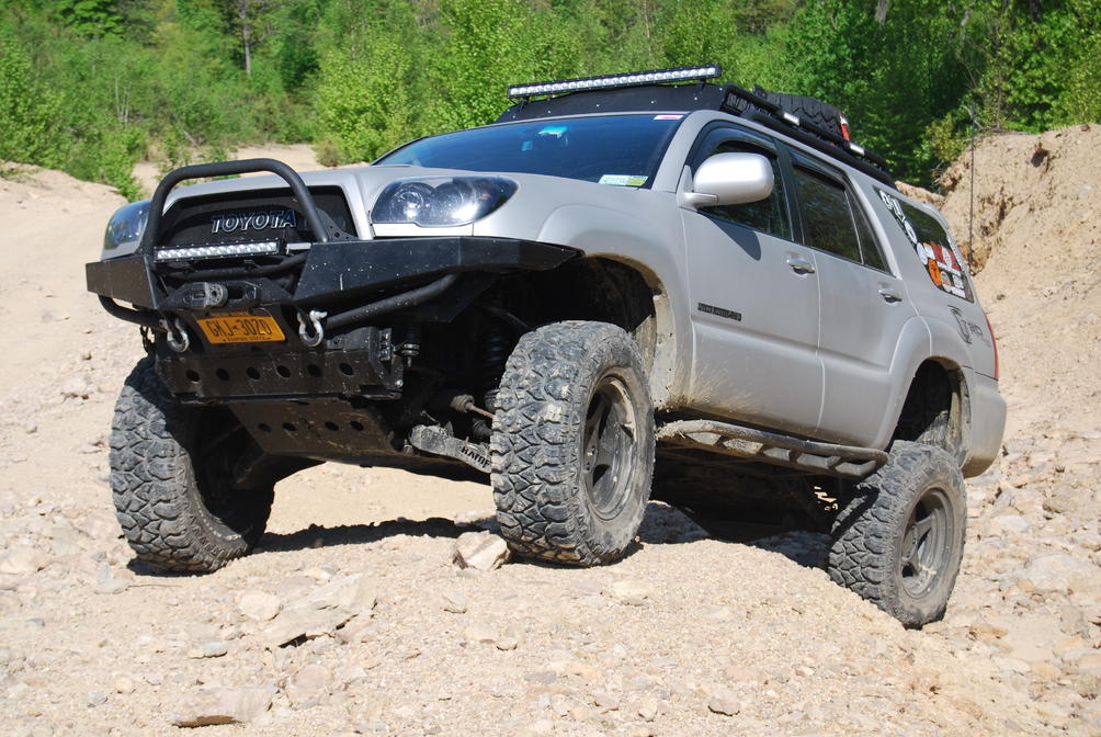

Ok i've decided it's time to start my Build hope you guys enjoy.I picked up my 4Runner back in the beginning of September.My over all goal is kind of a expedition/off road rig but to still be able to use as my daily driver.So far i feel its coming along nicely, plus i'm trying to keep to a reasonable budget right now and i'm trying to pace myself but its very hard lol i've always had the bug when it came to modding my vehicles :loco: but i love it so what are ya gonna do.Sooo here's what its looking like so far....
How it sits now as of 5/16/15

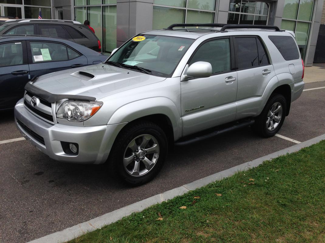

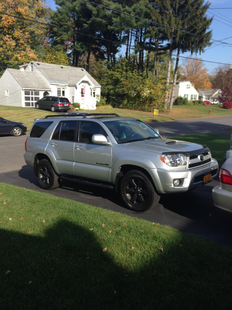

The day i got it from the dealership
The first thing i did was get the front window tined to match, i think it's 30% or 35% didn't want to go too dark NYS troopers love tinted windows in Ny!
Then plasti dipped the wheels and all the emblems, it came out great and have always loved the blacked out look on silver/white vehicles!

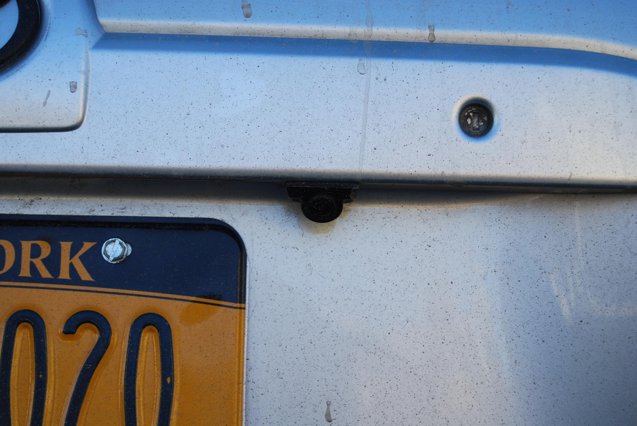

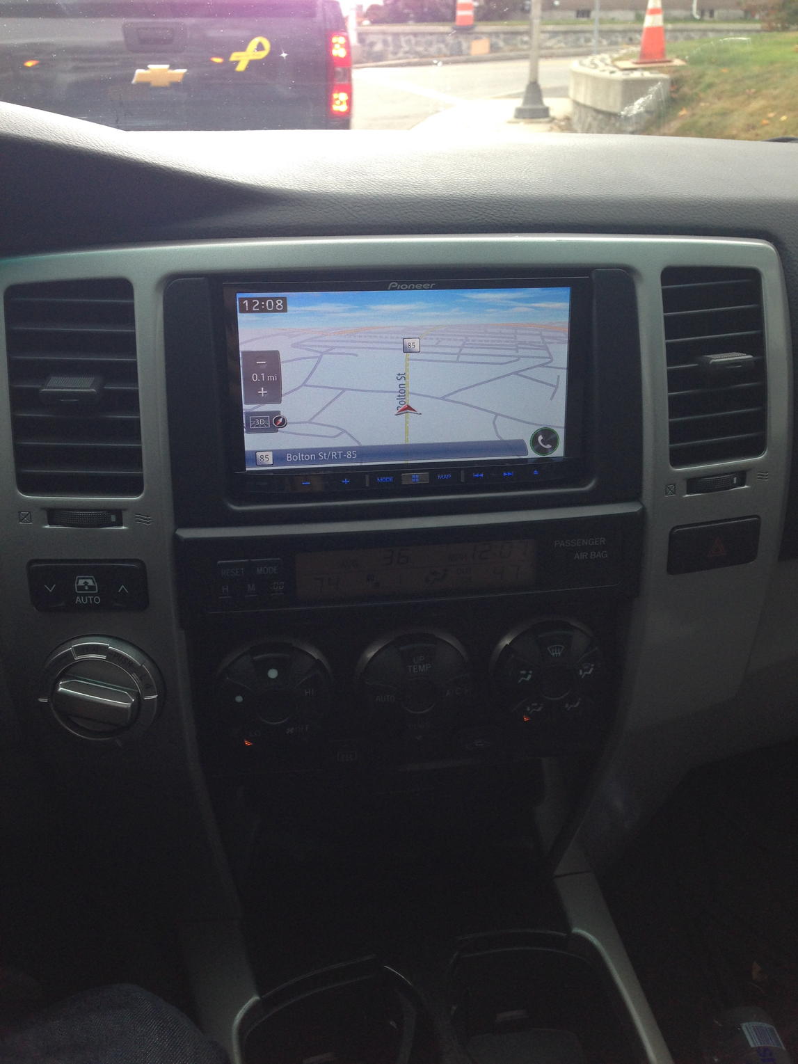

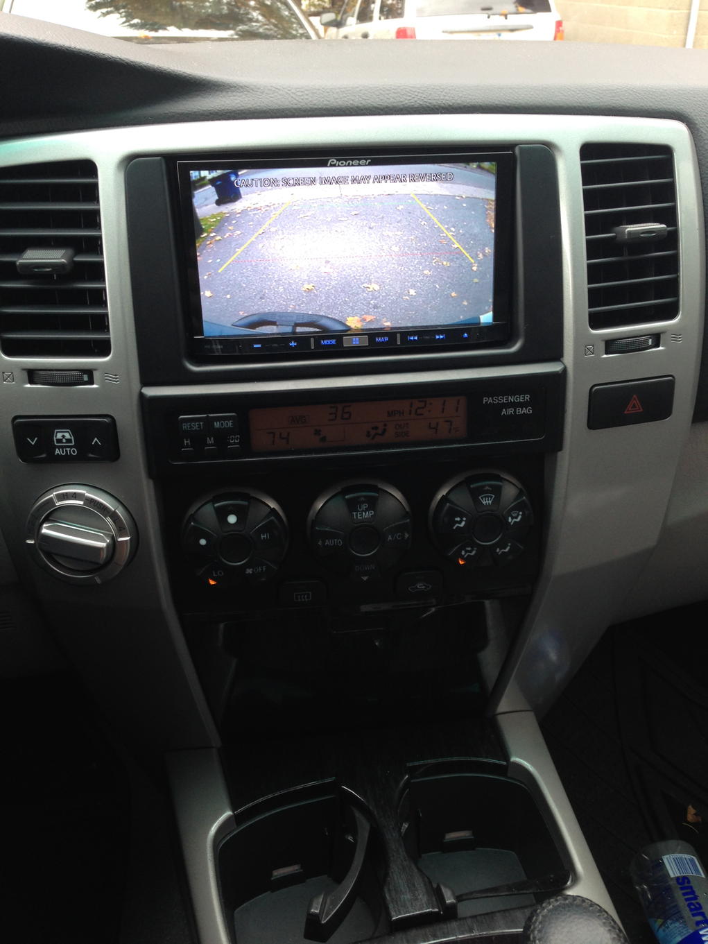

Next came the Pioneer Avic z150bh in dash Navigation Unit+Back up camera+Remote start. I came from a infiniti M35x which had all the bells and whistles so i wanted to retain some of that in the 4runner. Pioneer unit has been great love the Nav and the touch screen, back up camera is a blessing in NYC and the remote start well because it gets pretty cold in the winter in NY so its nice to have!

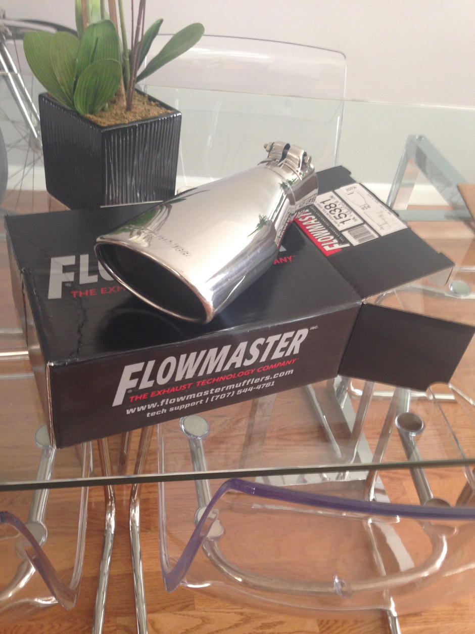

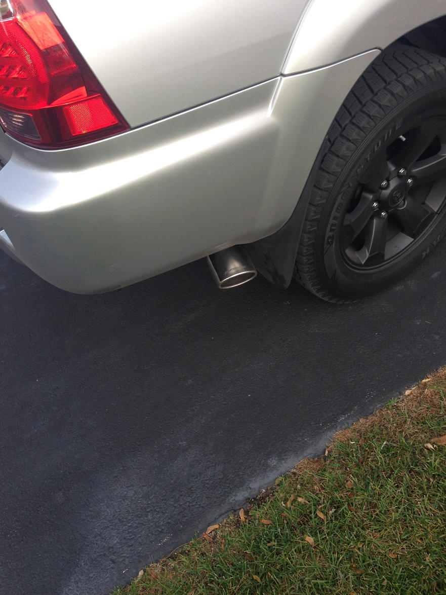

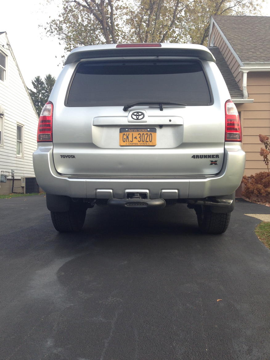

Exhaust , i ended up going with the Magna Flow suv muffler. After researching a lot of different mufflers the reason i went with this was because it has a nice deep tone for a v6 but not too loud and droned out on the highway. Here's a pic of the tip and how i had it routed out the side behind rear passenger side tire.

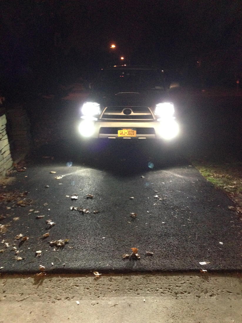

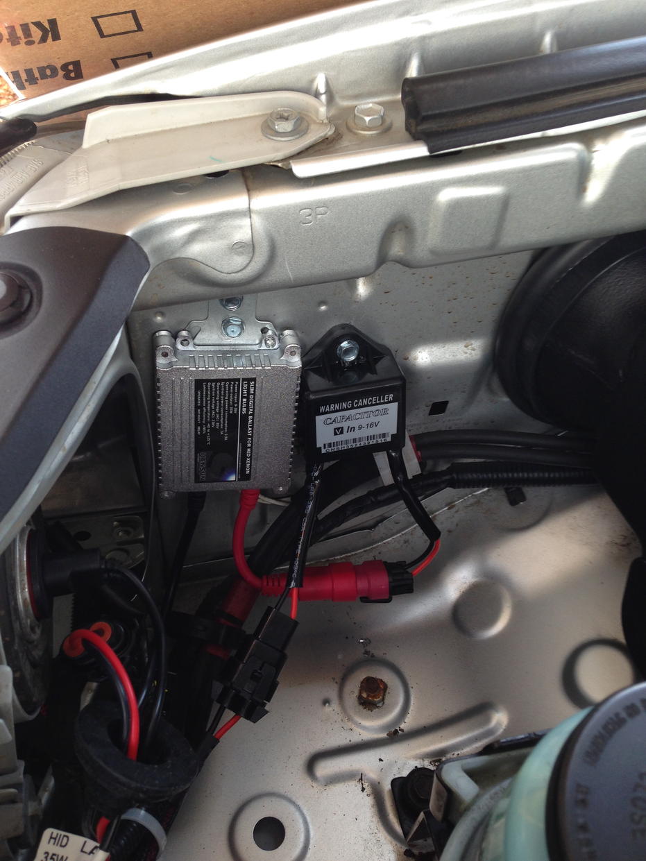

Hid's 6K heads 6K fogs Quick cell phone pic cause it was late when we finished and how i mounted the ballast's.

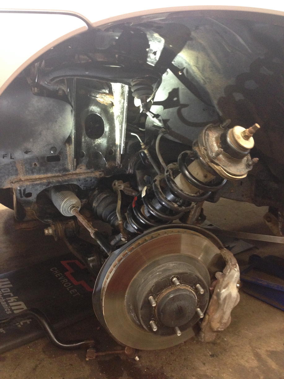

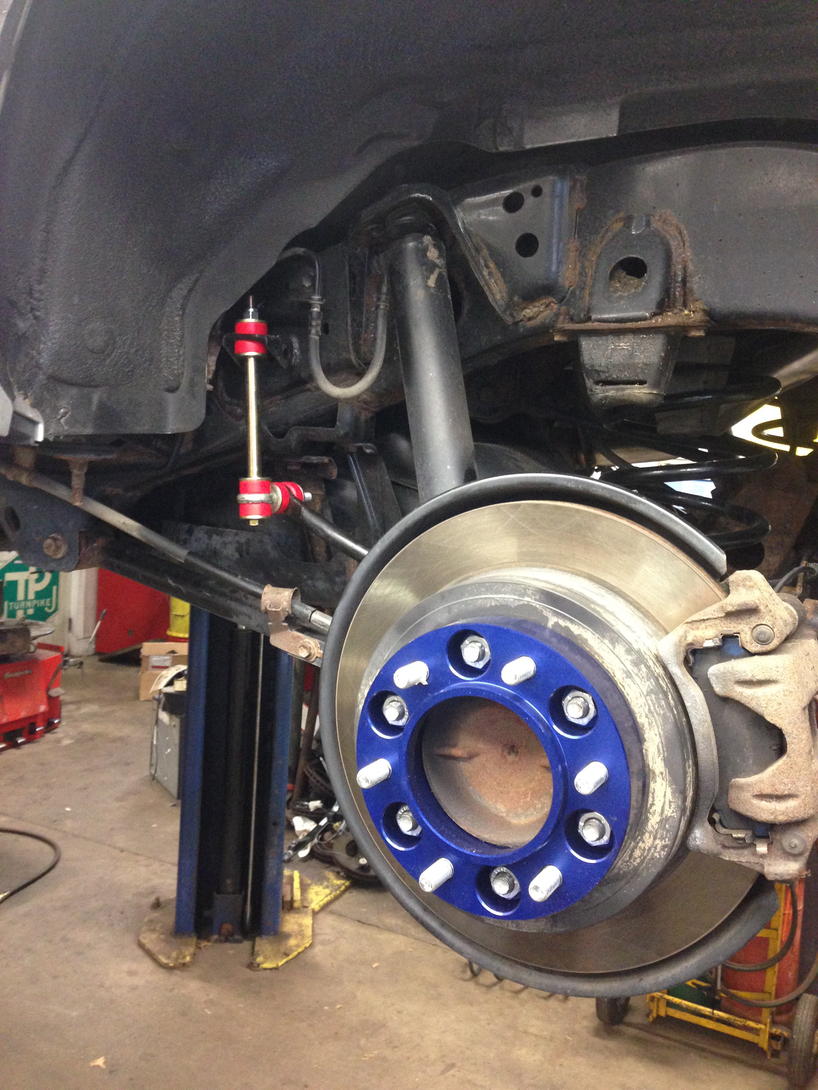

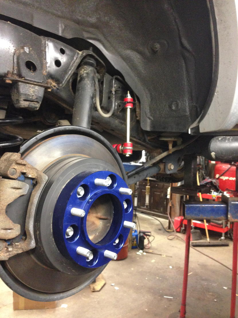

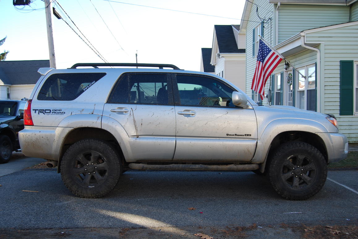

Now for the fun stuff ! I wanted to do a reasonable lift right now and still maintain the Xreas suspension since everything is still good and intact. I was originally just going to do the daystar spacers but then i figured if could stiffen up the ride and gain the same lift that this would be a better route. I purchased a set of brand new FJ springs from a member on the FJ forum and the Cornfed 2/1 spacers along with a 1" diff drop, Custom rear end links and spidertarx all the way around.

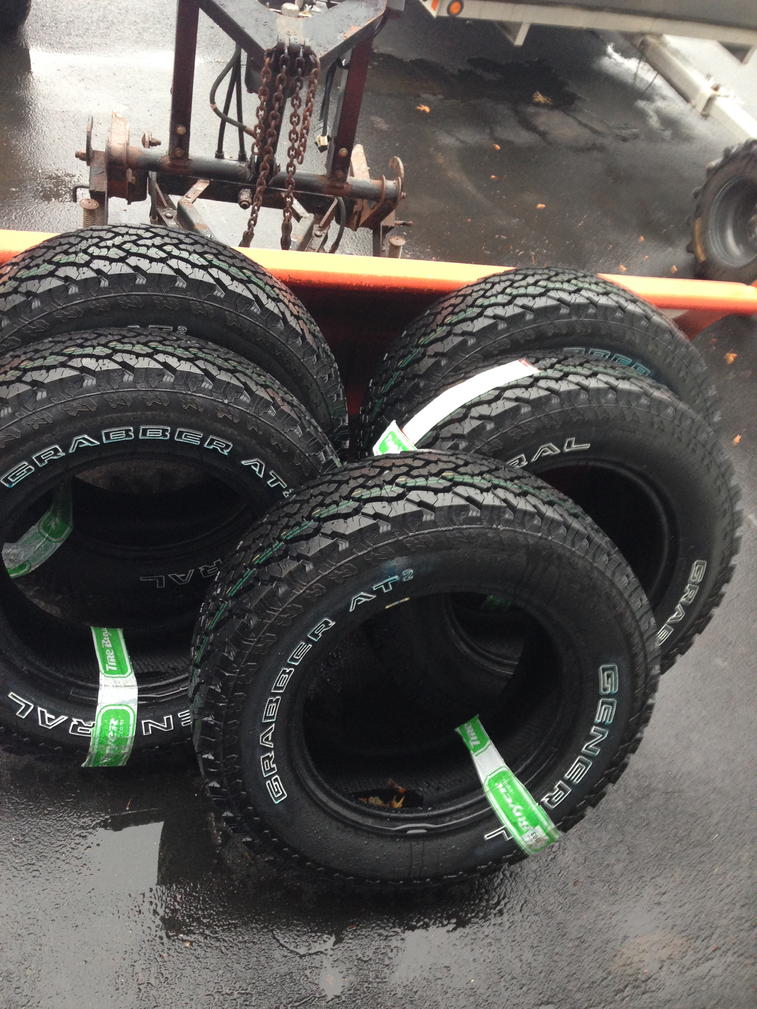

Tires 275/65/18 General Grabber AT2 E Rated
Only had them for about a week and so for love them! they feel nice and solid on road and got to test them on a coupe trials one with light snow and they did great these tires are solid, wasn't anything too difficult but still off road.

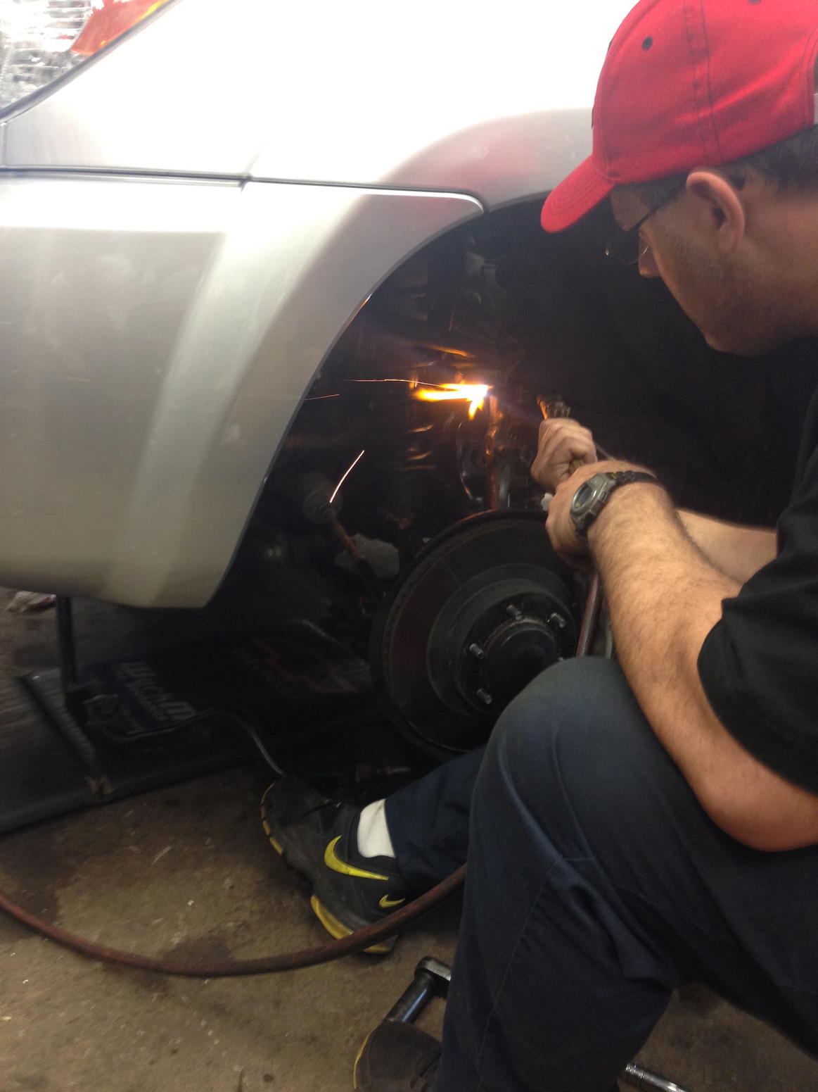

I did the spring and spacers at my buddy's shop. The install was pretty simple and straight forward, i was a little worried about doing the fronts at first with the Xreas but it went really smooth! It definitely helped having the attached links in the FJ sticky. I will say my buddy was Huge help as he's the mechanic but Definitely having the right tools is must and made life a lot easier! The only thing that gave us a issue was the upper ball joint nut on the drivers side was rusted and we couldn't get it off.But thats what the torch is for:flamethrwoer2: Again Tools!

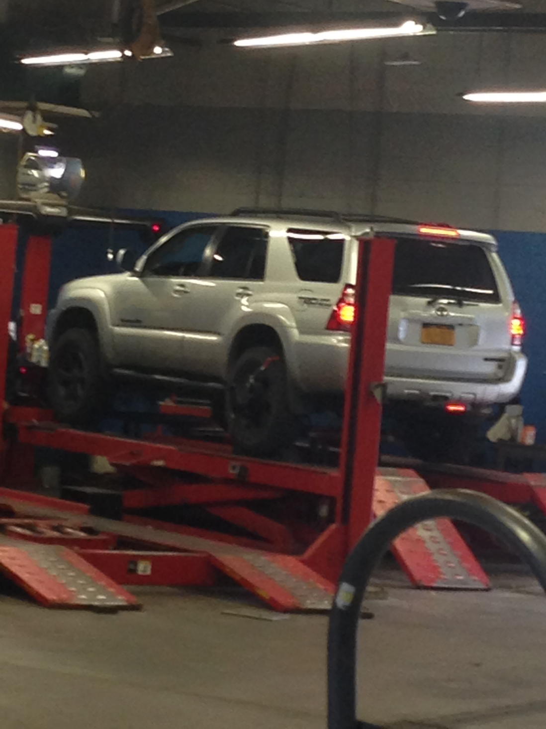

Alignment bad cell pic

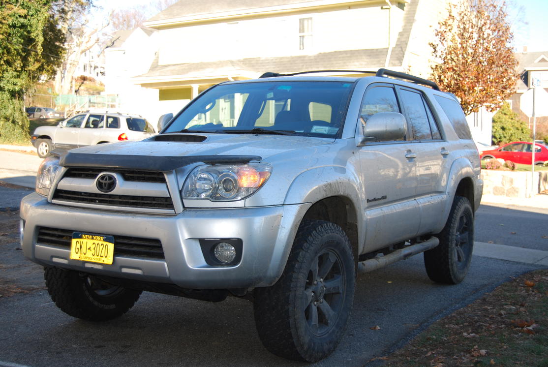

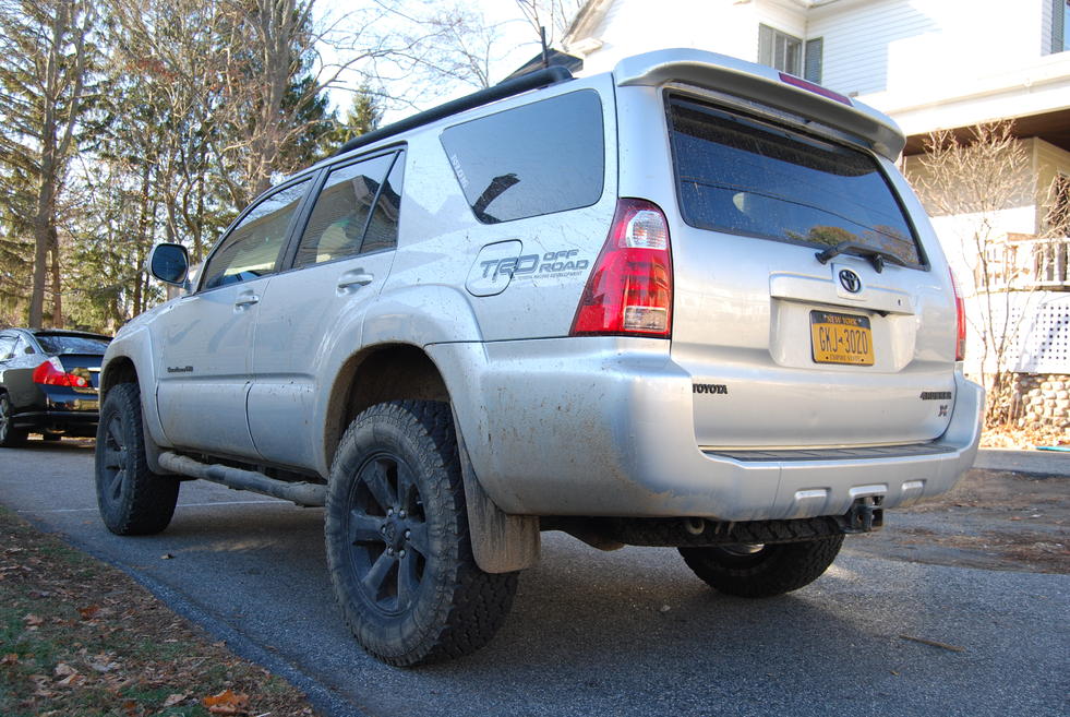

Really happy with the way it turned out! It rubbed a little when turning in reverse, After the alignment it rubber worse but not in reverse but when making sharp turns on both front fenders, 5 minutes with the dremel took care of that oh and i moved the fender liner forward while doing the front lift. I don't have any pics of this but just thought i'd share
How it sits now

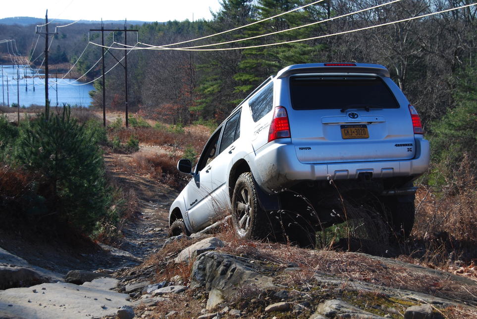

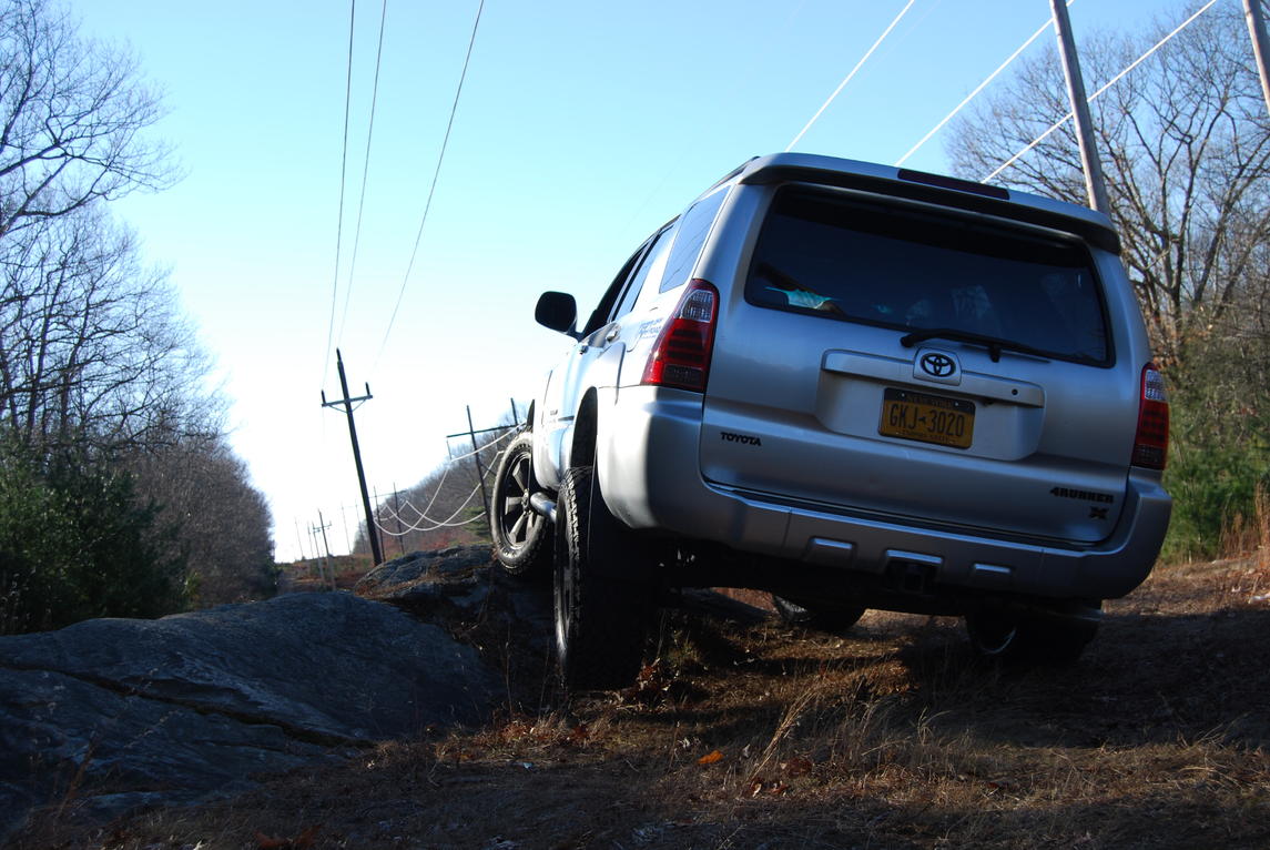

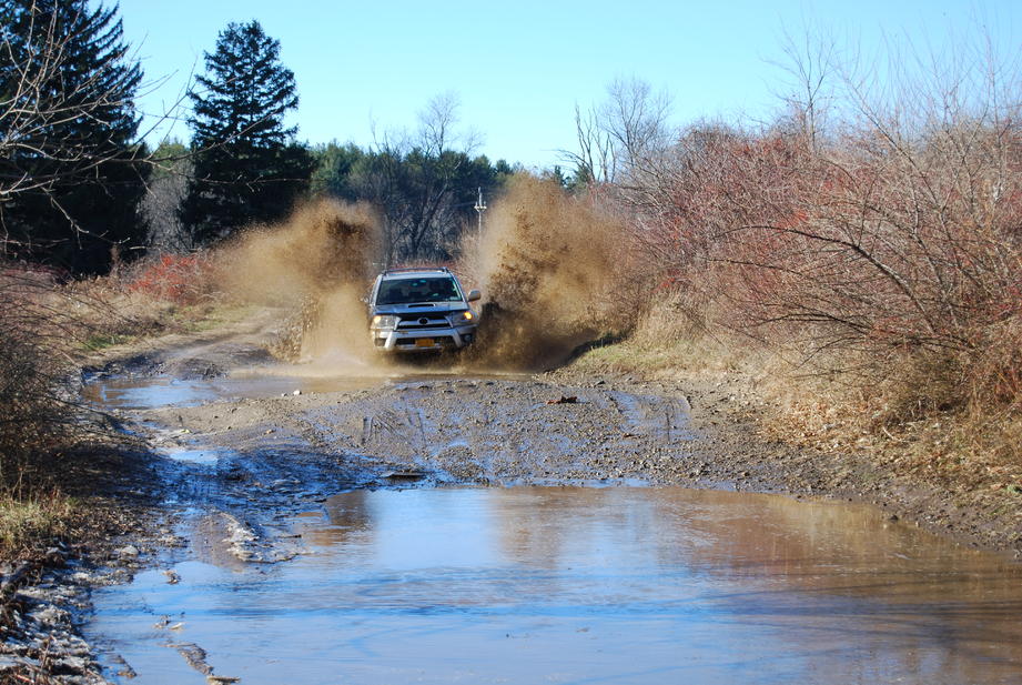

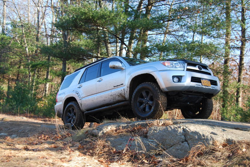

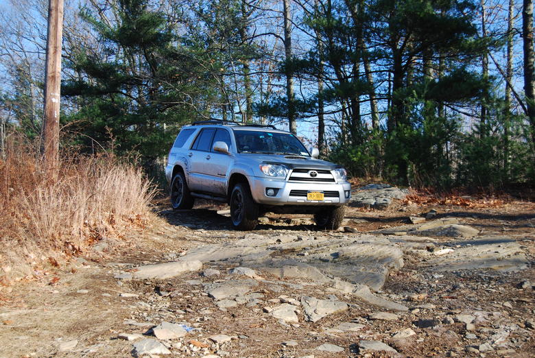

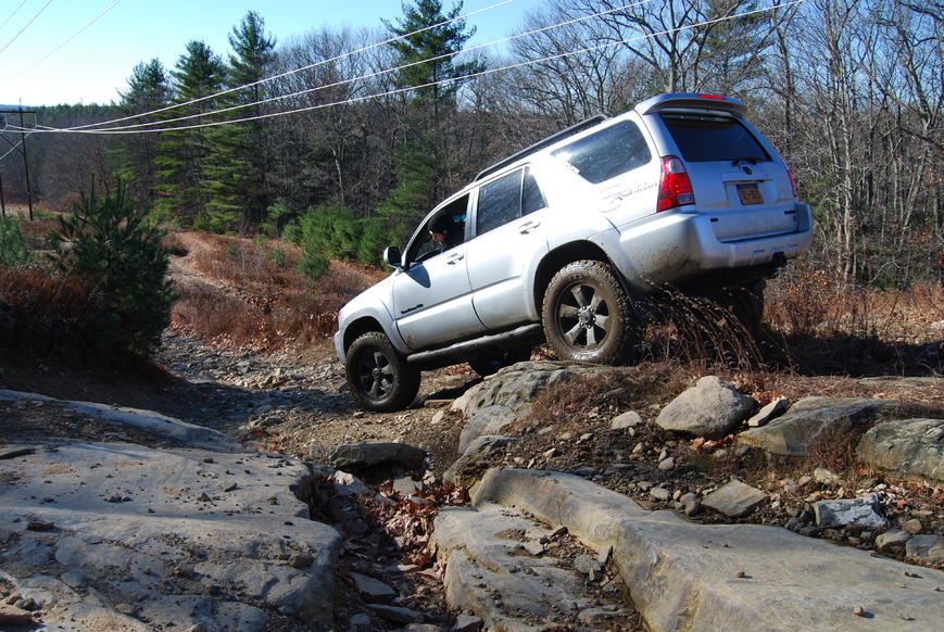

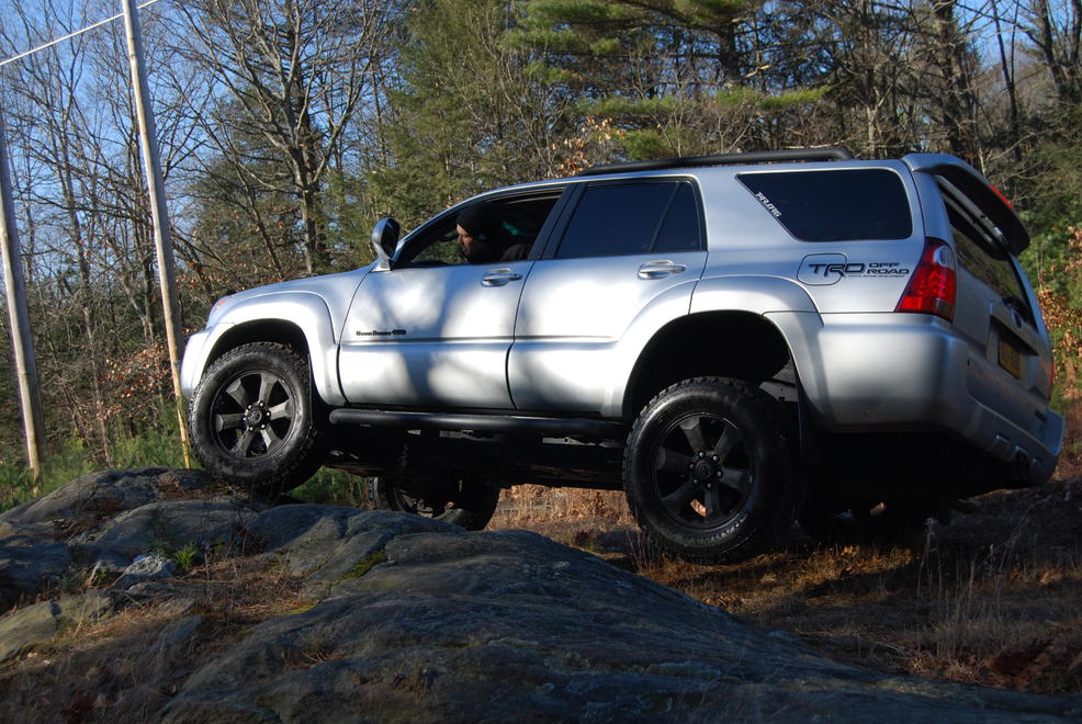

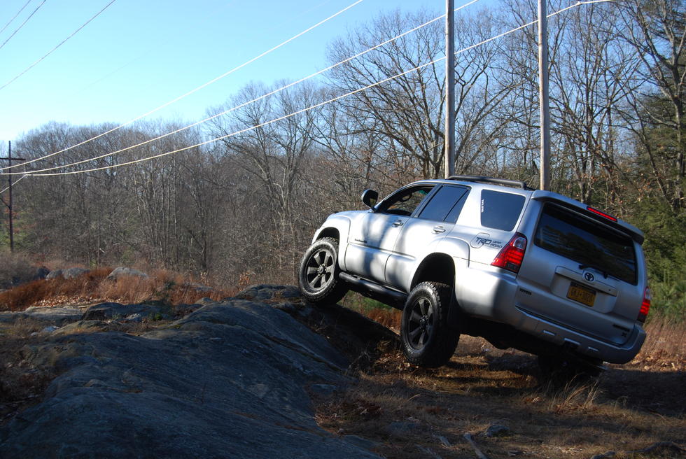

Got to sneak out and play for a couple hours today before Thanksgiving dinner and get her dirty:biggrin2:
Testing the flex
