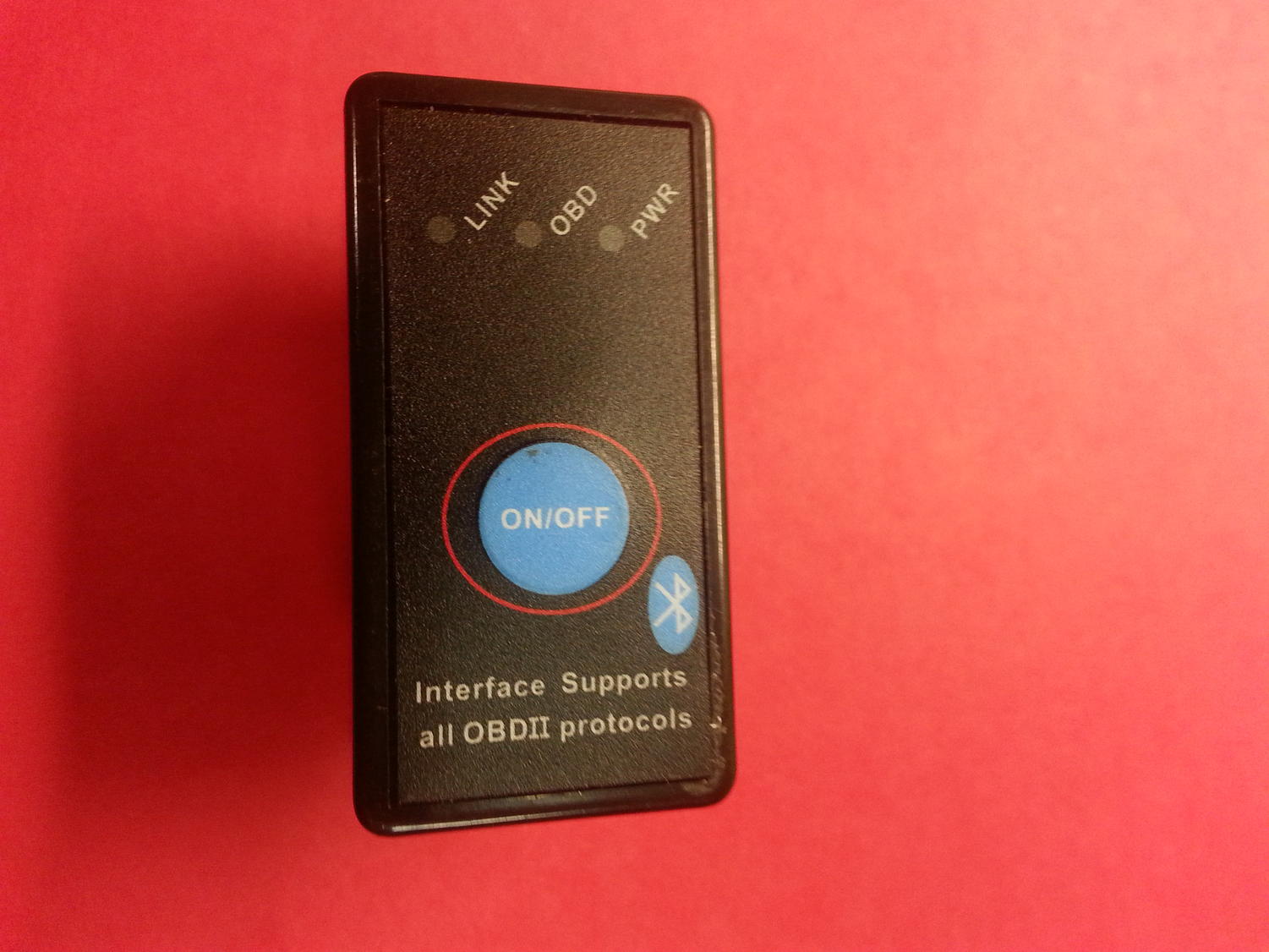

I've seen others mention being able to read transmission temps on the later 3rd gen 4Rs. On mine (2002 Limited), the list of available readings doesn't include trans temp.
This is my adapter; I use the Torque app on Android.
What am I missing?

Paid. I've got one of those cheap China modules, so maybe it's not 100%. TFT isn't a requirement, since I'm not towing, and it still would be nice to have.

this is the adapter I have:
works perfectly with torque pro on my '99, and was only about $12. you have to use trans temp type 2 I believe from the list of monitors. pretty sure only '99+ are able to read trans temps.
