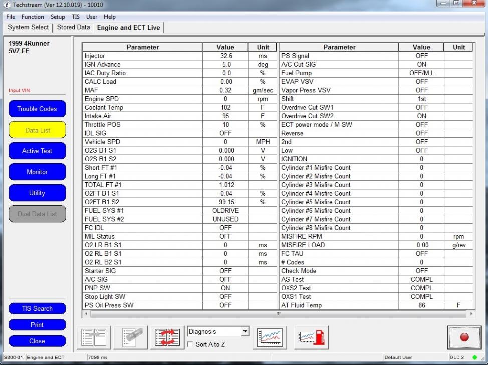

I think you're referring to Techstream software. There are major limits on
what it can do on the rather primitive 3rd gen system.
Some discussion of that.
Far as I know, OBD2 is read-only.
I have Techstream and about the only "programming" it allows is with the immobilizer and keys. It's a diagnostic tool first and foremost, which is what a Toyota technician needs.
