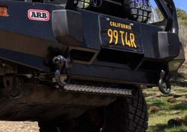

Looking at this picture a 2nd time I notice that your lightbar looks to be in the perfect position to be smashed to pieces while on the trail. :photo:
I love the front end, otherwise. Buy a Savage Offroad front end Skid, paint it and the D-Links red and we'd be near twins.
BTW I haven't had a front plate since 2010 and LEO has never bothered me.
RCI skids arrive Wednesday, thanks to the group buy, and I will probably move the light bar to my roof basket.
You've mentioned your license plate / LEO experiences before, but I'm a virgo.
