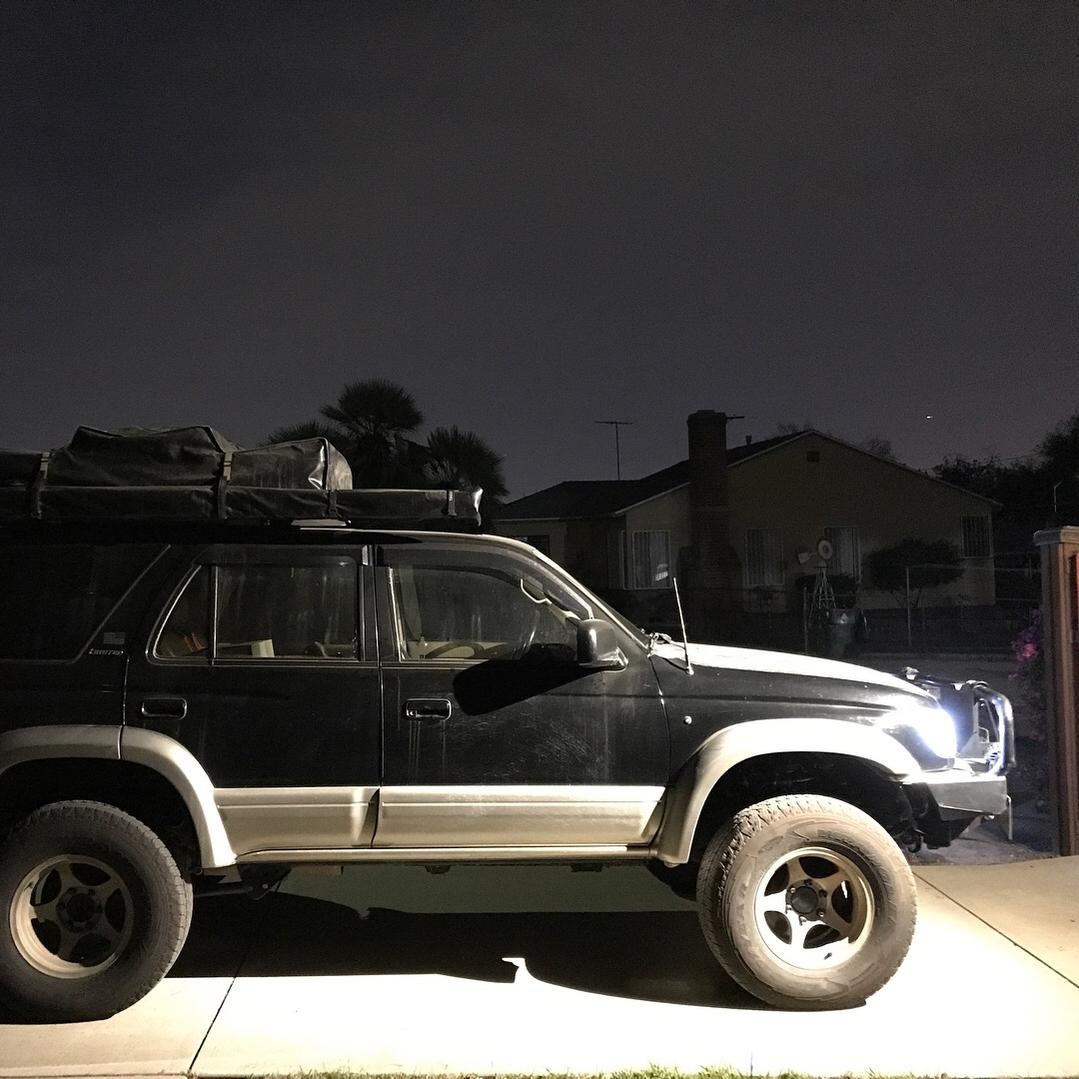

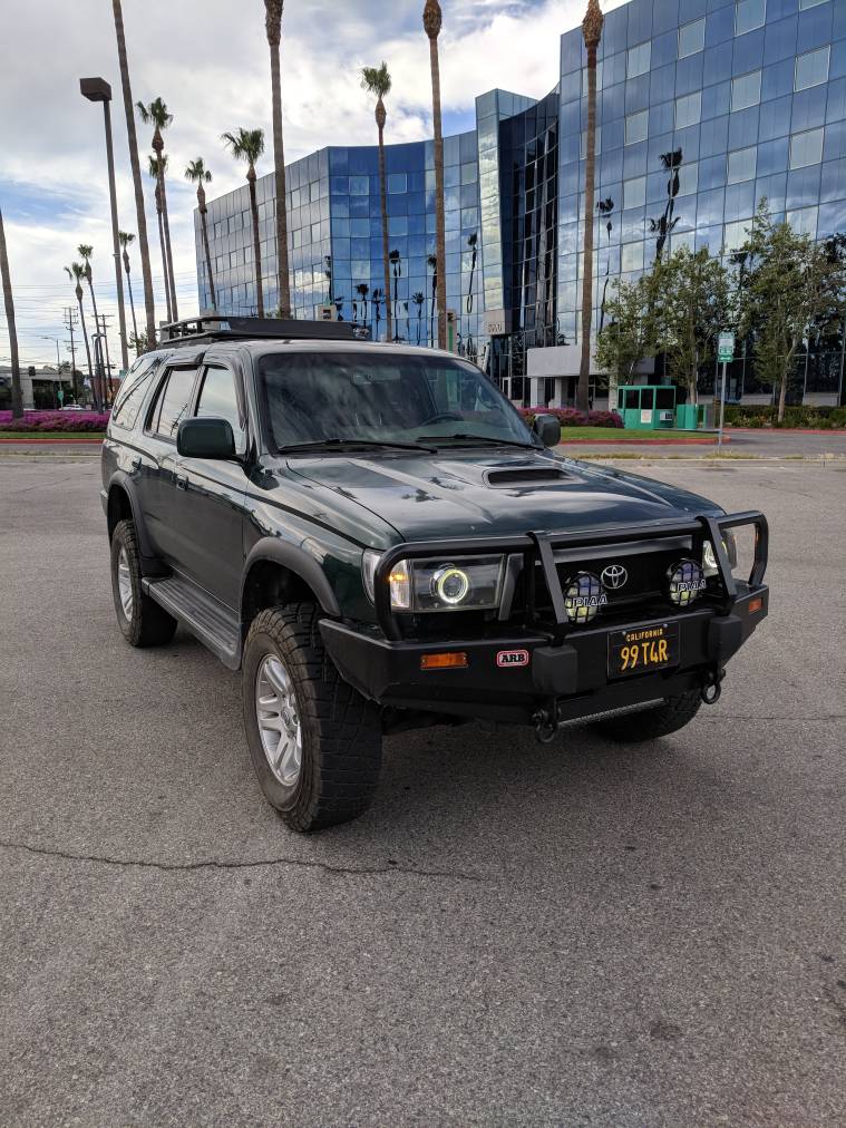

Pulled out my OME 890s and installed LC 8-wraps @ 263,812K and gained 2" in the rear.
With a full tank of gas and no humans, I measure 40" to the middle of each rear fender flare. Previously it was 38" driver/38-1/2" passenger.
The 890s were 17" and 17-1/2" uncompressed, the passenger side coil was taller; installer error?
The LC coils are 19" and 19-1/2" uncompressed and I installed the taller one on the driver side.
The pic below is with a full tank of gas and light load in the rear
Net result of the LC coil swap: too tall in the rear for my taste, but I'll drive it for a while and see if they settle down some.

I was gonna say that makes your butt look big, but it's HOT!!
Nice job kid!
That's quite a bit of rake. Still looks good! I can just imagine 8.75 wraps.
A new rear bumper would fix things.:wink2:

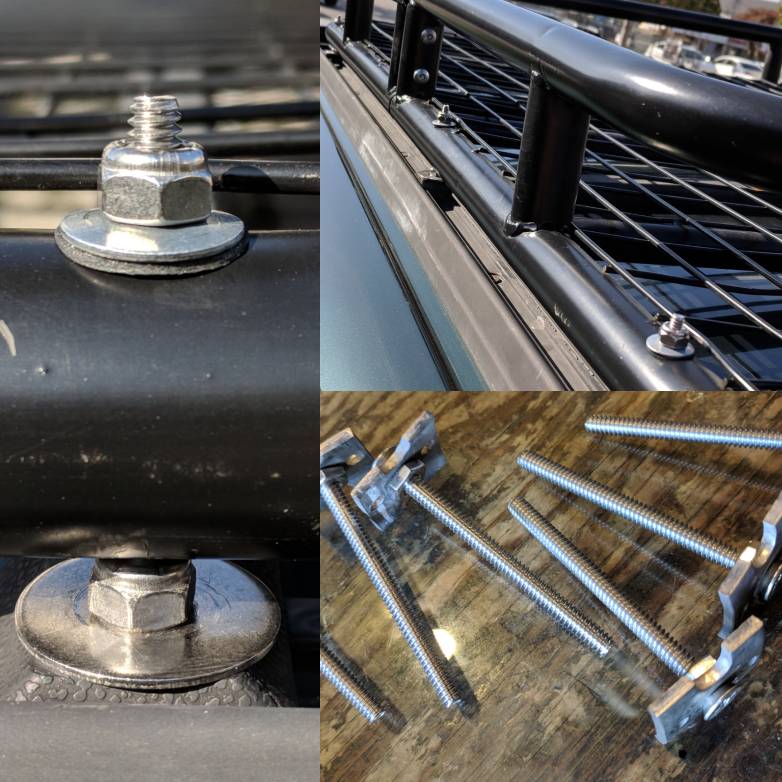

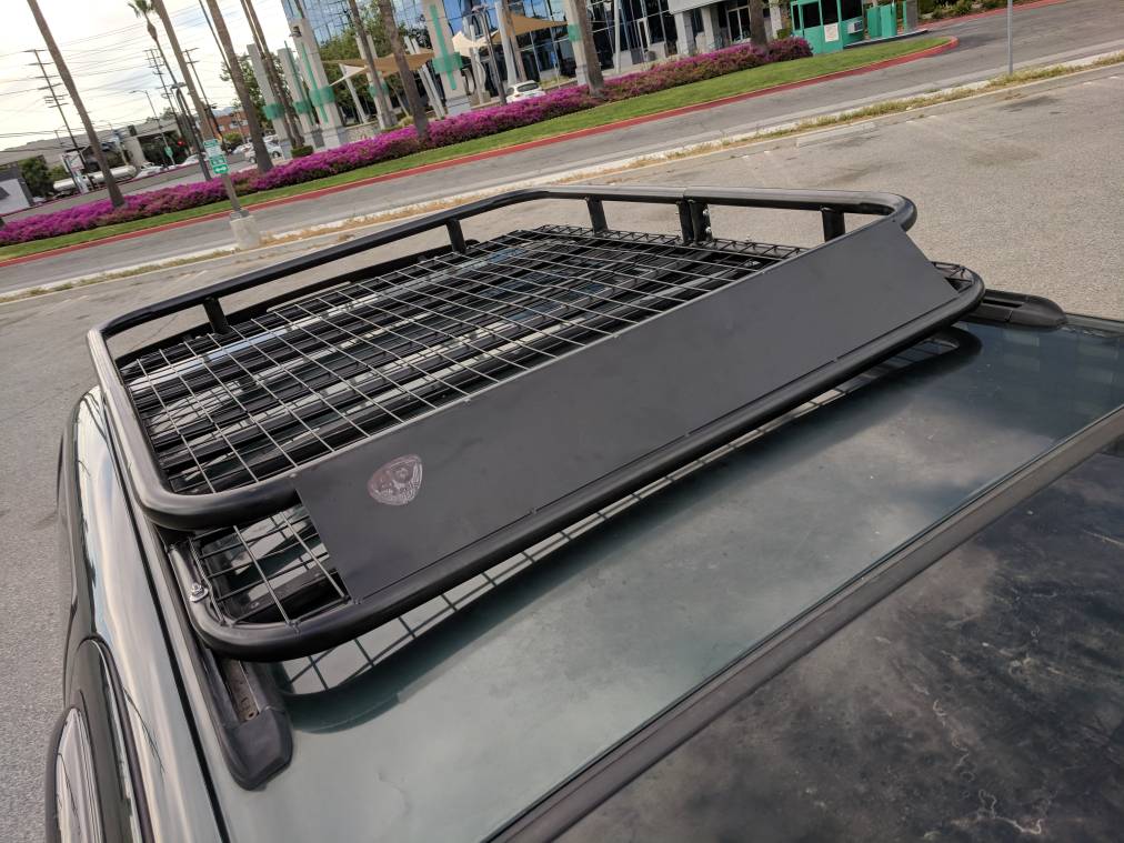

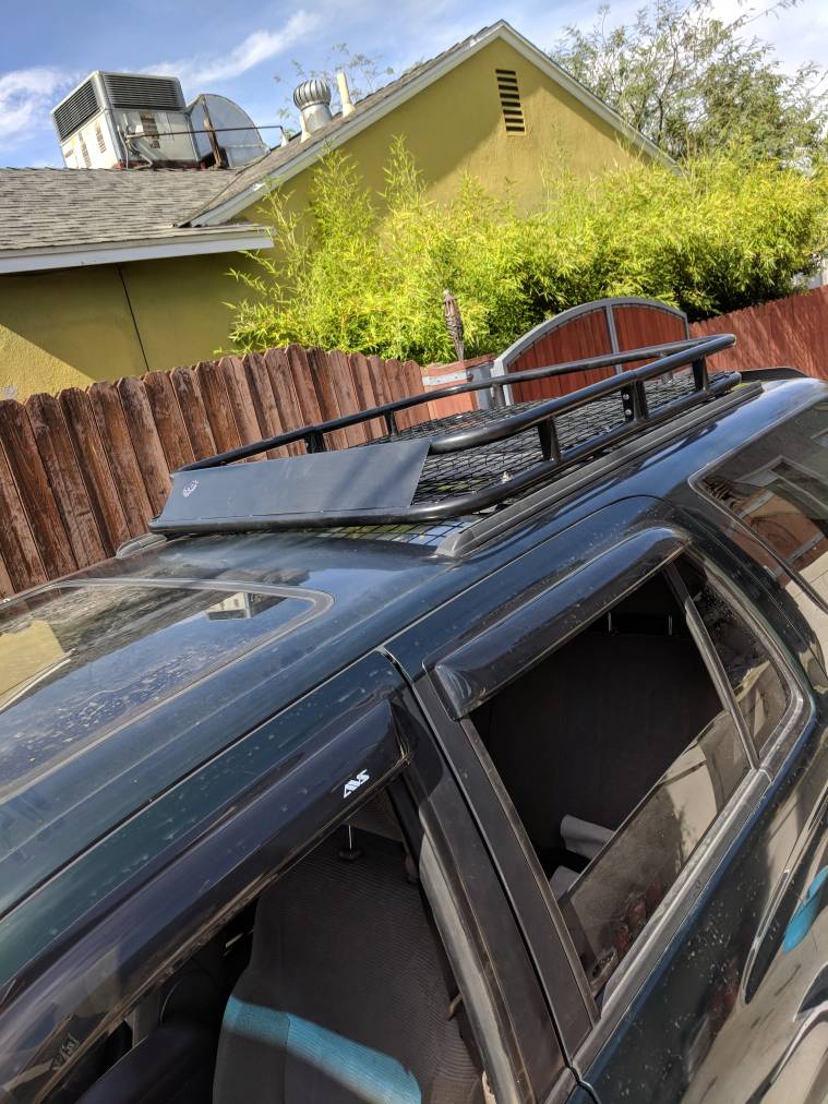

Installed a new to me roof basket today that I picked up from a forum member last week.
I removed the factory luggage-rail crossmembers, keeping the roof tracks, and made adapters to mount the rack to the roof using the sliders inside the tracks. Fun project.
I ran a 2-1/2" 10/24 flat head screw up screw up through the track anchors and secured it with a jam nut and some Loctite. Install those in the track with screws pointing upwards and use the cross bars over them to secure in place with a fender washer and a lock nut. Then I drilled quarter inch holes through the basket bottom rails and dropped the basket on top of the screws. Add a rubber backed washer on top and another lock nut. I used all SS hardware.
Note: I would have used SS M6 flat head screws but I couldn't find them in 2-1/2 inch long anywhere.

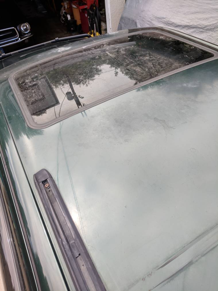

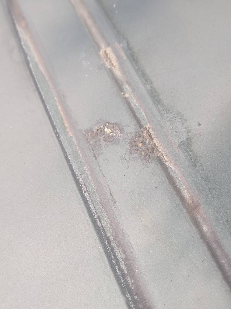

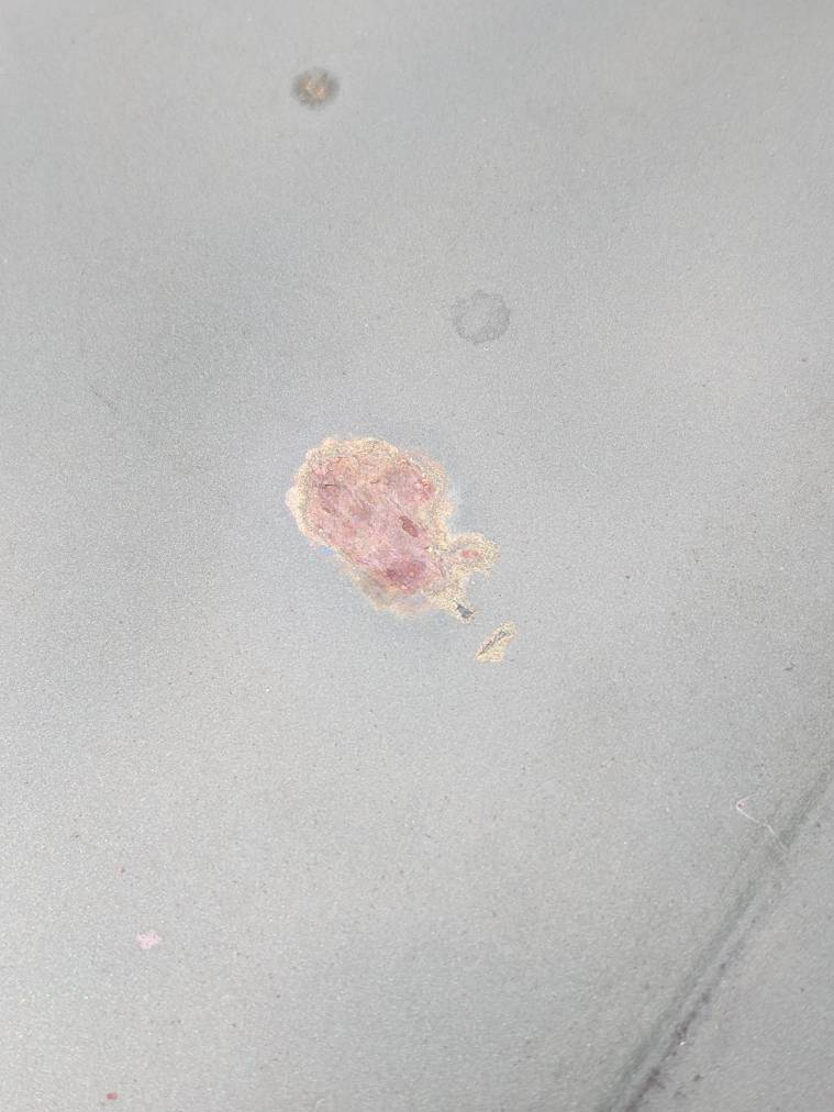

In the execution I found a few rust spots on the roof that will need tending to soon
