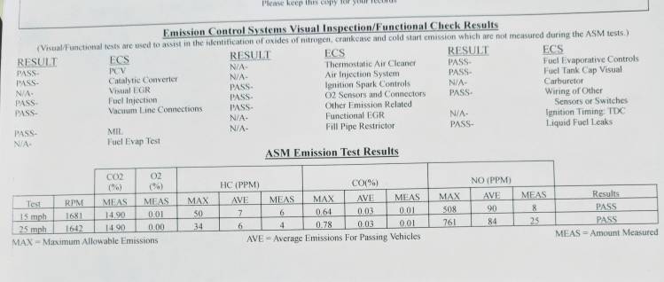

Passed a smog test today, literally with flying colors - the tech was well impressed.
I did nothing special to prep for the test except make sure I had no pending codes and my emissions were well below the Average Emissions for Passing Vehicles
