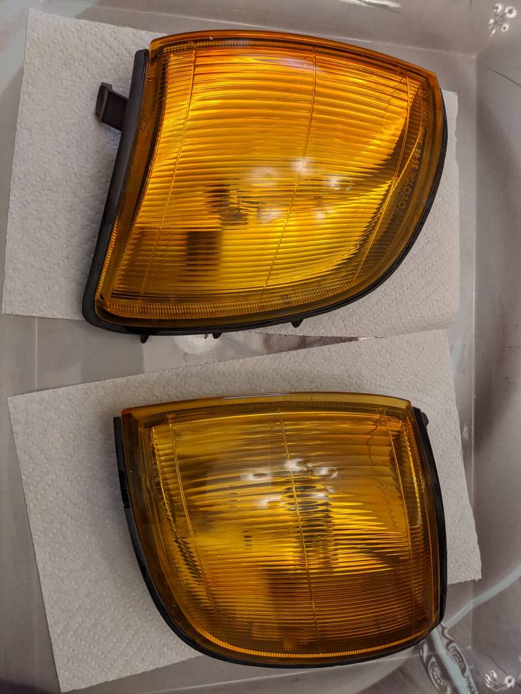

Started the process of dying the clear corners orange using Tamiya X-26.
I really like the orange corner look and the next step will be to make the corners flash with the turn signals. Future aesthetic projects #2 & #3

I'm planning on 3 coats and then clearing them with 1-2 coats of 1K
From what I've read, the Tamiya can be slow to cure, so I'm taking it slow, waiting 24 hours between coats for the first few coats. Here is where they are after a single coat

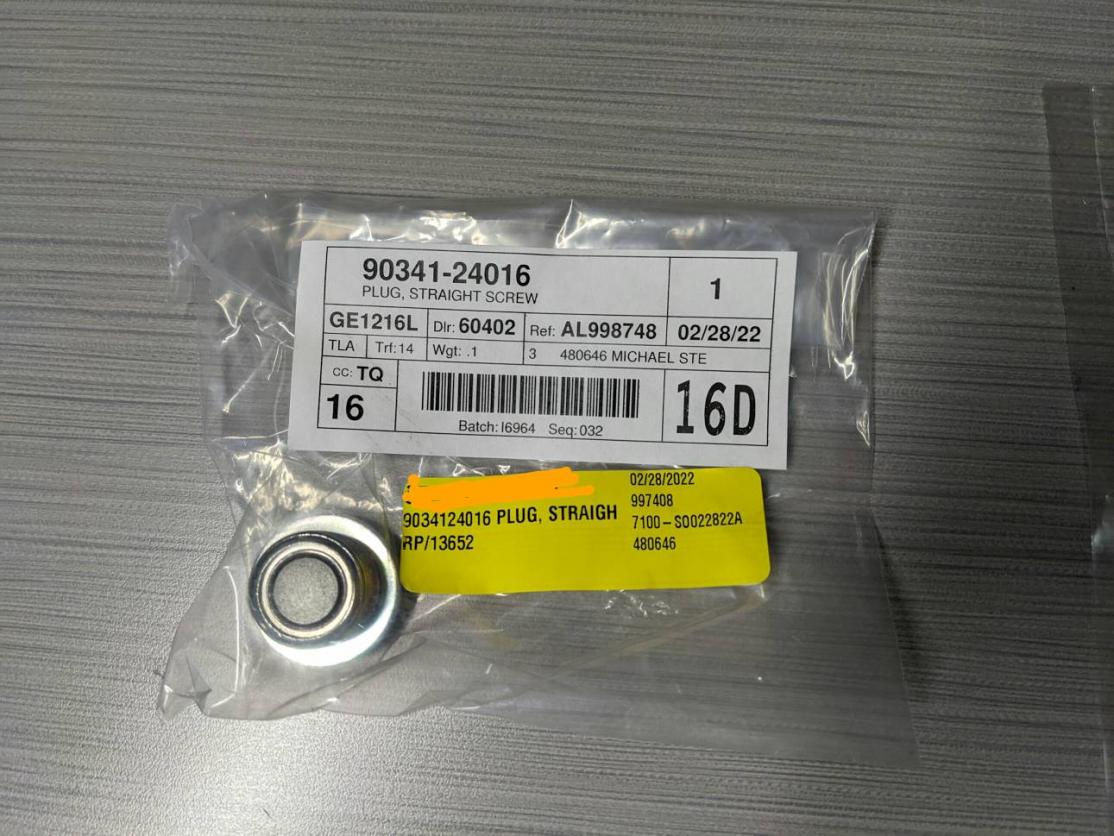

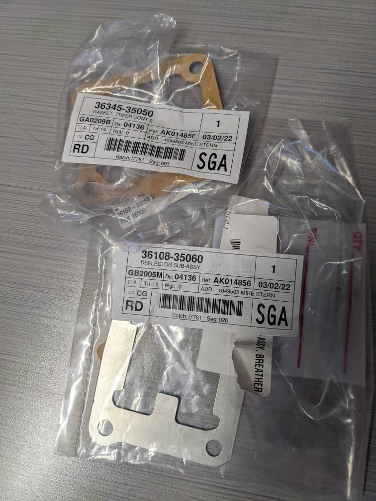

Got these today
For my upcoming LBJ replacement
Lexus front diff drain plug
Transfer case oil deflector and gasket
Edit: the deflector comes with one gasket and as per other members there is a gasket above and below the oil deflector, two are needed

I decided to stop at 2 coats and will put 2 coats of clear over them before installing. I'm letting them cure first. If I were smarter I would have baked the corners open and painted them from the inside... next time.

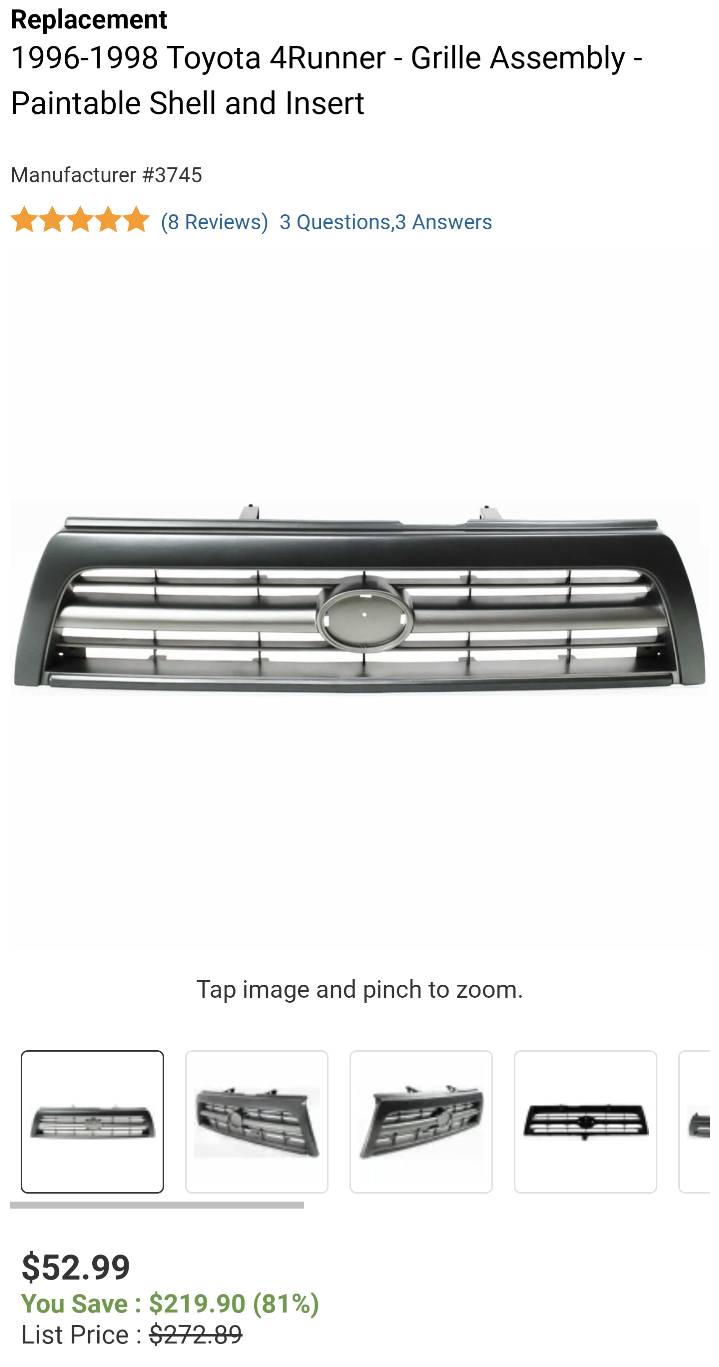

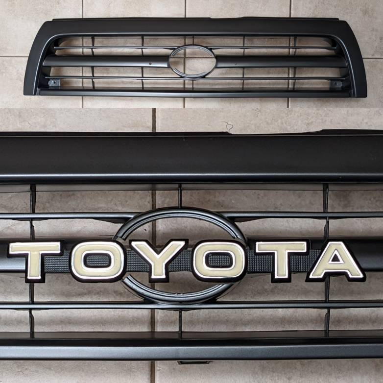

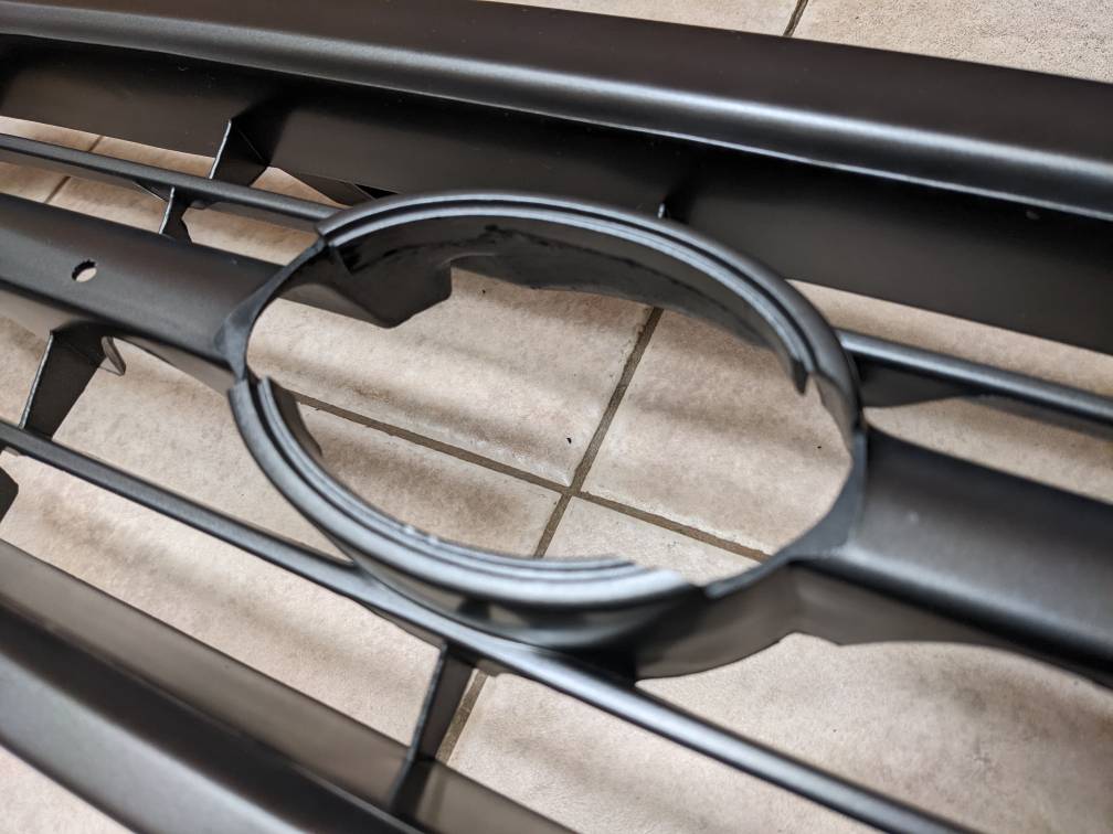

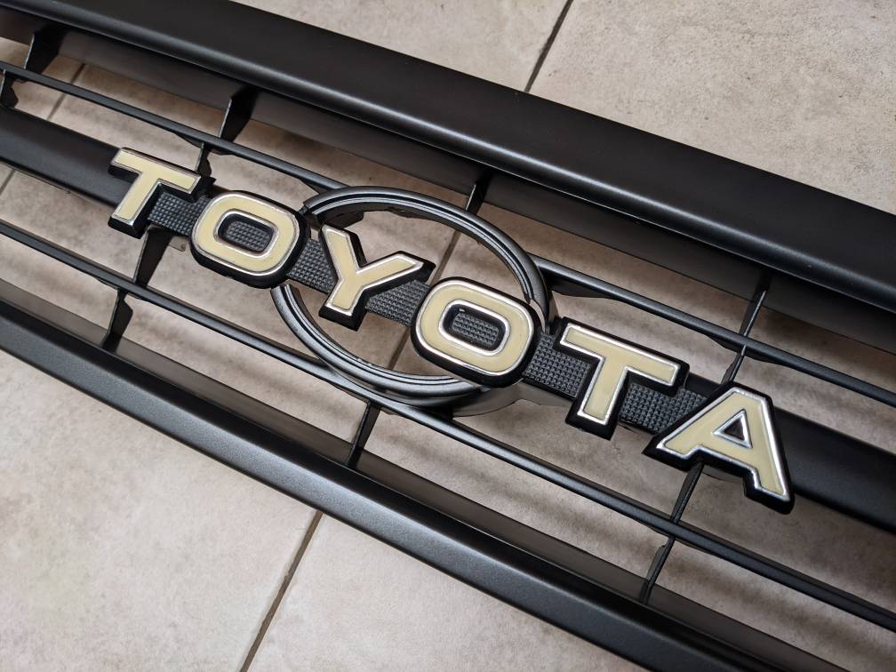

Started another Satoshi project, actually, more of a semi-Satoshi this time. I started with one of the plain Jane painted ones and widdled on it some.
I figure I can always go full Satoshi if I hate it lol
