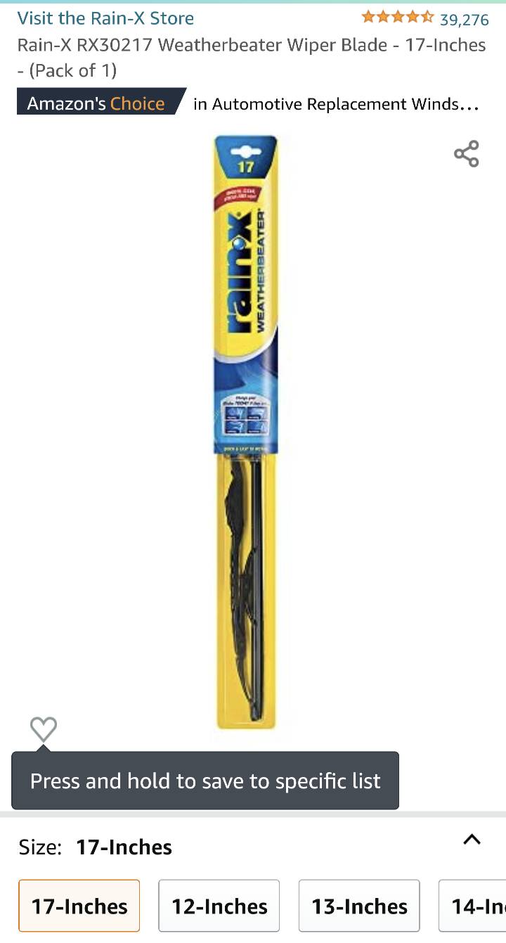

Windshield wipers, Part 1
Installed replacement wiper stalk from [MENTION=254416]JROTN[/MENTION]
Also new wiper blades, for good measure
Ordered Honda Odyssey sprayers
Stay tuned for rear wiper blade refill/hack

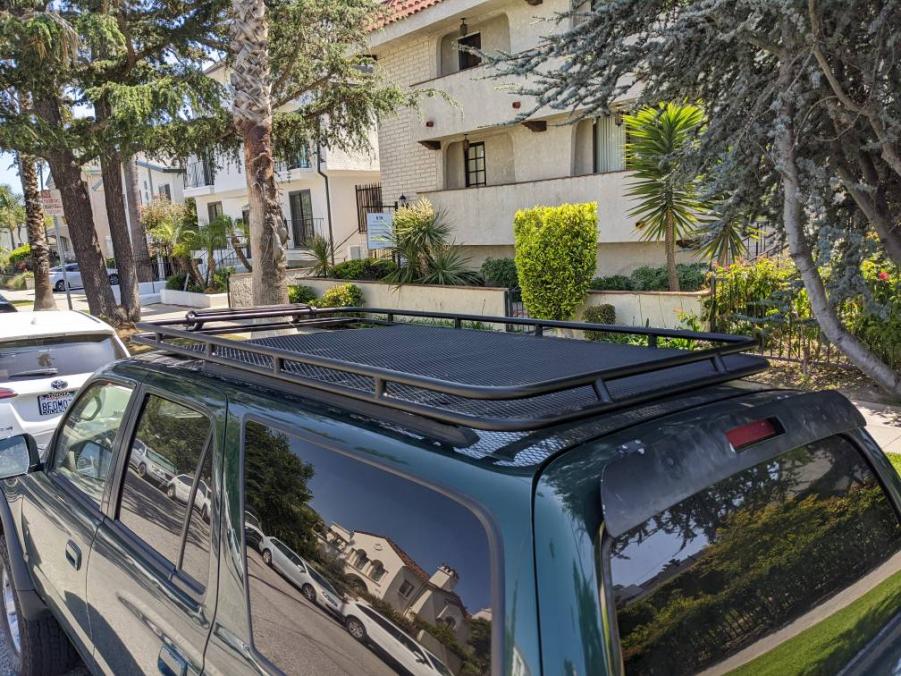

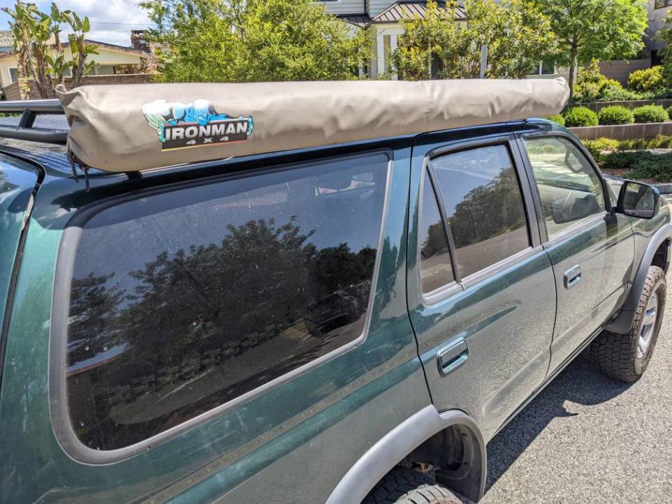

Full length roof rack and awning
A local FB fabricator and his dad makes these in Compton, CA. He modified his design to my specs and I got exactly what I wanted. I clear the pipes in my garage with 4" to spare
Picked up an Ironman 6' awning off another FB local and mounted it up to the rack along with an LED light bar. Wiring pending.

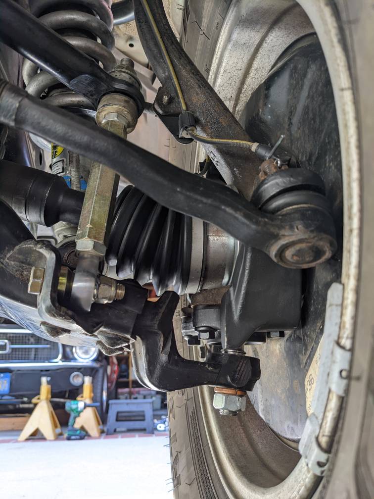

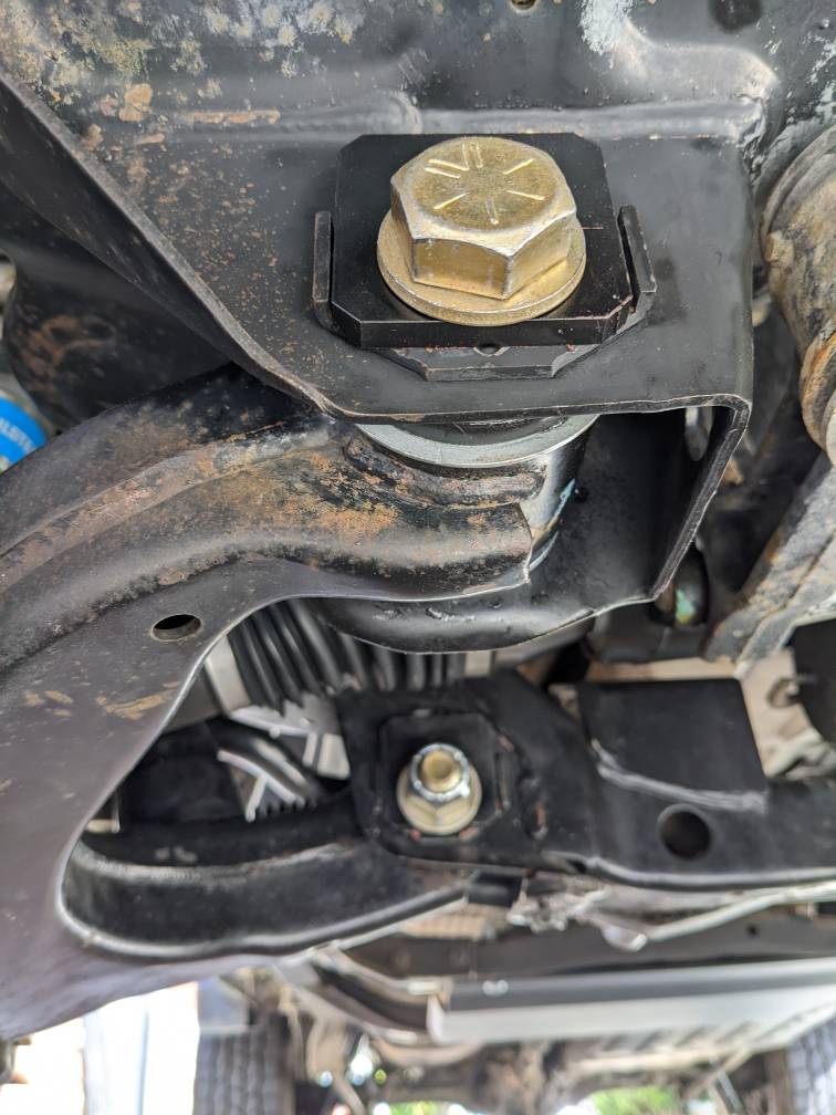

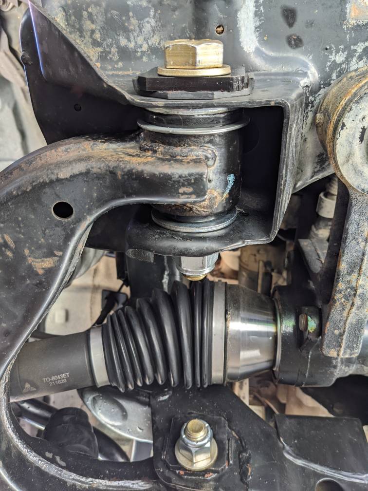

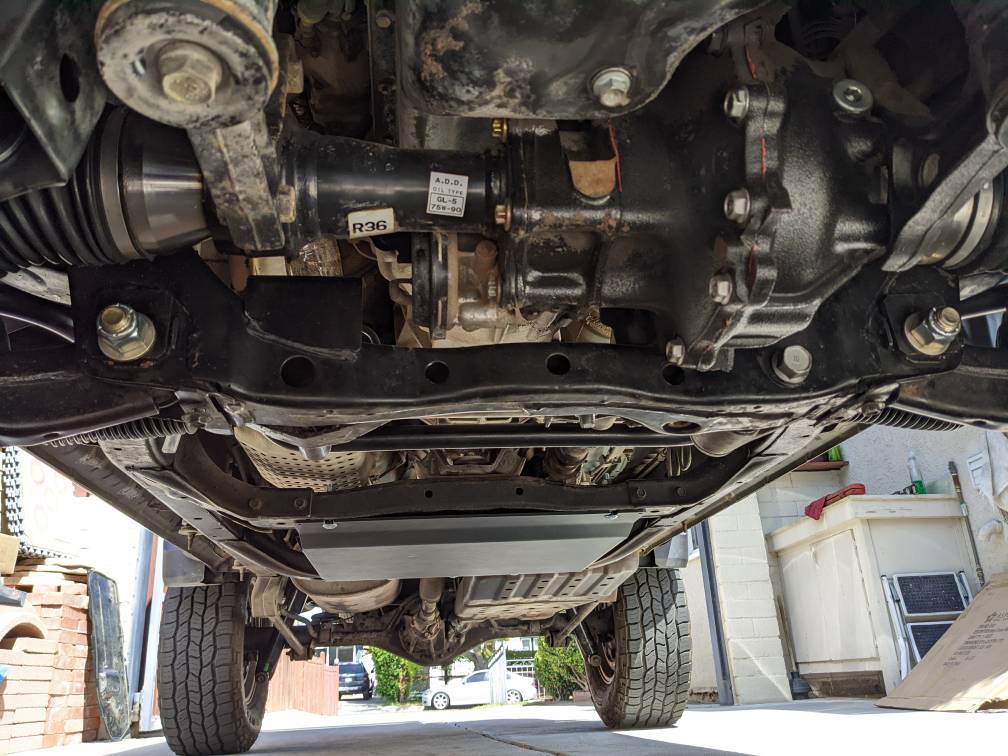

LCA/front end complete
This was basically the entire weekend: Whiteline bushings
333 Fab cam eliminators
MStudt endlinks
Total Chaos steering rack bushings
Energy Suspension bumpstops
Energy Suspension sway bar bushings
The steering rack took the longest time/slowed me down the most. I got all the work done on Saturday and left all the torquing and tuning for Sunday. But I'm happy with how it turns out.
PXL_20220424_215434158.MP.jpgPXL_20220424_215401741.MP.jpgPXL_20220424_215353010.MP.jpgPXL_20220424_215319967.MP.jpg
Once complete I had to re-align and reset toe and caster, I believe I have around 3° positive camber based on my crude measurements. Next weekend, professional alignment. She tracks straight on flat road, so that's a win.

Next weekend I'm installing a wind fairing because the new rack is LOUD - thanks to [MENTION=116387]Unner[/MENTION] for the fairing rec. I also have a fresh set of pads and rotors to throw in someday soon, too.

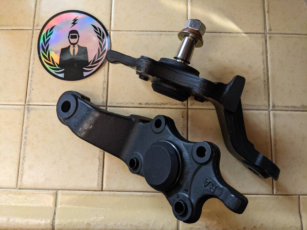

One last pic...
Who wants to guess what that's for?

Truck is looking good fast! Those CVs are interesting looking and I'm intrigued by those alignment cam eliminators also, just don't want to take everything apart...
I'm guessing the plug is for a field monitor of some sort?

Thanks, second time is a charm
The extended CVs have yet to prove selves lol, the cam eliminators are insurance
Marlin Crawler is working on a cam gusset reinforcement kit that beefs up the entire LCA mount, I might add that if I bend out the cam tabs like others have done
EDIT: HD LCA Frame Brace, 1995-2004 Tacoma | Marlin Crawler, Inc.
Very similar to a field monitor, yes!

Total Chaos makes weld on alignment cam gussets. Total Chaos Lower Control Arm CAM Tab Gussets: 1996-2004 Tacoma Prerunner/4WD | 1996-2002 4Runner
Added Marlin URL to my post above, still says "pending" and "in pre production" and "notify when in stock" in a few places - originally posted/announced in 2019?
Interesting. I’ve never heard of those before, but looks like it’s coming along right on Marlin schedule. AKA years behind development promised time lol
