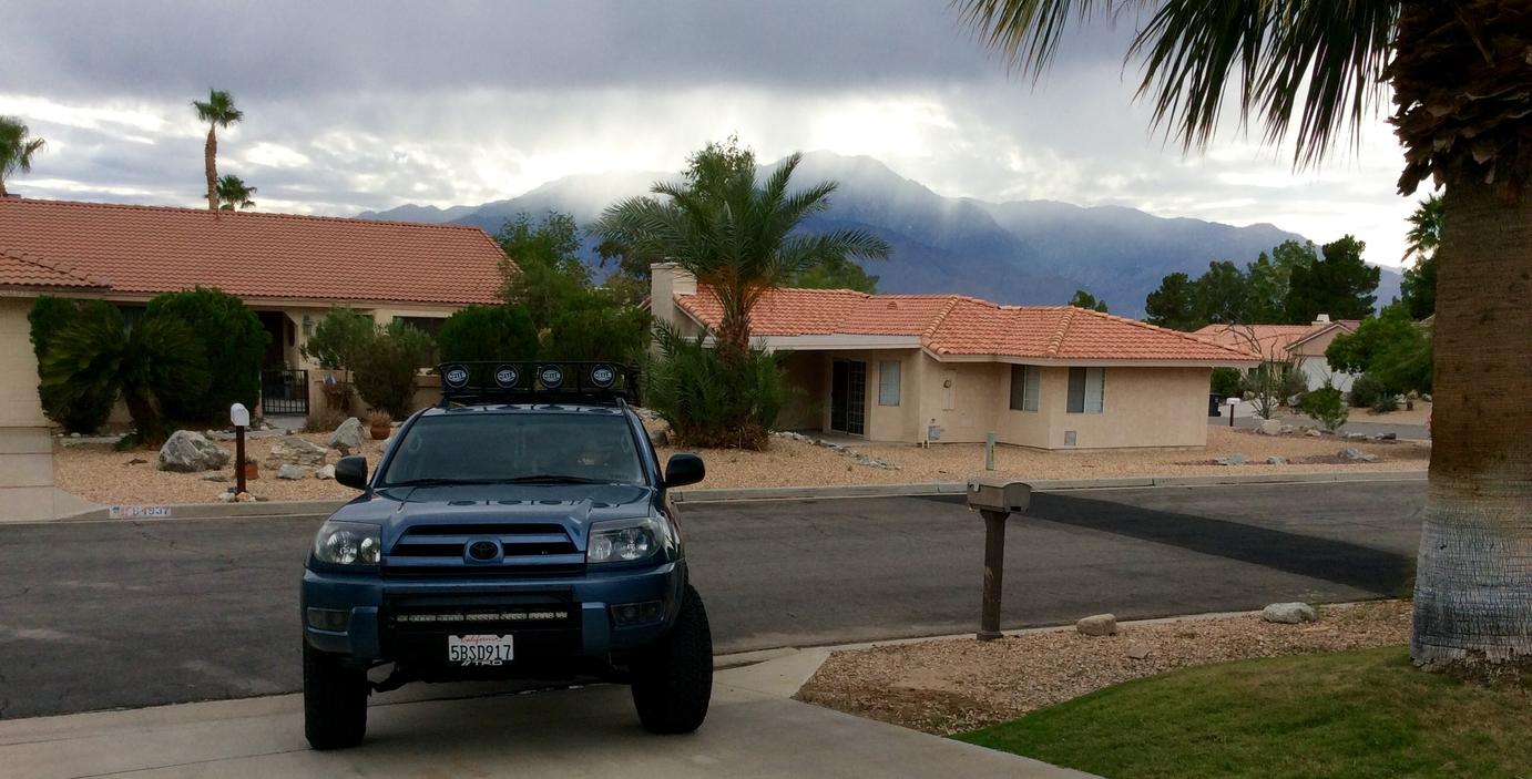

Idylwild's current condition...
Front yard view of Idylwilds current weather condition...rain.
Sorry [MENTION=10950]Brian[/MENTION]SD42 no snow as of yet brotha. Lol
I am glad that the trails are getting some good rain on them it should make the runs a lil more eventful and maybe the water crossing will have a decent amount of water as well for that added attraction factor and pics.
