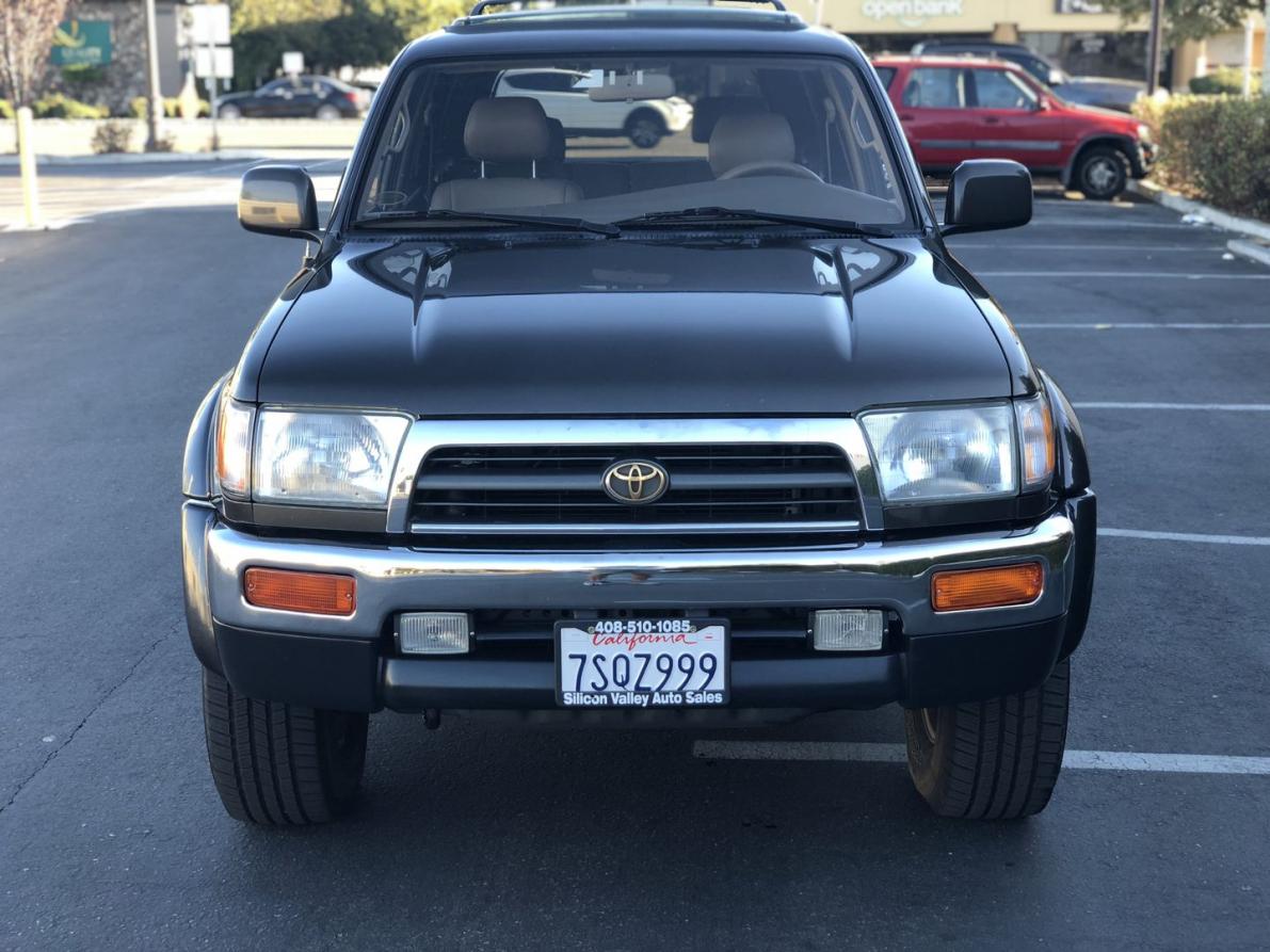

Dealer equipped option. There's mounting points for fogs in this exact location shown in the pic.

Thanks, thats where Ive seen them installed too. But Im guessing to install them, youd have to cut out spots for them on the center plastic strip in the lower grill. Mine goes all the way across, I couldnt put them there as is.
They fit in the center lower grille opening at each end. There is a factory bracket needed that fites behind and also a clip/screw type retainer for the center plastic crossbar that you will have to cut at each end. OEM were Hella and are really hard to find and $$$. I would just get another set with roughly same dimensions which is somewhere around 5"x3" or so....didnt measure but is a good estimate. Heres a pic of where they go....

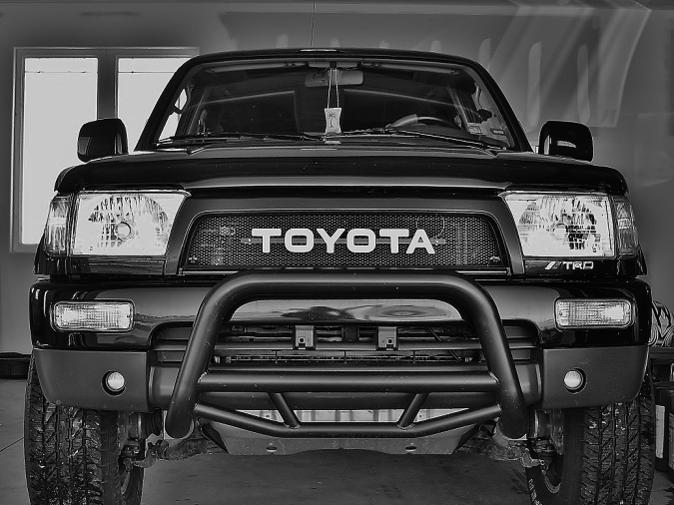

Op you mentioned you like round fog lights better. If youre willing to do a little fabrication you can install Hella Micro DEs into the valance like this. Its not terribly difficult. And the DE's are awesome. Almost like a second set of headlights. Literally I can drive around at night with just the fogs on and see fine.

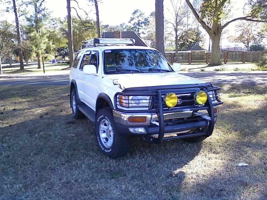

I install these to light up the sides. Very helpful when making turns. Suzuki Verone lights
