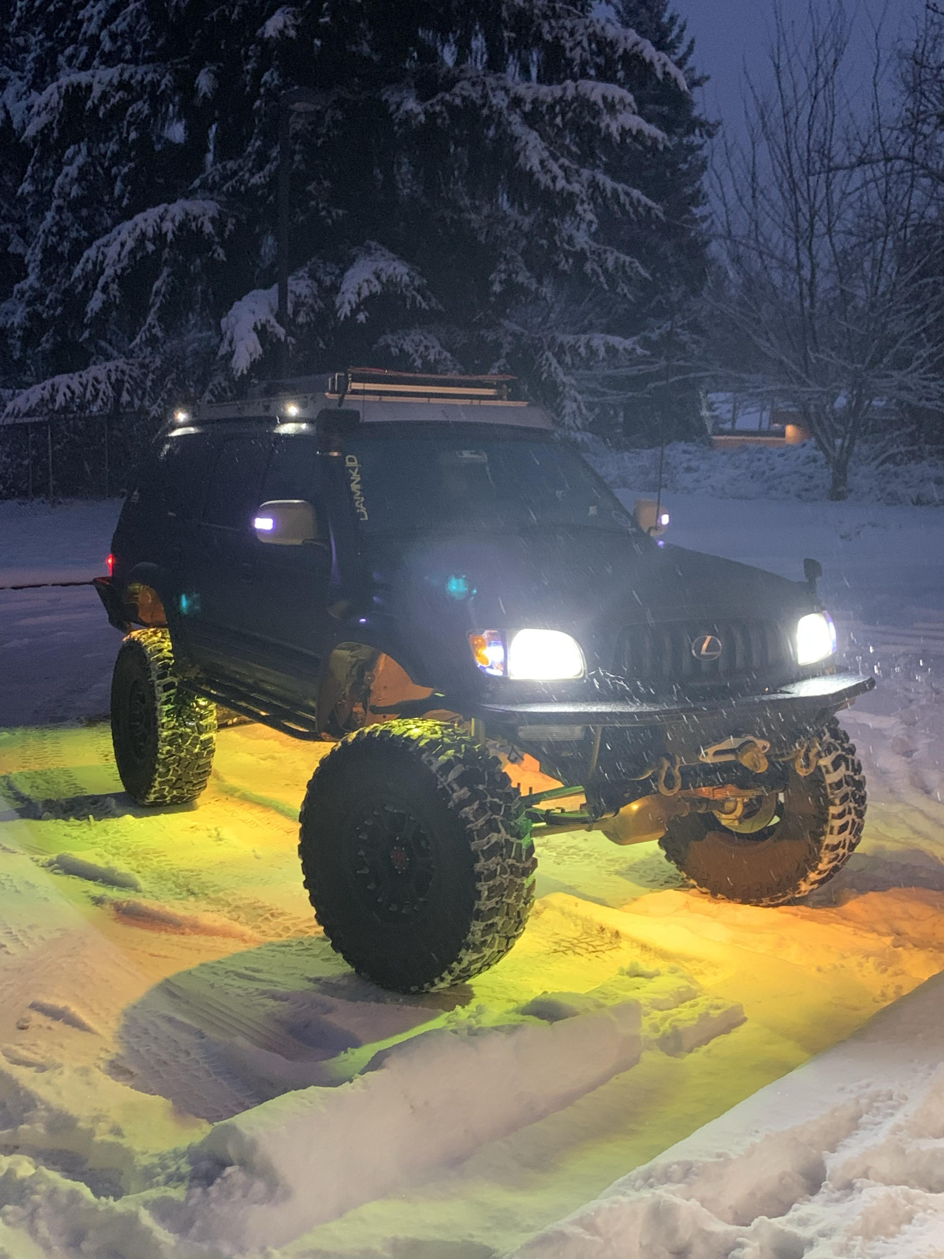

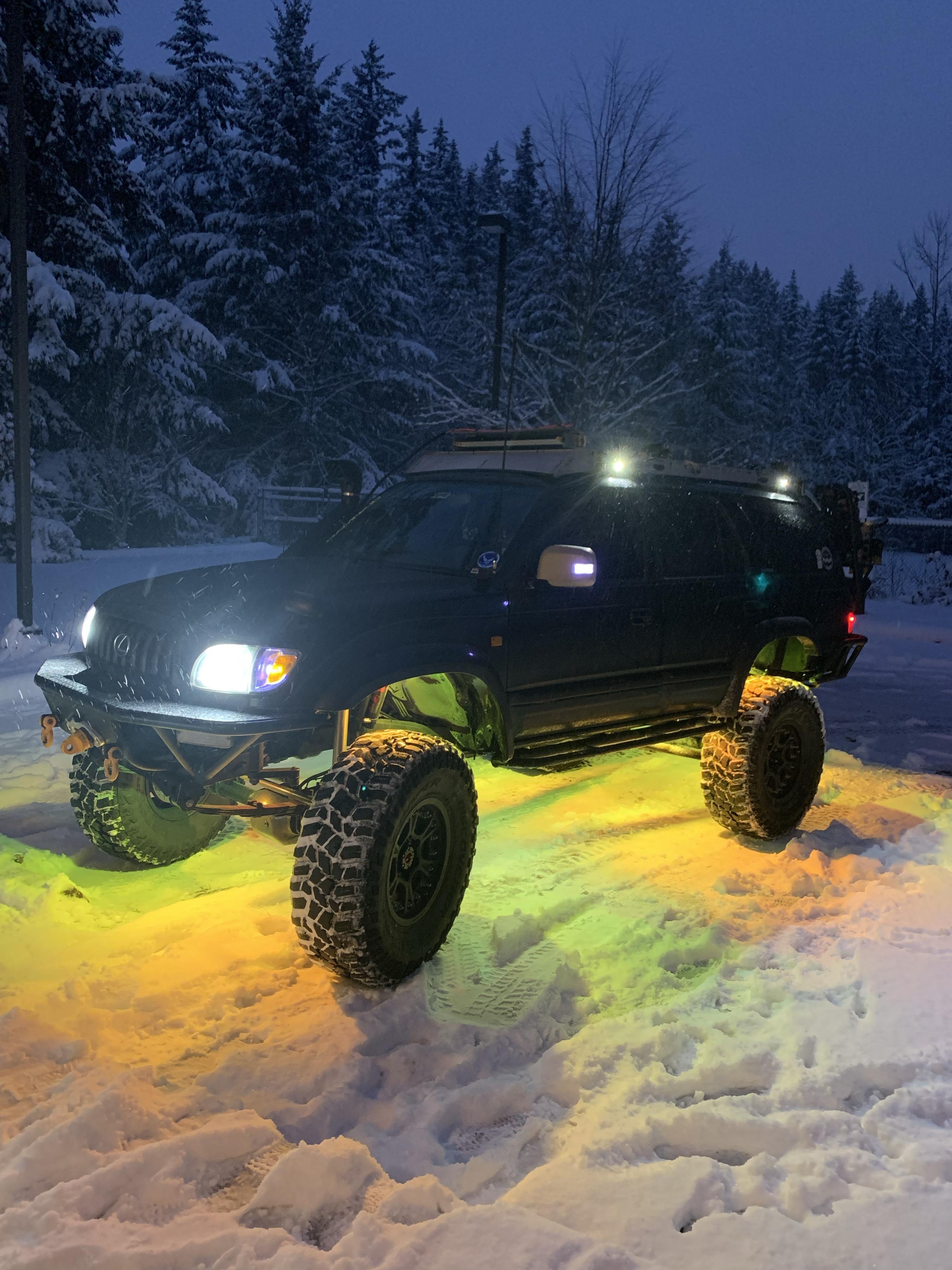

My truck never came with fog lights from the factory and the switch doesn’t only have to turn on fog lights. When I had a light bar on the top of my truck and also my front bumper, I used the switch to turn the both on.
When I actually installed a rack, I removed both light bars and installed 2 Baja Designs rock lights on both sides of my rack when camping or just need light on the side of the truck when it’s dark out. I’m using the factory fog light switch to turn those on.
