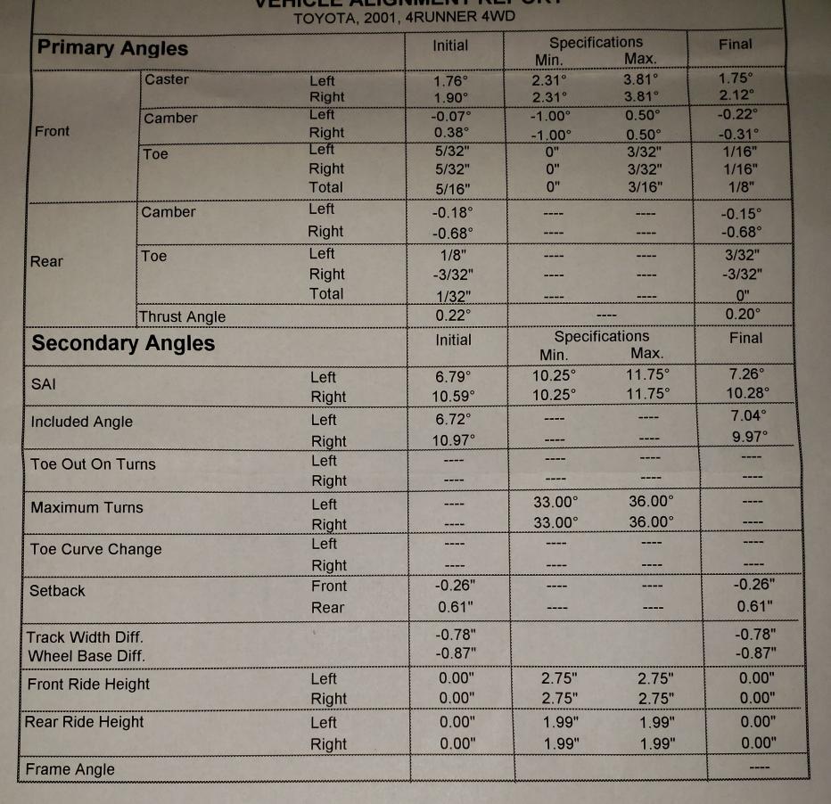

Can you put a pic of your specs up so we can see? I've analyzed hundreds of alignment sheets and repairs hundred of front suspensions on all kinds of vehicles.

Here are the latest numbers. I tried to take a pic of the front end, but it was too dark for anything conclusive.
EDIT: The wheel was off before the last alignment. Pretty straight now.

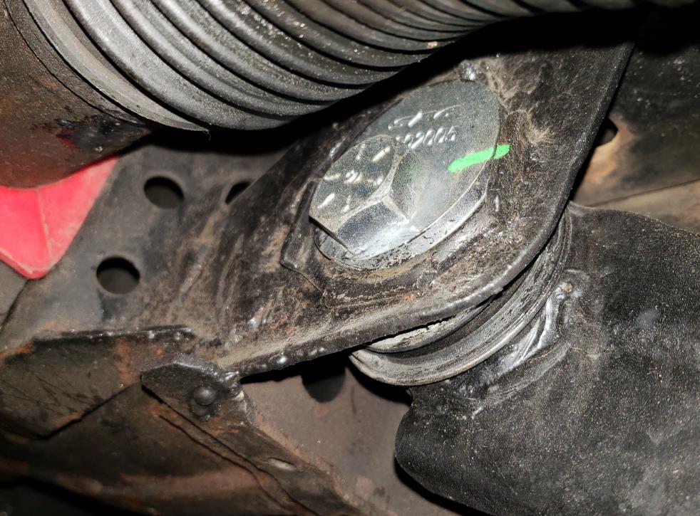

Yea caster and toe were way off before, toe is fixed now but it doesn't look like they did much with the LCA cams. Snap a Pic of the alignment cam bolts, mainly on the rear of the LCA, it should be maxed out or close to it to achieve proper alignment with 3" of lift.

Your Left Caster is still off. Look at the SAI also. Something is still off on the left front. It looks like they may meed to adjust the upper caster setting on the upper control arm.
This chart I attached says its a bent Knuckle or lower control arm. Our suspension is a Short Arm/Long Arm setup, so refer to that chart.

Tough in the dark again, but maybe this helps?
That tells a lot. The head of the bolt should be all the way to the outside of the tab, not straight down like it is. It being all the way out would push the control arm out and forward, giving you negative camber (a little, usually. 5deg) and the more caster you need to improve drivability. A different shop would be my next step.
