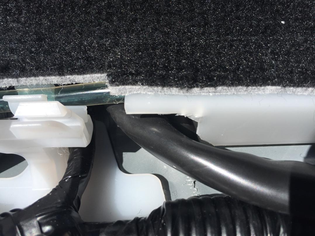

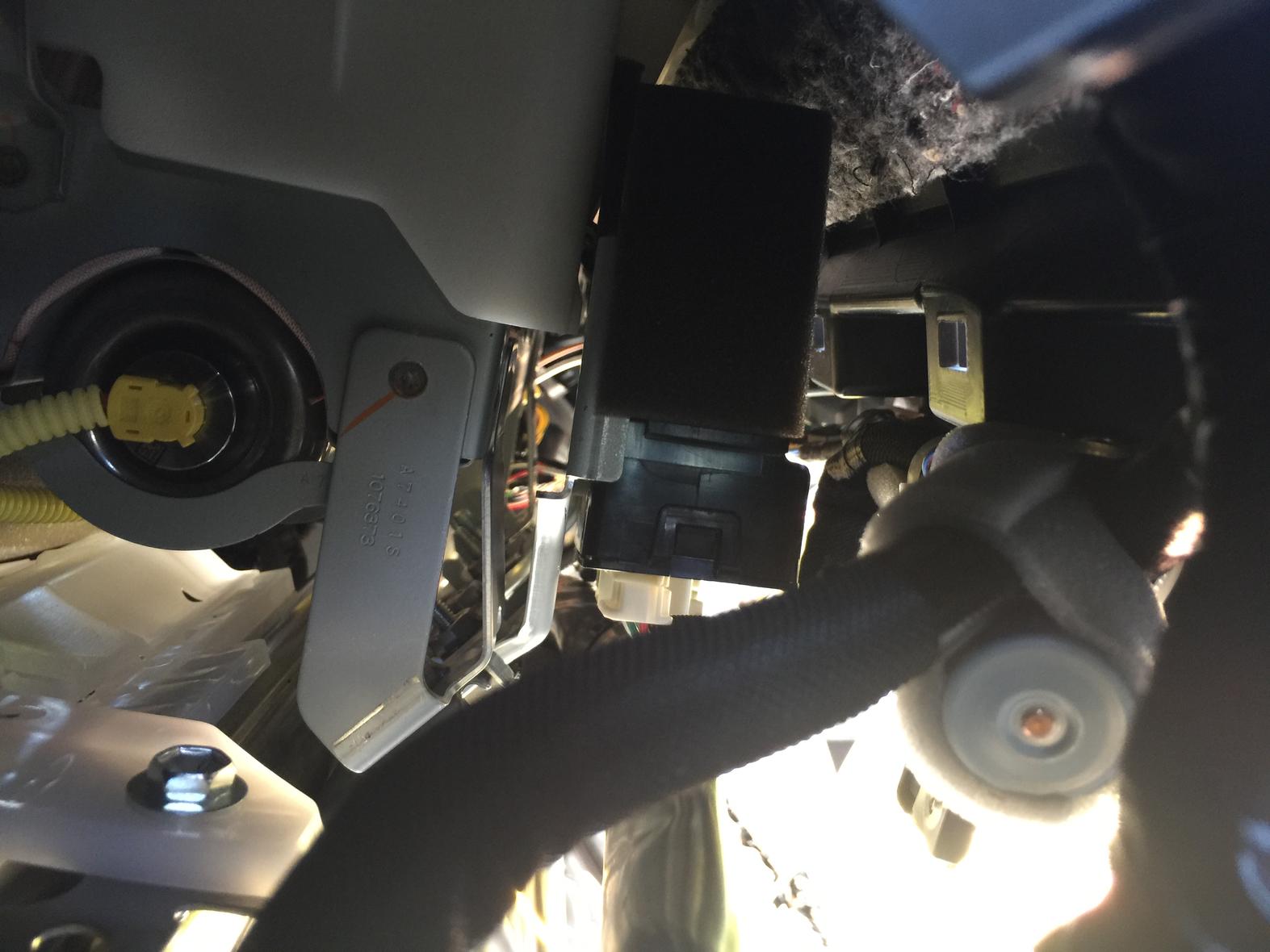

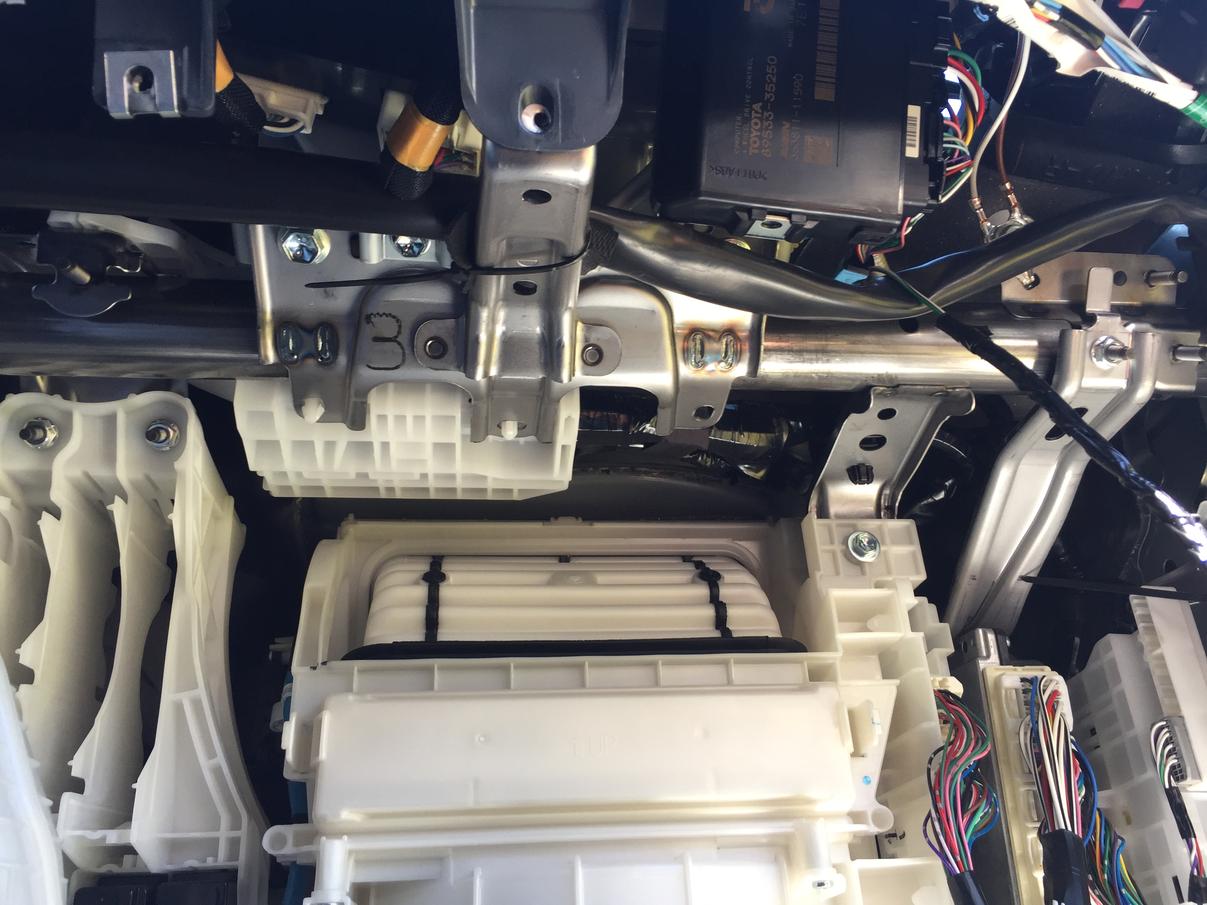

Received the Reference system about two weeks ago but finally got around to installing it in my Pro. I could not get the harness through the dash unless I removed the glovebox. There is a module in the way so that tunnel is blocked. Removing glovebox added about an hour to the installation process. Another deviation from the installation video was I routed the harness under the tube that appears to be for the washer fluid for the rear window. I didn't want that getting linked with the harness testing on top of it. Also cut the white plastic around that area to allow the harness to have a better bend. The biggest pain was reinstalling the rear door cards, I ended up spending over an hour and half on rear door speakers. It was difficult getting the top channel to fit back over the sheet metal. Entire installation took me about 5 hours.

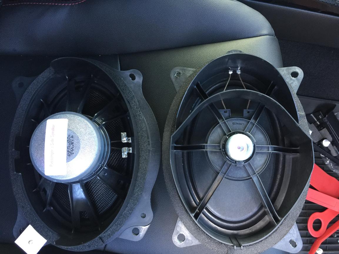

Also I couldn't believe how cheap the stock speakers were compared to the replacement units. The magnets were like the size of a nickel.

Received the Reference system about two weeks ago but finally got around to installing it in my Pro. I could not get the harness through the dash unless I removed the glovebox. There is a module in the way so that tunnel is blocked. Removing glovebox added about an hour to the installation process. Another deviation from the installation video was I routed the harness under the tube that appears to be for the washer fluid for the rear window. I didn't want that j
Getting linked with the harness testing on top of it. Also cut the white plastic around that area to allow the harness to have a better bend. The biggest pain was reinstalling the rear door cards, I ended up spending over an hour and half on rear door speakers. It was difficult getting the top channel to fit back over the sheet metal. Entire installation took me about 5 hours.

The top channel can be removed from the door card. I had the same issue until I realized this.

Whatever that module is, that must be the same reason I couldn't snake the harness through. When I sent the pics to OEM A+ they said they hadn't seen that configuration with their test vehicles.
Does anyone know what that module is? I know OEM A+ wants to know so that they can adjust their installation procedures accordingly now that there has been a couple of cases where people were not able to route the harness following the original instructions. I went a totally different route through the dash rather than remove the glove box.
It's a computer for 4wheel drive control. Took a photo while the glovebox was off.
Edit: Included side view looking into tunnel from radio side.

That's odd since the installation video didn't seem to show that ... and when I spoke to Daniel he said they had only seen the configuration with the channel relatively open and clear. I can't imagine they only did installs in 2wd models?
IM wondering if the Target vehicle they used was an SR5 and maybe the extra box in there is for A-Trac or Crawl Control (OEM Audio Target vehicle didn't have)?? Just a thought

I provided this information to Daniel at OEM Plus and he passed this into his staff. He is very responsive to input from his customers.
