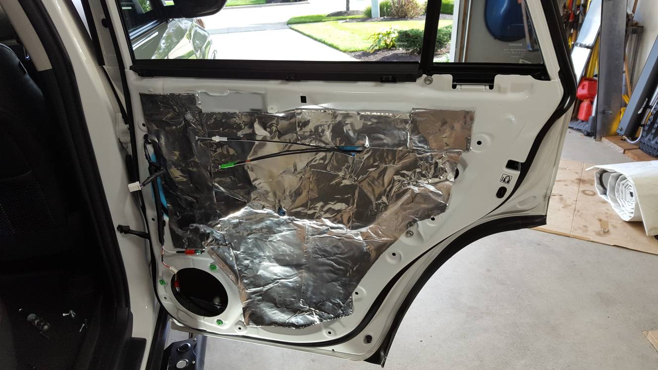

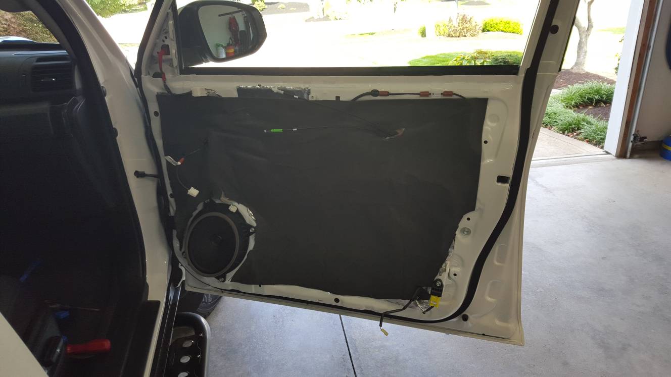

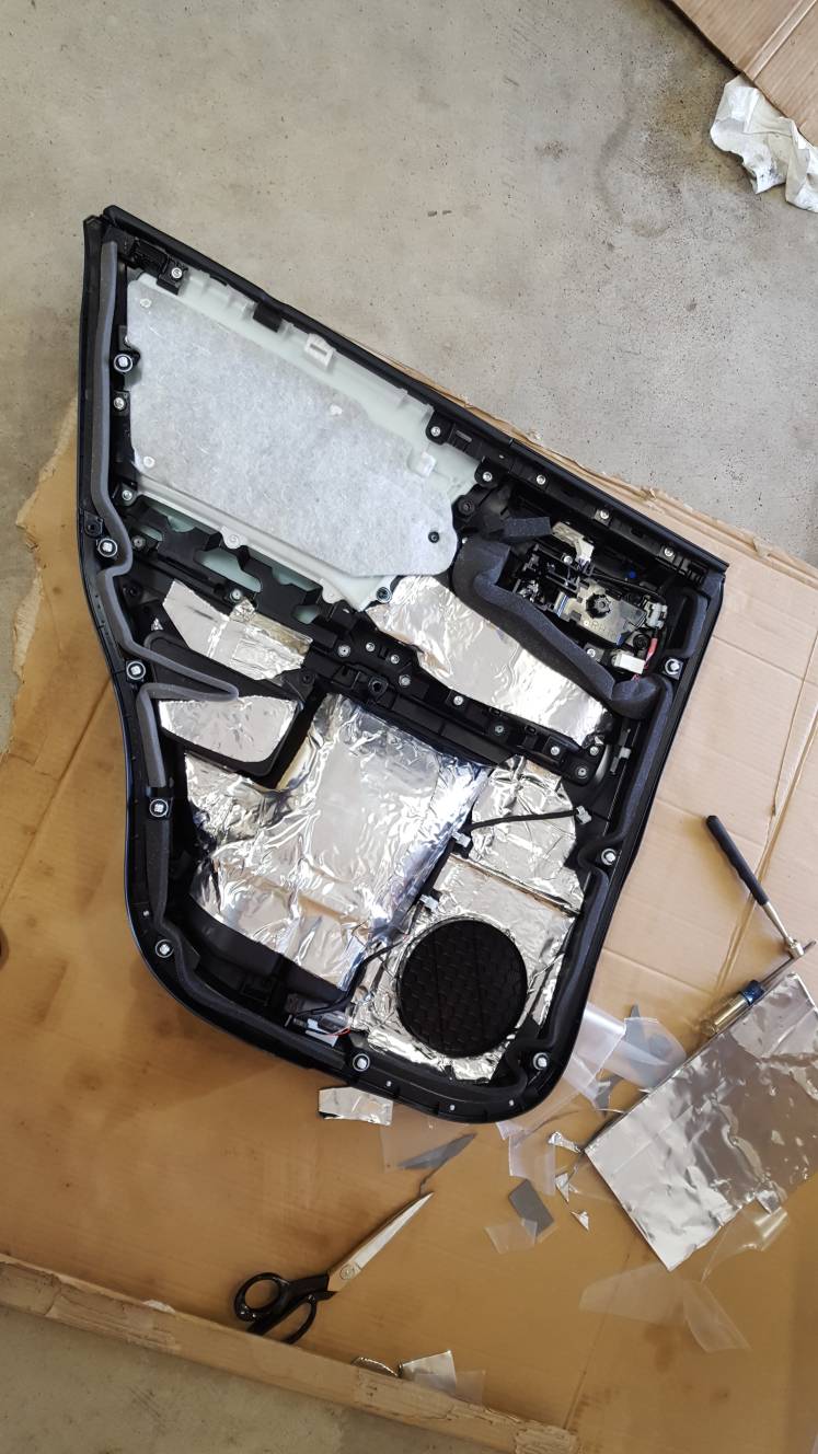

Last weekend I installed my OEM Audio Plus 500Q system. I started the install by finishing up my sound deadening project from last fall.
I completed the rear cargo area up to the rear passenger door well. I covered all the bare metal surfaces I could get to easily and covered the floor area with a layer of Ensolite. All my deadening materials were purchased from Raam Audio. It is a putty based covering with the standard foil facing we’ve all come to expect. The Ensolite is like a yoga mat that is self adhesive. Last fall I used the products in all the doors and the rear hatch. Behind each speaker I used 2 layers of Raam Mat and one layer of Ensolite as described in their install guide. Each door took about 1.5 hours to complete. I covered as much bare metal as I could reach.

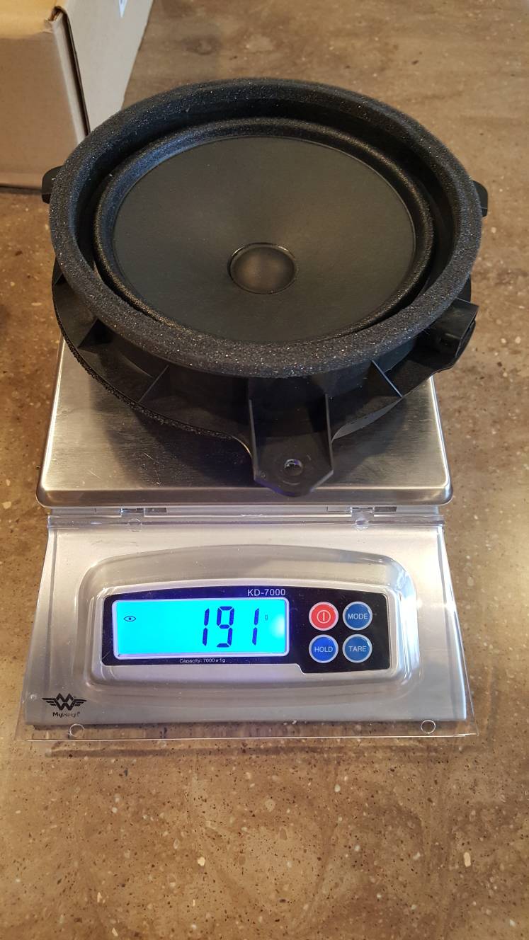

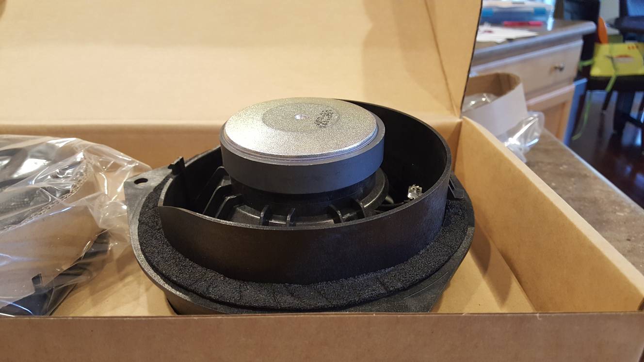

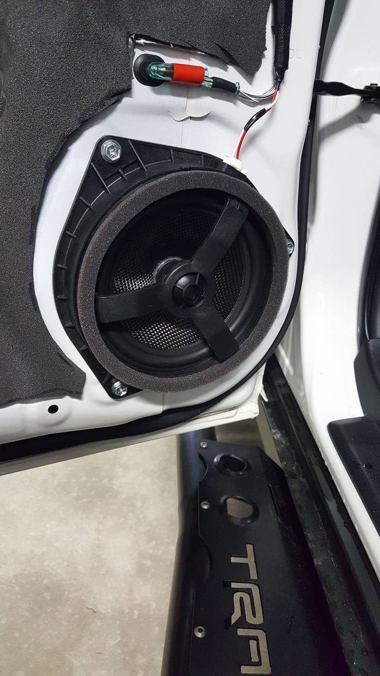

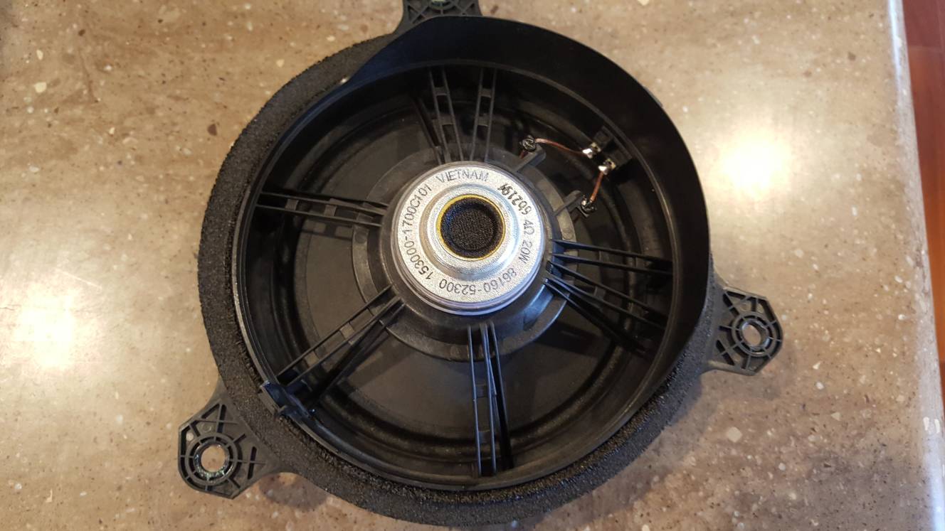

On with the install. I am always fighting time, so Wednesday morning I installed the rear hatch speakers, rear doors and tweeters. I was taking my time, being careful and it took about 1.5 hours. The front driver and passenger doors took about 1.5 hours total. The speaker wire hook up location is on the side, as these speakers are from OEM Audio’s Tacoma system. Trying to separate the wires from their original bundle was a bit painful as the wires are all very small gauge, so going after the tape with a knife could have easily caused a nick or two. After those were finished, I was out of time for the day.
I listened to the new speakers with the stock head unit for 2 solid days. If I didn’t have the amp and sub sitting in a box already, it would have been pretty easy to say the upgrade was complete. The difference was night and day versus the stock speakers. There were actual clear vocals, real bass and a clear midrange. It lacked a bit of punch with no amp or sub, but it was still much better than the stock system.
This wasn’t the end of my journey, so Friday morning I started the rear sound deadening. I installed the rear sub wires as I was buttoning up the rear panels. It was pretty easy as everything was out of the way. I then proceeded to tackle the amp and DSP (digital signal processor) install. They are one unit that mounts under the passenger seat on the provided bracket. This is where I hit my first snag. It had one large gate style connector, not the two separate ones shown in the install video. The amp was oriented so that the plug was on the inboard side, not outboard as shown in the video. After figuring out the bracket needed to mount on the left side springs, not the right ones, I got it mounted. There are 2 holes in the seat frame. I ended up using the left hole that was elongated. The video shows using the hole on the right that is round. The amp wasn’t straight using the round hole, using the left hole made it all straight and correct looking.

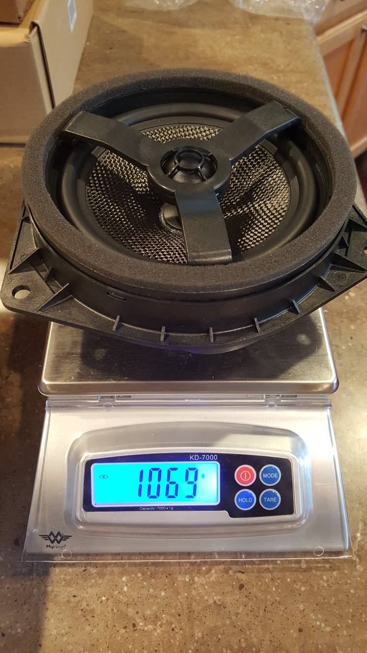

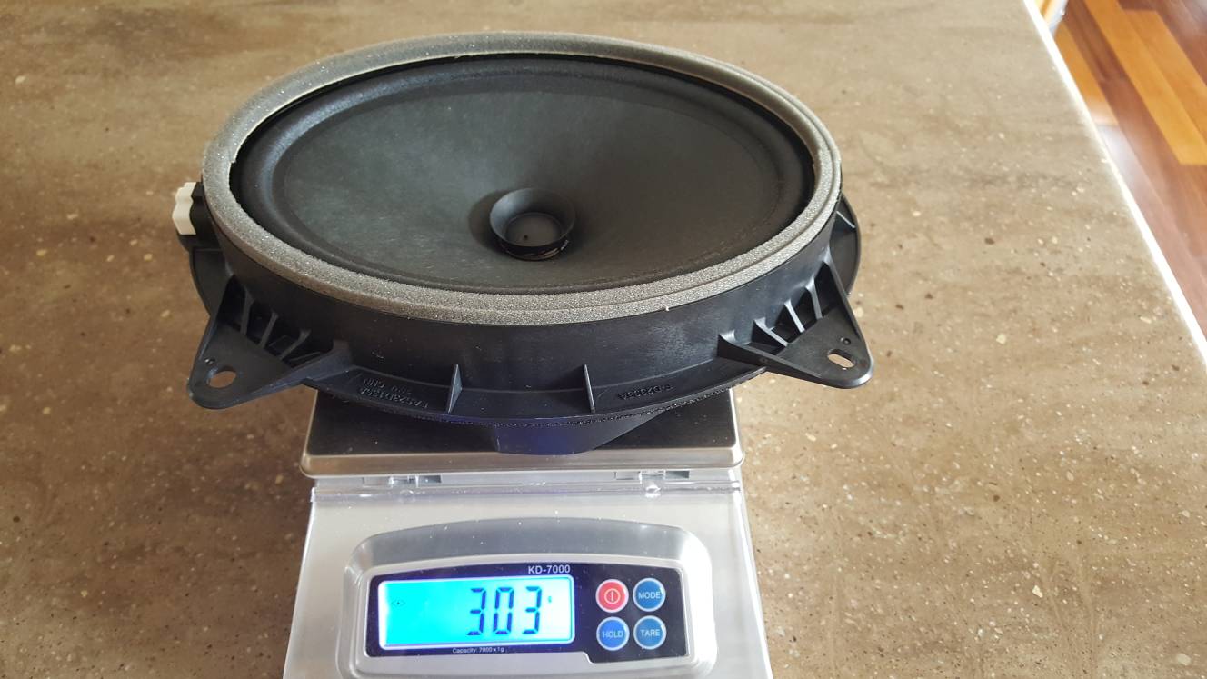

Now on to the good part. What does it sound like? Was it worth the price and install effort? We'll get to that in a minute. Backstory, I’m a home audio guy and have been for the last 20ish years. I have a dedicated listening room filled with audio gear that makes me smile and my friend’s jaws drop. I feel like I know good audio sound. I understand that environment is everything and good components are only as good as the time and effort you spend to make them work in that environment. You can throw great components together in a “system”, but it rarely translates immediately into great sound. I’ve tried that, it doesn’t work!!
OEM Audio Plus has done a terrific job of taking a harsh listening environment, a vehicle, and have made it a much more enjoyable. Does it compare to my home audio set up, no it doesn’t. My home system is worth more than my 4Runner was brand new. I could not expect it to sound the same, and I didn’t expect it to. I'm not after perfect sound in my truck. I have better things to spend my money on that will get me out in the wild. The radio is something I listen to every time I use the truck. I have never upgraded a stereo in any car before. This system was beyond miserable and I did not enjoy in listening to it, even for talk radio. So, what’s the final verdict? I absolutely love the sound quality of the new system. I’m not 20 years old, so I don’t need to bump down the road. All aspects of the music are clean and controlled, undistorted and a pleasure to listen to. There is an actual soundstage now, and it’s difficult to identify individual speaker locations in the vehicle. These are all qualities of a well put together audio system. This is an upgrade I get to enjoy every time I drive somewhere. I now sit and finish songs even though I’ve reached my destination. I never did that in the past with the 4Runner. I would do this upgrade again without hesitation.
What are the negatives? I feel like the system could use a little more low volume punch. Around volume level of 20, the system really starts to cook and around 30 it really comes alive. OEM Audio suggests you set the factory EQ to flat, neither plus nor minus in any categories. I have listened for a solid week and cannot get to that setting. It may be my sound deadening. They used a stock 4Runner with no additional sound help to develop the system. My sound deadening had some effect on the sound because the stock speakers sounded better after I installed it. The good news is that the amp and DSP can be adjusted for my preferences and conditions. I may do that in the future, but not now.
I’ve learned audio isn’t a sprint, but a slow walk up to your desired result. It may take a few months for things to burn in properly. Making changes before really learning what is happening is just wasting time in my opinion. I’d install this system again in a heartbeat. It’s worth every penny as it’s developed specifically for the 4Runner by a well regarded audio company. I could have rolled the dice on a local install, but who knows what I would have gotten. A sliced up wiring loom, bad sound, shorts, no warranty, etc. If you’re hesitant to spend the money, reach out to OEM AUDIO to see if someone has the system close to you. I expect 9 times out of 10, it will take you 5 minutes or less to decide that it’s the right path.
I’ll post a few pictures from the steps that I have. As I got into the install I was fighting time, so there are details I didn’t capture with pictures. Sorry, but you can reach out with any additional questions you may have.

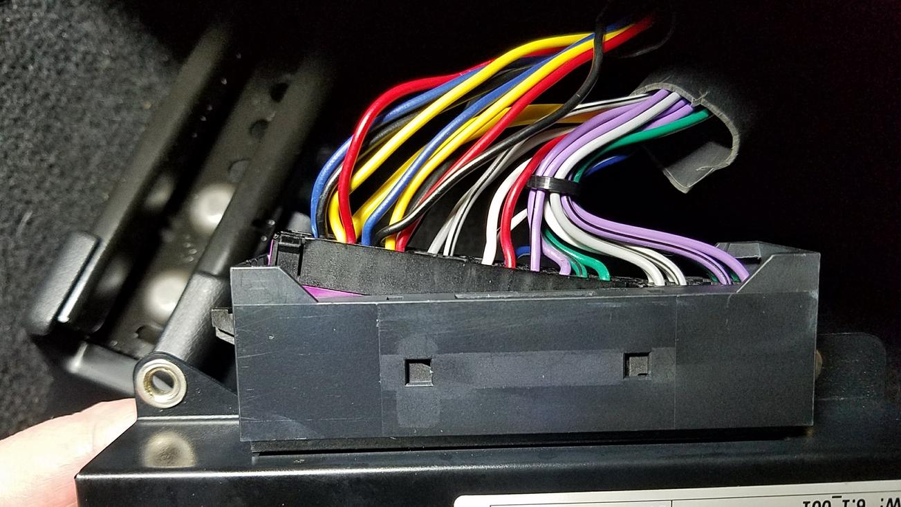

Finished putting in (TYT-4RN2-REF50Q-0900 | Toyota 4Runner | Reference 500Q) which is the "whole" system for the 2 row... and I couldn't be any more happy.
I had one hang up as the video's all show one kind of connectors going to the amp and I (you would too with the 500Q) received a different connector type... and it kicked my butt. I just couldn't get the connector to go on to the amp. Then with a bit of force (i.e. mistake) it snapped on. I fired it up and everything was a go except the subwoofer. All other speakers were good as gold, but no signal at all to the subwoofer.
So I texted the customer support guy (Daniel La Blanc with OEM Audio +). Mind you it was at 9:24 pm Sunday night. I was only trying to get first in line on Monday to explain my ongoing saga... and unbelievable he texted my back at 9:34 pm! Now, I know that some say this system is overpriced, maybe - maybe not... what I am here to say is the customer support I received during the install is second to none. Every f'ing time I needed my hand held they were there... they even made me my very own youtube video (Monday morning) explaining what I needed to do to "fix" what I had done to the plug... and for that my money was very well spent... and the damn system rocks too!
The internal part of connector (outer cover removed) pushed upwards after I put it on...
https://youtu.be/92o9PY2FiY0
What was wrong with the connector to begin with... and the fix.
