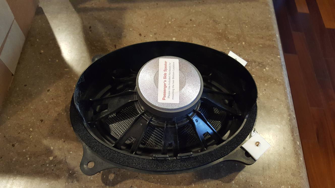

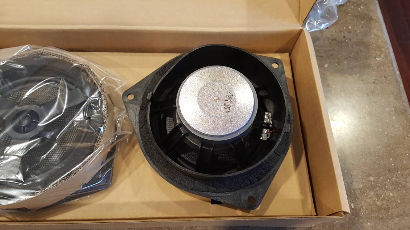

OK, here's my 6x9's... pretty dramatic the diff in size of the magnet huh?
My other ones look same as yours....
Guess I can't speak as to performance until I actually install my setup, but [MENTION=226993]metalrex[/MENTION] has same as my 6x9's and seems like thsee neodymium speakers might not balance out with the the other four coax speakers... especially since your 6x9 is traditional large magnet like the coax ones. Daniel at OEA+ says they use the neodymium 6x9's to increase performance and cut down on install size. Seems odd to me since you didn't have a problem with how big your 6x9 magnets are in your door mounts? Perhaps they changed them for other rigs with more shallow doors or to avoid the windows when rolled down? Who knows.
