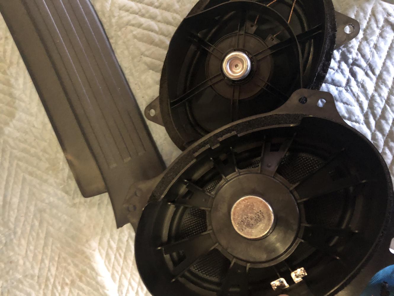

I couldn’t agree more. I had this system in my Tacoma and it rocked! In my 4Runner not so much. Not sure why your tailgate speakers don’t have tweeters, mine do. Also my front door speakers have a much smaller magnet then the 6.5s, my Tacoma fronts had the same size as the rest. The lack of tweeters in your tailgate makes me wonder how “optimized” there systems really are. This system is kinda low on power/watts total. Maybe it works for the smaller volume of the Tacoma better then the 4Runner? Overall I’m happy with the system but makes me wonder how much better it could have been with $$$ spent on something else. The pic is stock front door magnet vs theirs. I don’t have a pic of the rest but they’re about 5x larger

Did I install incorrectly?

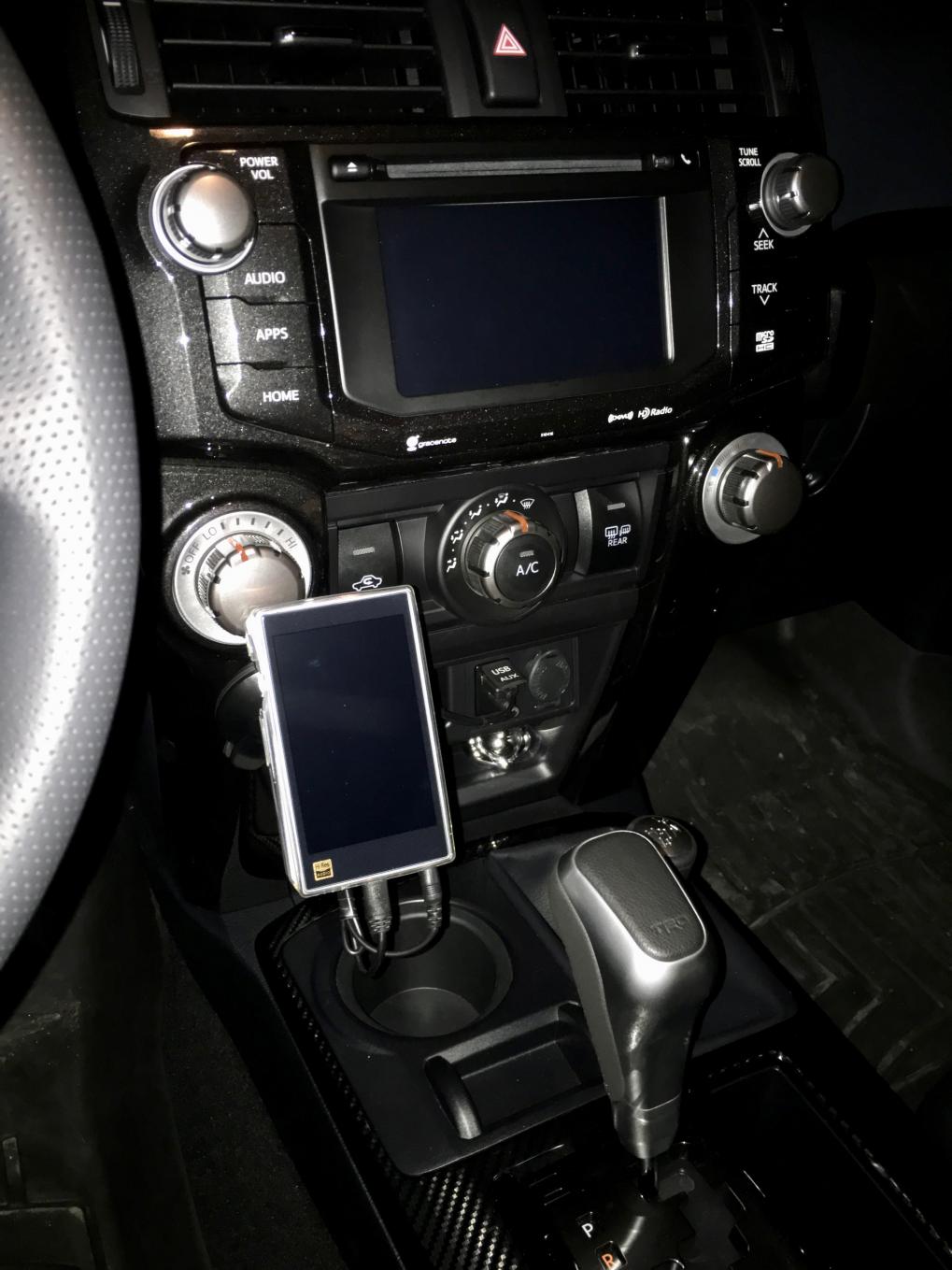

Holy Crap!!! OEA+ setup to next level....
OK, so my OEA+ setup was sounding 1000 times better than the stock 4runner audio setup even with crappy FM radio or compressed sources like MP3 on USB. CD was really nice but a pain to swap out CD's, then it occurred to me I had another possible audio source. I enjoy listening to HQ headphone Audio at home on my Masters & dynamics headphones with my little AStell & Kern FLAC audio player MK70 Mk2. I was talking to a tech at IRIVER who suggested I could use the MK70's superior dual DAC to create a better source for the 4runner stereo by switching it to line out and using a HQ 35mm cable in the 4runner Aux jack. So, using it this way means you don't get the album/artist info on the 4runner screen.... BUT holy Cripes it blows away anything else I've heard in the 4runner … EVEN CD Audio. CD audio and FLAC sources are roughly the same lossless audio but the FLAC player sounds WAY better because its electronics for converting digital media to analogue are far better than the electronics in the 4runner audio system. I have now officially converted my 4runner into something very close to my headphone experience believe it or not. Anyone else owning a FLAC player like this that has done the O+ upgrade I strongly recommend you give this a try. Have the same song on USB MP3 source, Audio cD and on the FLAC player over the Aux input. Switch back and forth between the three sources and you'll be amazed how much better the FLAC over Aux sounds. Sorry if this is old news to some of you but it was a revelation to me. Very Very Happy!
Cheers JC
Cheers JC

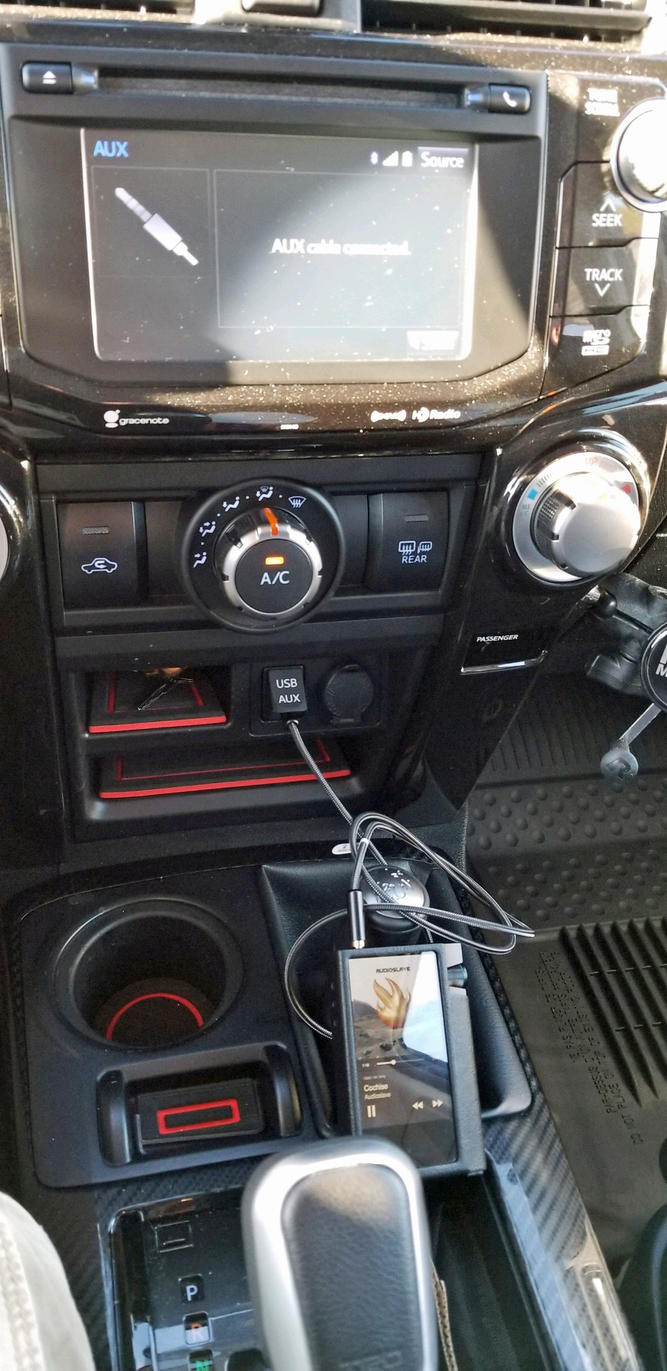

Cheers JC
Ditto. I posted the same review. Using Fiio X5 with OEM+ via AUX... unmatched quality over any other sources.
