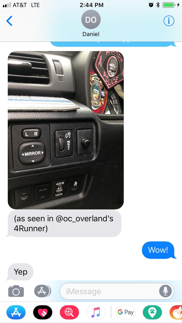

Where did you end up installing your gain control knob? I was thinking of tapping into the blank located here for easy access...how often do you find yourself adjusting the gain control knob? Thanks!
I still have it just sitting loose in the glove. Did Daniel send you this YouTube link showing how they affixed it to the top side of the glove box?
https://www.youtube.com/watch?v=23qzriK6mls&feature=youtu.be
Not sure I would do it this way vs just 3M doublestick or something but I haven't finalized it yet because I am still troubleshooting the hum and pop issue with my sub amp/enclosure and didn't want to tie anything else down until I am sure what needs doing with that.
As for how much I mess the gain, not much. I have played with it but found that 75%-ish works to my liking on most music so have just left it there. Because of the omnidirectional nature of low frequency and the way the setup is tuned, the bass just blends really well and doesn't stick out or anything so I found the gain knob is really a subtle adjustment when listening from the driver seat.
Because I can't see myself hardly ever adjusting it, I wouldn't put it out in plain sight like in that picture you attached, but that's just my preference.
