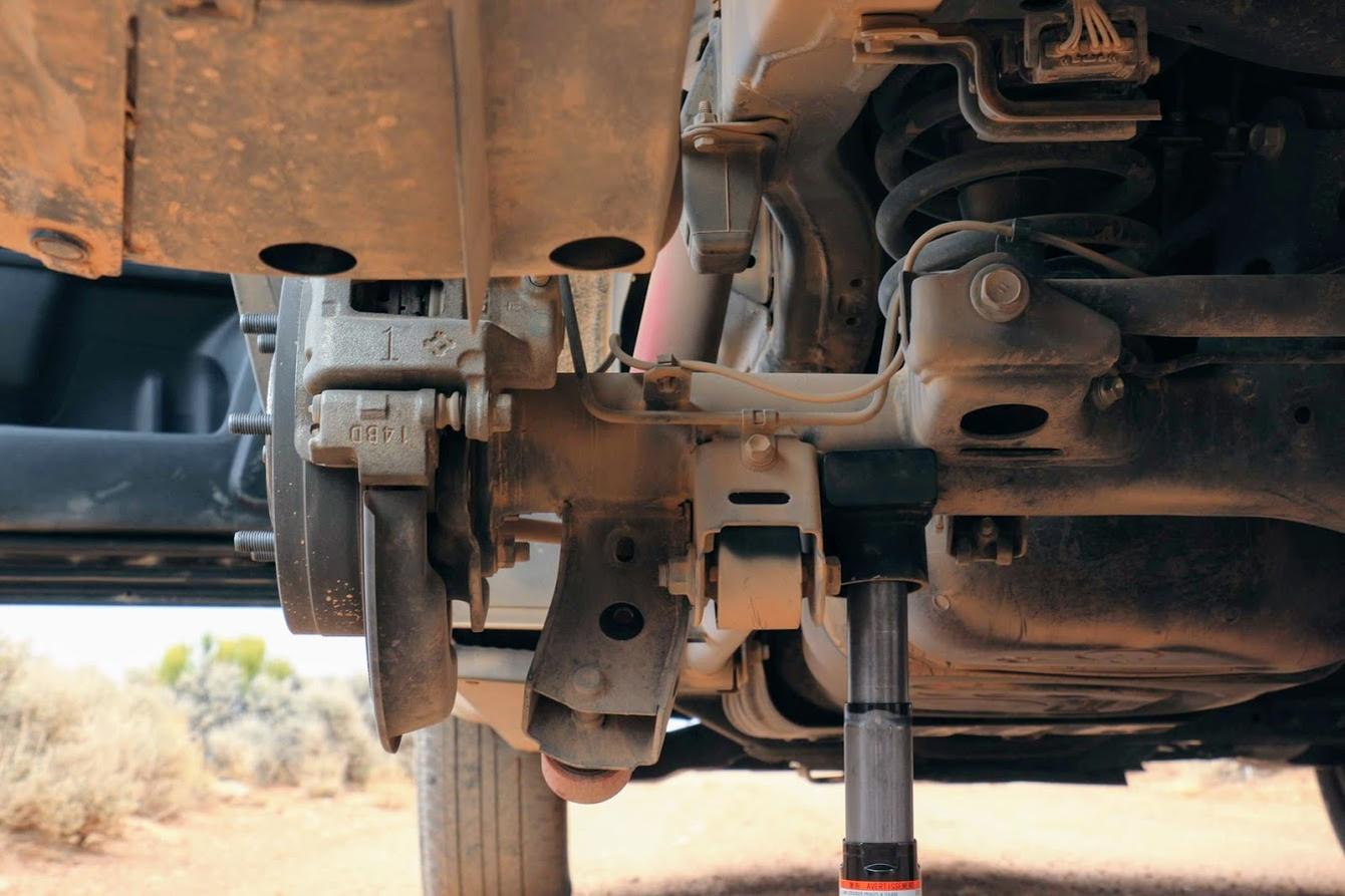

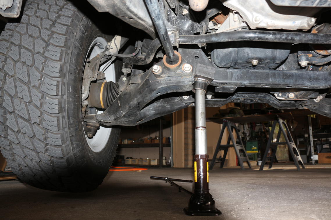

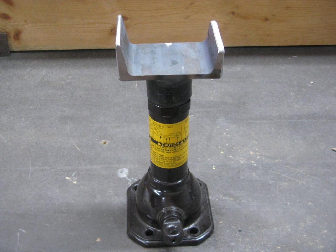

Depending on how high you need the jack to go, any 6-20 ton bottle jack will work as good enough oem replacement. I carry a 6 ton bottle jack that I got off amazon & some bottle jack extensions from Safe Jack to compensate for my lift.
Do you keep it in the factory location? I'd be worried a hydraulic one like that would leak if stored on its side.
No because i still have my oem jack there but it does fit in the stock location. I carry it in small tool bag that's dedicated for tire stuff & I do have it on its side and it doesn't leak. Aside from some type of part failure, the only time I've seen bottle jacks leak is if the adjustment knob isn't tightened to where it's snug.
