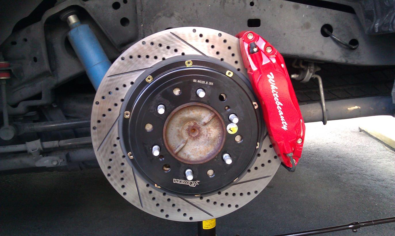

The best combo for me is: EBC 3GD sloted and dimpled front rotors, Hawk LT front pads and new front callipers that are not frozen. I can stop my 4500 lb beast with larger 165/70/17 tires on a dime now. Huge difference. It was the best investment on any upgrade so far.
:cheers:
