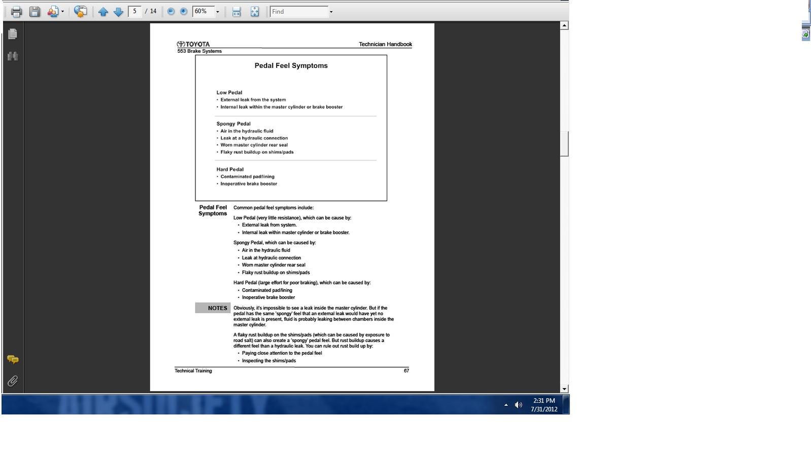

I'm trying to see how I can get an image on here from my computer from a *.pdf file, but in short, SunGod can suck it. I'm done with this arguement. Good luck with your backyard mechanics.
Straight out of the Toyota brakes course training book (which itself is a couple hundred pages big). I had to go digging in my training manuals for this one. Although I can't wait for the next response.
"All you did was look that up! You're still a grease monkey because I said so! I'm never wrong! Go back to your oil change station boy and turn your left handed cresent wrenches! I work at Autozone and know everything!! My daddy taught me how to work on cars and he never said anything about this so it can't be true!" :cry2:
