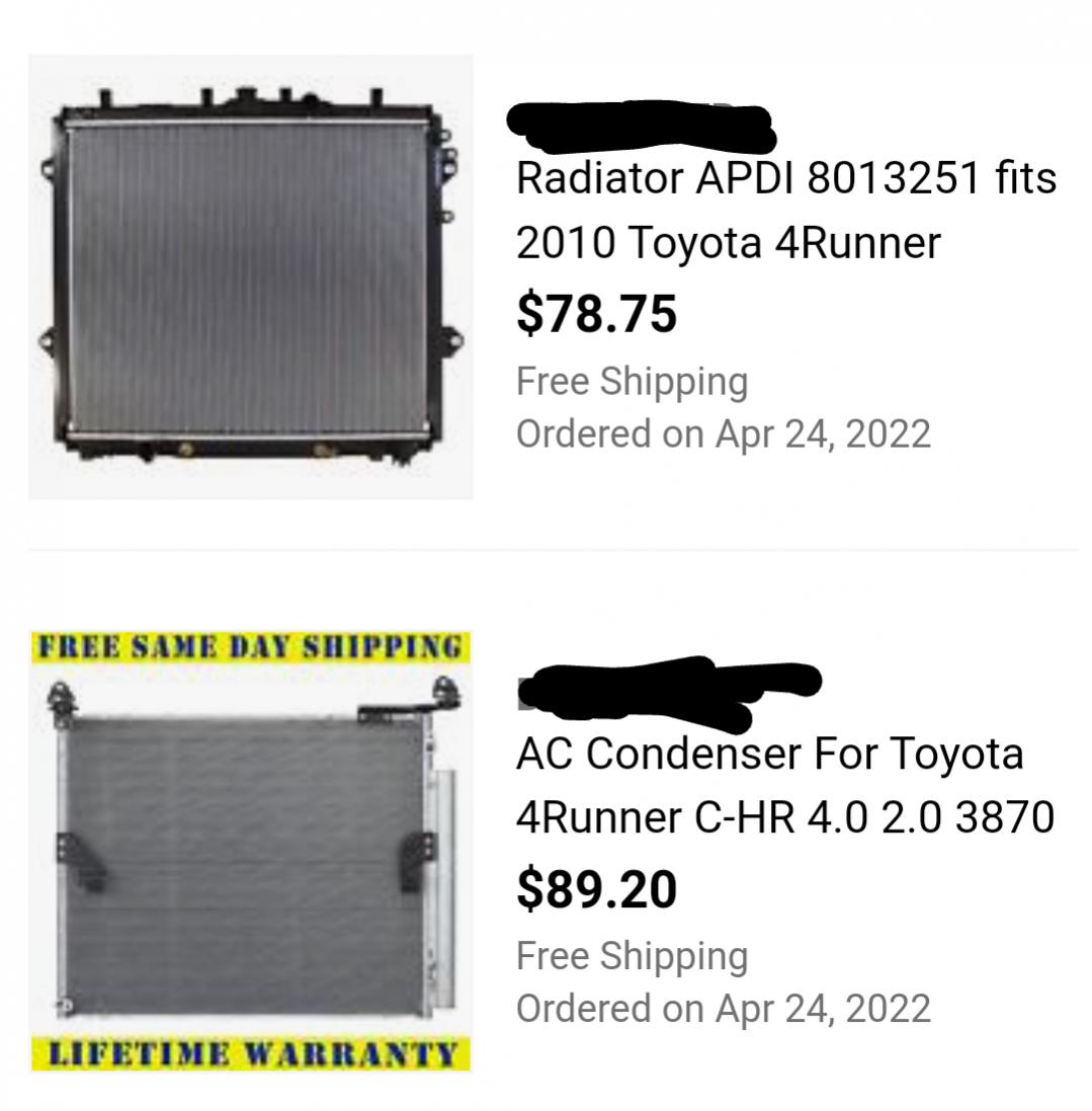

Radiators aren't that complicated and the process of manufacturing them is generic. I took a chance on eBay. Both the radiator and condenser were exact matches. The radiator even comes with the side mounting pieces included. Those cost a lot extra if not included. Keep the old stuff off your old radiator that disconnects. The cap and the cooler line connections weren't included. I saved quite a bit and it's all the the same..
