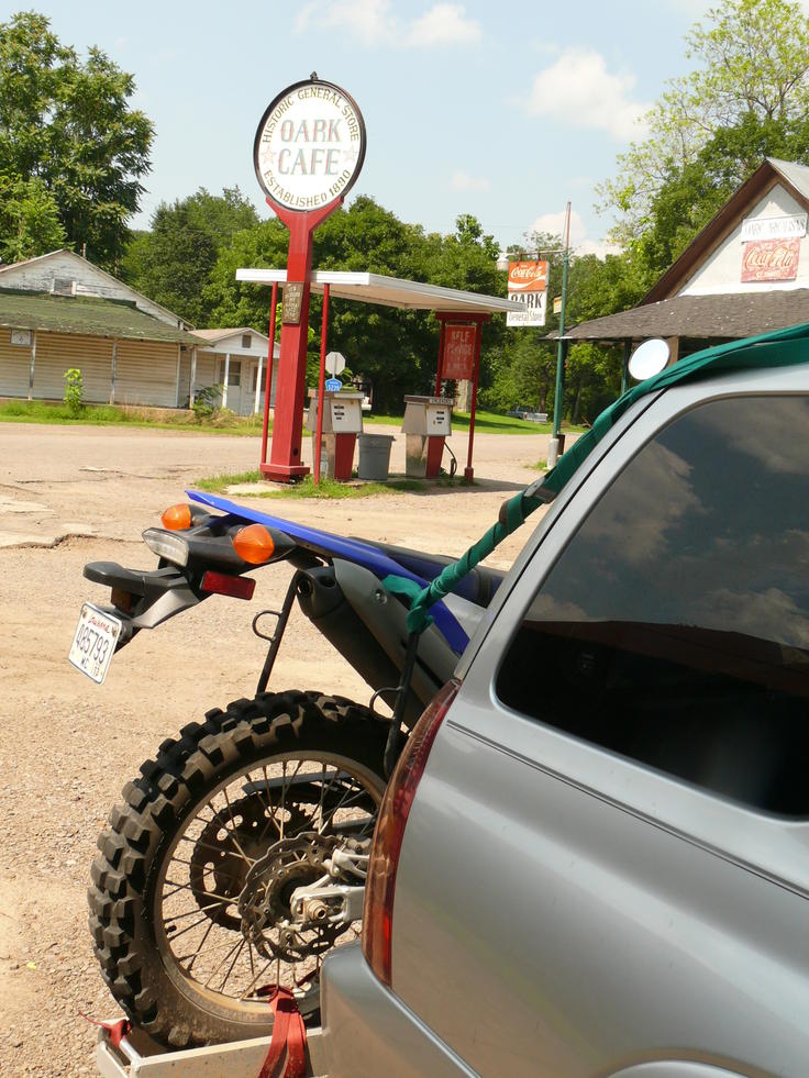

I carried a Yamaha WRR250 all over Arkansas a few years ago on a carrier similar to this:
Lightweight Aluminum Motorcycle Carrier - The AMC-400
I loved it, worked great, so easy. Used the handlebar straps downward like usual, and tied down both wheels. But for safety's sake, I added my long kayak straps on both sides the bike up to back roof rack on both sides. Gave me +100% confidence that bike would never fall off if something happened. I wasn't trusting it to only those handlebar straps to hold it upright. Oh yeah, and I had a big chain locked to the permanent hitch to avoid theft, LOL.
But I never had any problems at 75mph, and everything rode very well. For 10days I'd unload in the morning, and ride to meet my wife in 4R at predetermined hotel meet about 50 miles away. We both spent the mornings cruising separately and doing our own thing, then meet at midday and do things together until the next morning. One of the best vacations I've ever had !

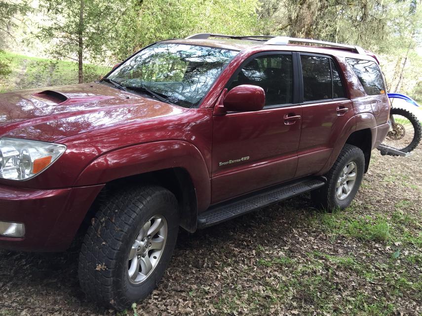

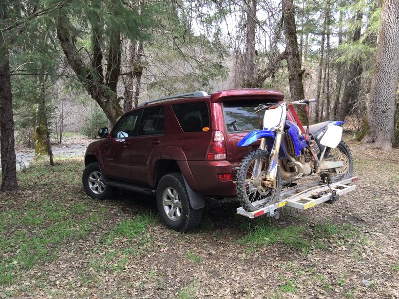

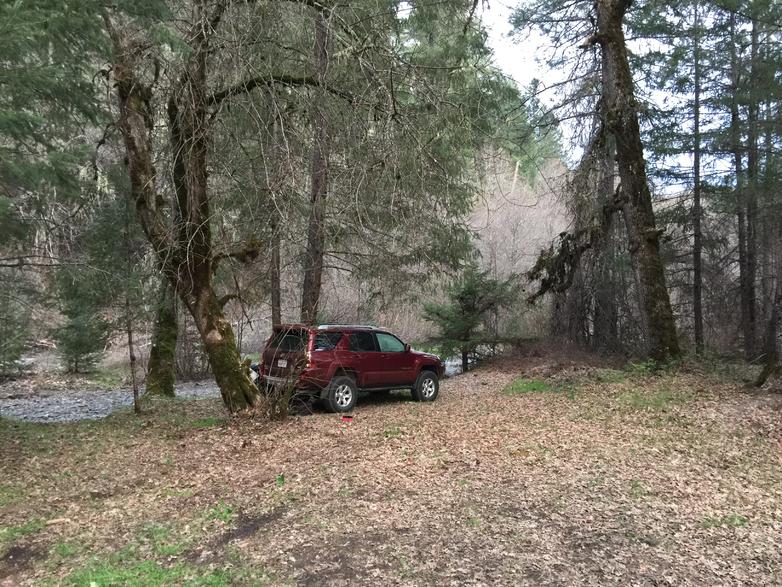

Hey, I took my bike on a 3 hour drive to ride this weekend. About 45 mins on rough fire roads and it worked great. I was a little worried but I made it no problem. I have the heavy toytec springs in the back. They were very plush with the bike back there. The lift and the 285's were awesome. Thanks for all the responses.
