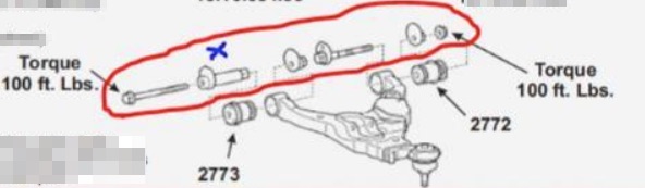

The most difficult thing is making sure I have the right bolts. Does this look right to anyone who has done it?

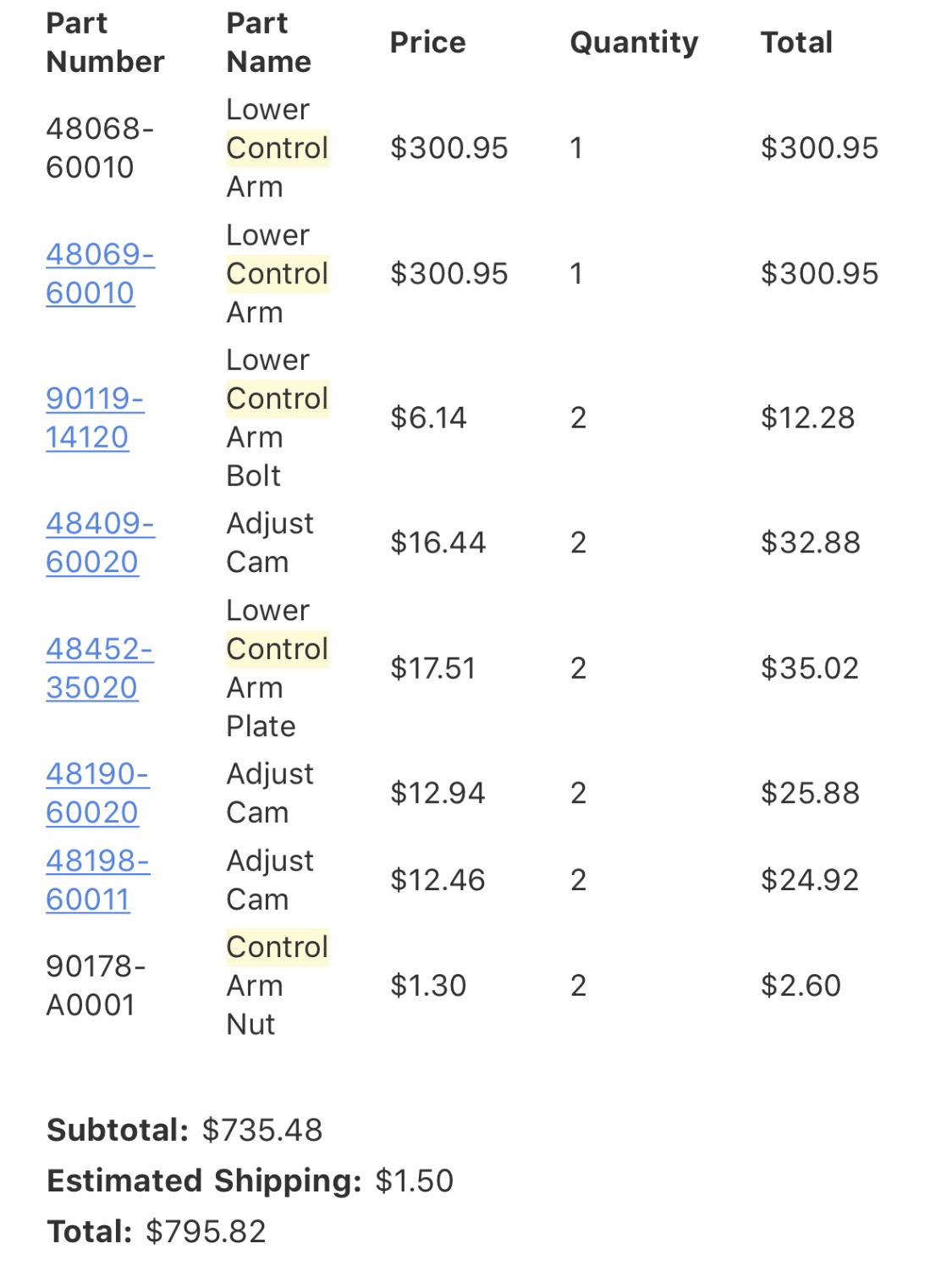

This links to a diagram with parts here from the best priced site I've seen for OEM parts:
Suspension Components for 2008 Toyota 4Runner | Boch Toyota South
$290.66 Lower Control Arm Part #48068-60010
$290.66 Lower Control ArmPart #48069-60010
$9.38 2 x $4.69 Lower Control Arm Bolt Part #90119-14118
$1.26 x 2 Lower Control Arm Nut Part #90170-14026
$1.37 x 2 Lower Control Arm Nut Part #90178-A0001
$9.52 2 x $4.76 Lower Control Arm Mount Bolt Part #90105-14104
$23.20 2 x $11.60 Adjust Cam Part #48190-60020
$29.48 2 x $14.74 Lower Control Arm Adjust Cam Part #48409-60020
$31.44 2 x $15.72 Lower Control Arm Plate Part #48452-35020
Borrowed the attached diagram from one of the rebuild threads, I want to make sure I have the items that are circled.
I'd appreciate any help you can provide. My rig is riding real bumpy on the highway, feels like a constant tremor. Bushings & ball joints are bad. 96K on the dial, 2008 V8 Limited.
