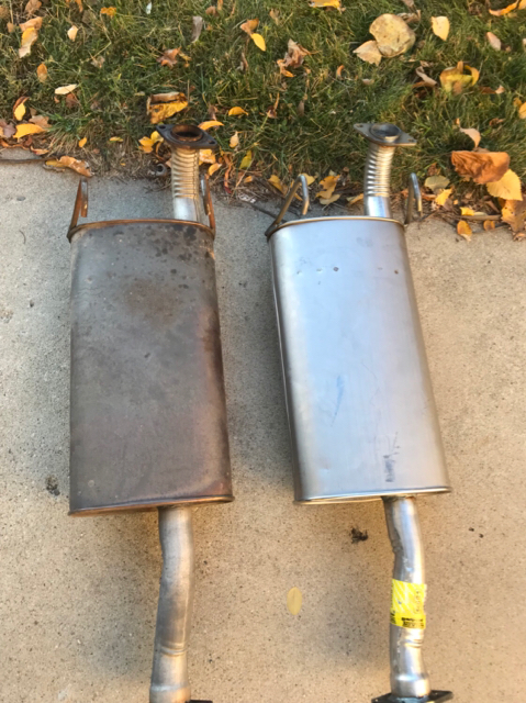

Hi All,
I had to replace my OEM muffler just over a year ago with a Walker Quiet Flow. The Walker has since developed a rattle and is leaking. They have a good warranty and are sending me a replacement.
However, I was able to find a used OEM muffler locally off of a 2000 federal emissions type. I currently have the Cali emissions 4Runner. Do the federal mufflers have the same placement of exhaust hangers as the Cali type? They look pretty similar based off of pictures from Toyota Parts websites.
I really like the idea of having the OEM quality and understand that I'll have to commission a local muffler shop to cut the front of the pipe and weld it the the cat.
Thanks,
Dan

Hangers are the same.

Thanks for the recommendation. I’ll have to take a look. I’ve installed the replacement muffler with some new exhaust flange gaskets and it sounds much better now. No more rattles and leaks! Hopefully the replacement will last longer than one winter.
The Walker is pretty quiet but is not as quiet as OEM.
