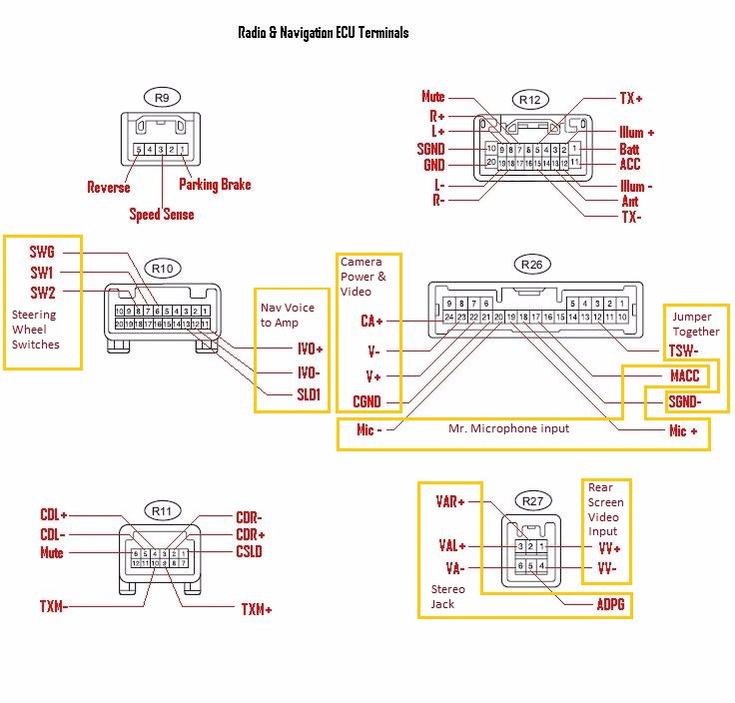

The Aux jack doesn't seem to be compatible with some E700x unit for whatever reason. I could look as some pinouts to see if an "aux audio in" exist, I'll report back.

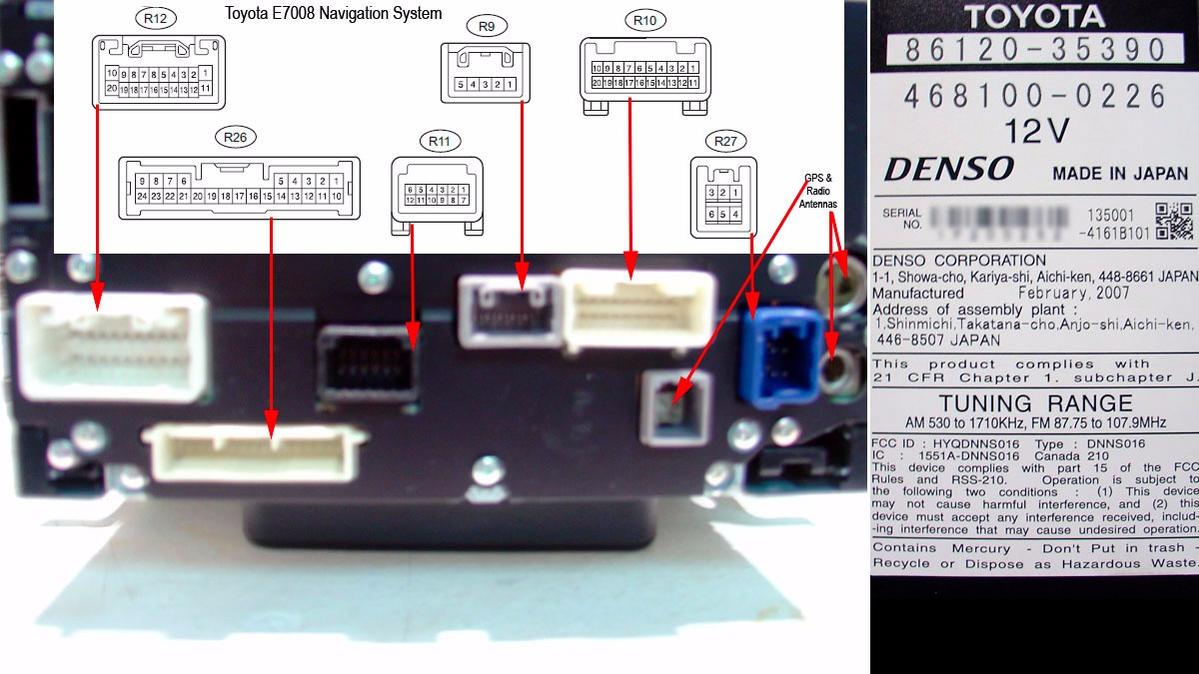

The way I read it, the "stereo jack" is your 3.5mm input.

[MENTION=30225]yosh2000[/MENTION] for the win! So then [MENTION=125058]06t4rltd[/MENTION] , there ya go! (R18, pins 2,3,5,6). Not sure how to connect that to "input". Not widely reported IIMC, so report back if you successfully connect it.
Thanks CookieRoe
I followed your diagram and jumped the stereo jack wires over to the R27 connector pins 2,3,5,6. Aux now works fine.
FYI When I bought the nav unit i also had them cut the harnesses for the HU and send them to me.
Next is mic. After installing my new overhead console with the poem mic, I hooked up the harness and followed that wire bundle down behind the dash right above the driver footwell.
I found the male harness taped up not plugged into anything. So I cut the harness off and ran those wires to the corresponding mic pins 20,19,17. Mic now works but I have no voice coming out of the speakers.
From what I have read, nav voice to amp should give me the capability to hear the person talking on the other end. So I ran those wire back to the amp to harness S11 pin, 22,23.
No luck yet, still not getting a voice for nav or bluetooth calls. Anyone have any ideas??
Quick update. I got the voice out working on pin 22,23 on the amp. Sounds great! So bluetooth is completely functional. Next step is the GPS.
