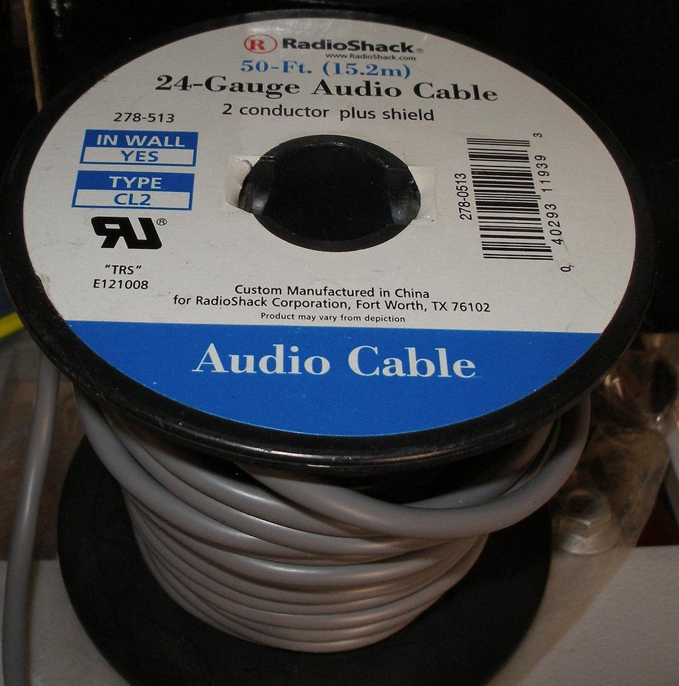

the amp is in the trunk on the Passenger side, there is a whole manual on how to get to it - don't try without reading it or you'll break a bunch of plastic...
and yes it's 2 wires + shielding that you need to get through.

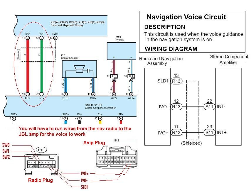

now i need to find the wiring diagram. lastly I hope that 20ft of shielded stereo cable from Radio shack should do the trick.

I put together a little diagram for the nav voice when I was hot & heavy doing mine. Hope it helps.
Gorgeous! About the shield - do you take it and put in the pin on the HU side but leave it dangling on the Amp side?
Thanks
Thanks
Yes, you want to connect the shield at the HU, & run the shield all the way to the amp, but it'll float (not get connected at the amp). Use heat shrink (or tape) to cover it to make sure nothing shorts to it at the ends.
No luck and i checked everything twice. BTW there is a typo in you excellent diagram: if you notice, in the diagram below you have IVO+ going to pin 22 when it should be going to pin23 (as shown in the diagram on the right side. In anycase i tried both with no luck.
I am beginning to think that it might now be the amp. I have an 04 jbl amp and this thread points to the fact that i might need an 06 or later amp:

Thanks! Nice catch! :rockthrow:
Just updated it.
