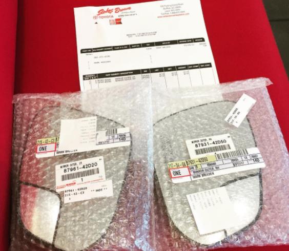

Just to confirm again, these 42D20/42D50 mirrors are from 2016 Rav4? and it will fit my 2016 4Runner SR5?
I asked my friend who is a Toyota tech to look up his system. He confirm that we do not have these part numbers in Canada.
When he look up 2016 Rav4 side mirrors, there are 18 part numbers, so it should be 9 different mirrors for 2016 Rav4, but non of them are matching the part number on first post.
I just got a price of 80 per mirror here in Ontario Canada at my local dealership. Same part number as listed by OP
(I am from Vancouver, Canada)
My dealer told me the part numbers provided by OP are Japan made and gave me the following North America made part numbers.
87931-0R210
87961-0R220
I have emailed them back to make sure they are exactly the same and will still allow me to keep the heating function. Will update when I get a response.
87931-0R210
87961-0R220
Per my last post. My dealer just confirmed that these part numbers are the exact same as what the OP posted FYI. Just placed my order for them!
Thank you!!!

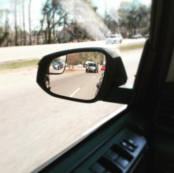

This has been one of my favorite upgrades to Natalia, and it was much easier than I thought it would be. I installed these on vacation in South Carolina in the dealership parking lot where I bought them.
87931-0R210
87961-0R220
I got mine from langley Toyotatown I ordered the two part numbers in the first post and received the same part numbers no crossing to a different number. They took a week to get as they had to come from another distribution center, back East I think.
