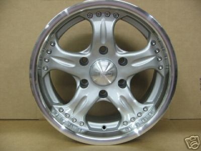

I know the Sequoia, tundra, and some Lexus wheels fit, I love my Tundra's. What other OEM rims fit on the 3rd gen? Share pics, don't have to be Toyota's either.
Mine, just to get it started.
DSC06264.jpg~original
some use FJ Cruiser
you want stock I presume so that would be 16 x 7 JJ
bolt pattern is 6 x 5.5
So some guys here or over on Yota Tech run FJ Cruiser wheels.
I've read that some Chevy/General Motors wheels will fit but take that with a grain of salt-some reports indicate the hub diameter is smaller on the domestic offerings.

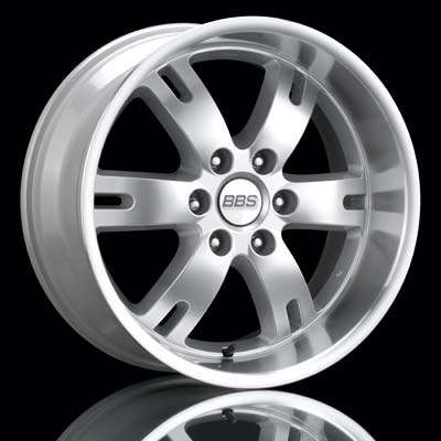

I have been on the hunt for a nice set of Tundra/Sequoia wheels like yours. I also like the TRD BBS wheels and the TRD Ivan Stewarts but $$$.

TRD Ivans are 16 x 8 so beware
Just so you will know the TRD Ivan Stewarts are 16 x 8 and they may rub the front A arms on a 3rd gen Runner.
They fit Tacomas nicely however.
good point
Good distinction. glad you mentioned it.
It may be a matter of the rubber more than the wheels themselves. I can only report that on my 99 running 265/75/16 BFG All Terrain T/A KOs I experienced rubbing on the A arms and could not stand it.
I believe some folks had better luck running the narrower 235/85/16s on Ivans.

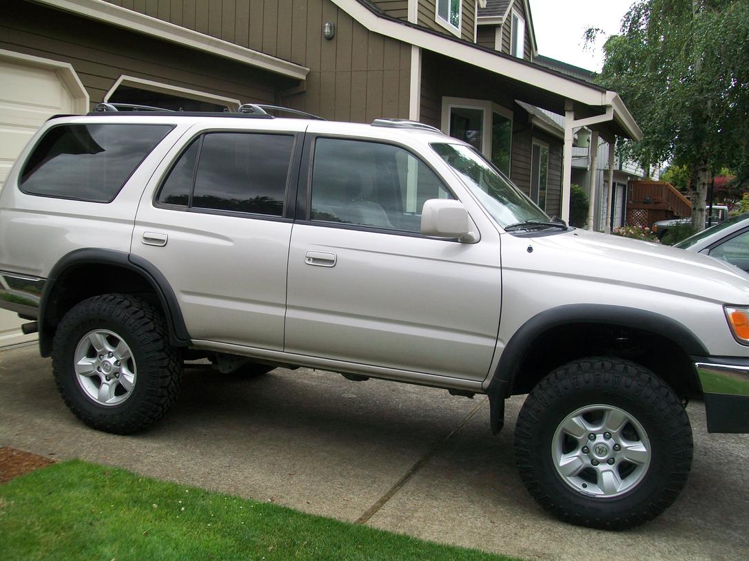

I am running 16" Tundra TRD wheels off an 06'. Dont really know the specs on them but they seemed similar to the stock 3 spokes that I pulled off.
I think these wheels look pretty good and think I am one of few that actually run them. Maybe I am the only one?
