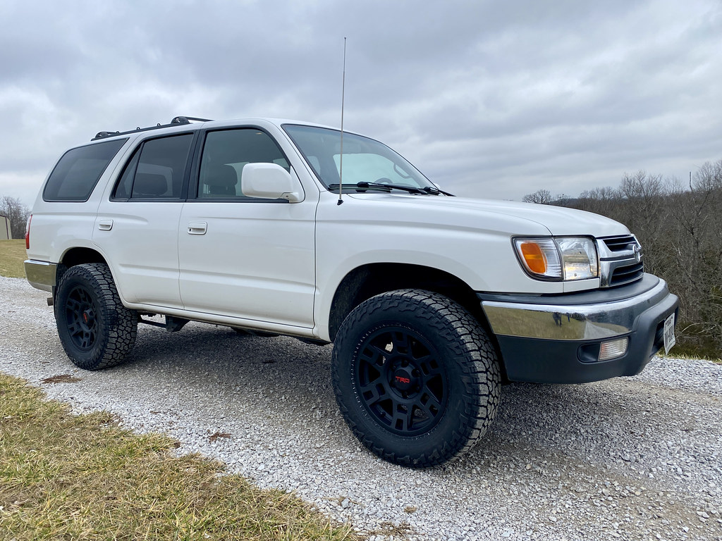

I've seen several pictures of people mounting 5th gen TRD Offroad wheels to 3rd gens. That makes me think it's easily compatible, everything considered.
3rd-5th gen OEM 4Runner wheels have the same bore. I have 5th Gen SR5 wheels on my 4runner right now.

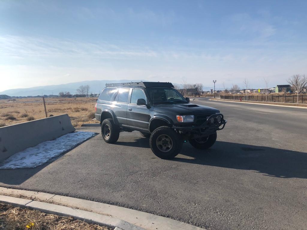

I put some 3rd Gen Tacoma TRD Sport rims on my stock 3rd Gen 4Runner without spacers or mods. No problems with fit, I have not experienced any rubbing. I have them posted on another T4R thread.
Put those wheels on my 99 and they were within 1/4" of rubbing the upper control arm. I put on 1" spacers. Now have 255/80/17 tires on them.

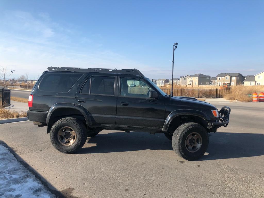

Super old thread but why not... got these for a deal. Wish the tires were bigger.
Untitled by 99blkx, on Flickr
17x7 5th gen wheels - $150
265/65r17 Goodyear Duratracs - $350 (including a brand new 5th tire)
Not bad for $560 after mount and balance. I did buy new lug nuts but that was a want, not a need. Still trying to pick up a 5th wheel cheap for a spare.

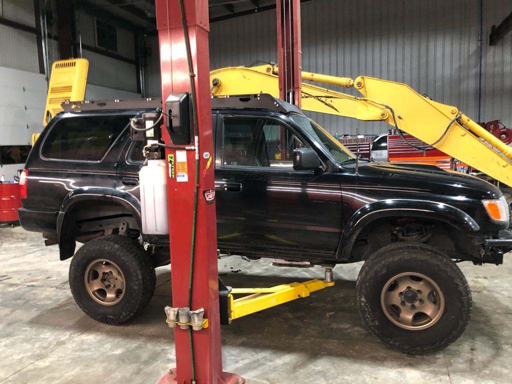

Thrilled with mine so I need to share. Fzj80 16x8 wheels rattlecanned in matte bronze. Fills out the fenders perfectly with the limited flares too btw
