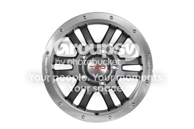

NON OEM. Pro Comp Rock Crawler series 16x8 4.25 back spacing gives me a total of 3" wider stance without running spacers, The style well that just takes me back in time.:nicethread: Plenty of upper control arm clearance.
Is there a reason why people run fj80 wheels?
Yeah I just put them on my 4runner. They are wider 8" than the stock rims 7". It gave me a little more stability after my lift. Also helps clear the a-arms when running 33"s or bigger. The alternative being running wheel spacers.

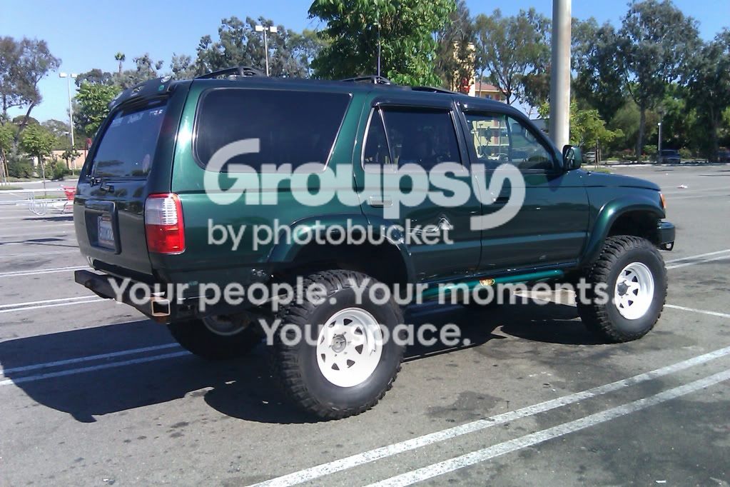

my old school BOYDS wheels in 15in. 31s on it.
<a href="http://s82.photobucket.com/albums/j248/niko11/?action=view&current=DSC_0513-1.jpg" target="_blank"><img src="http://i82.photobucket.com/albums/j248/niko11/DSC_0513-1.jpg" border="0" alt="Photobucket"></a>

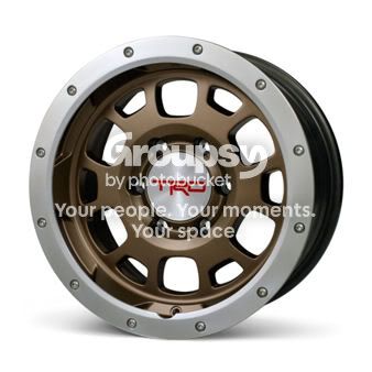

nice thread:thumb3: I wish i had some of those TRD Fj wheels! haha i actually tried to list my procomps to trade for some of those but no luck :( Someone needs to try these out??
TRD-17-inch-wheels.jpg~original
These are now available from TRD with our lug pattern and proper offset, but initial prices are $300+ a wheel. VERY cool wheel option IMO

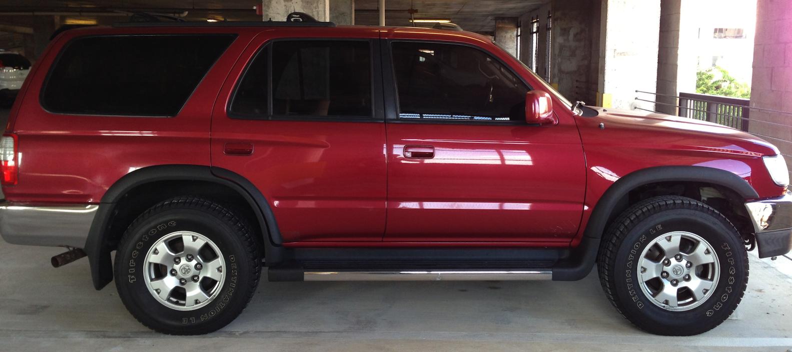

I run these Tacoma wheels:
I needed to buy new tires, but found a sweet deal on these take-offs.

If they are the same wheels as the poster above, then no spacer is required to run stock size tires. If you are running a 285 you may need spacers.
