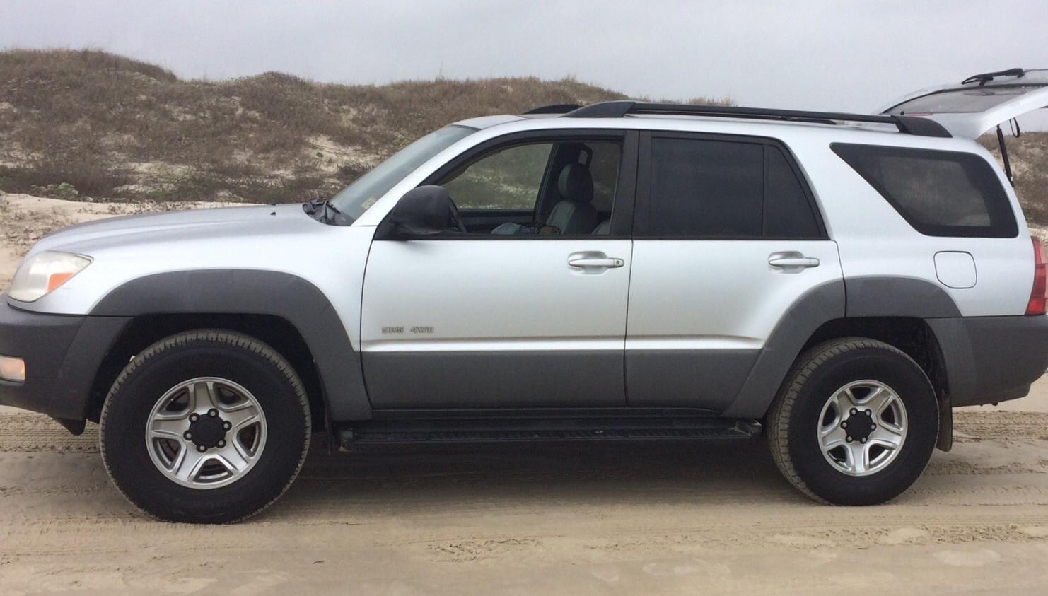

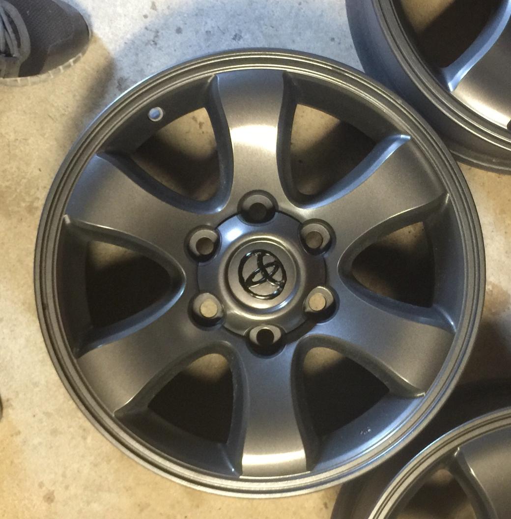

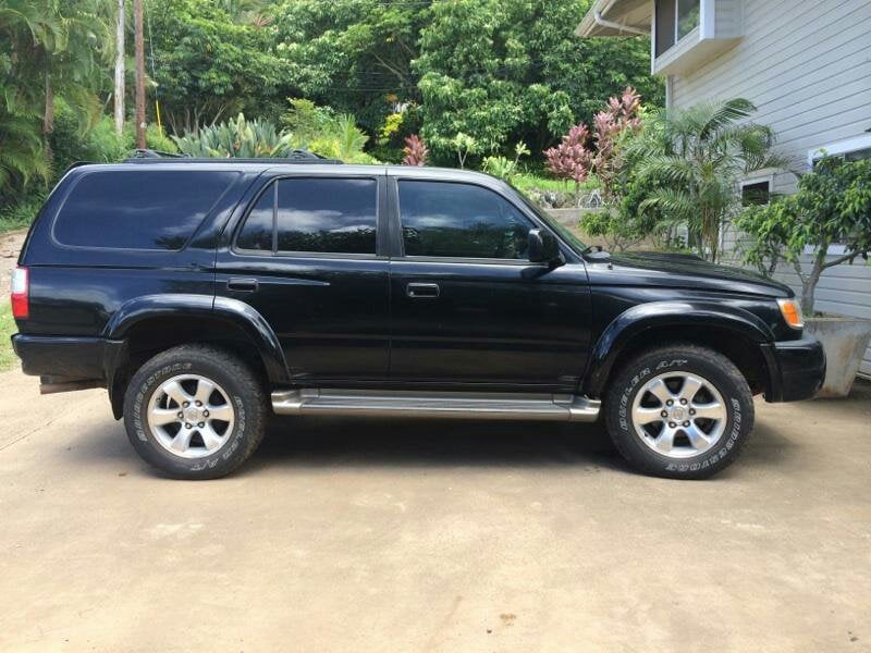

Got these last night for 600 off c-list. Came off a 2014 that drove home, then to the shop for a lift and new wheels and tires. Less than 100 miles. Fit my 2002 2wd:( with no lift and no spacers/adapters. Test drove around the block and slowly over a curb while wheel was fully turned. No rubbing.

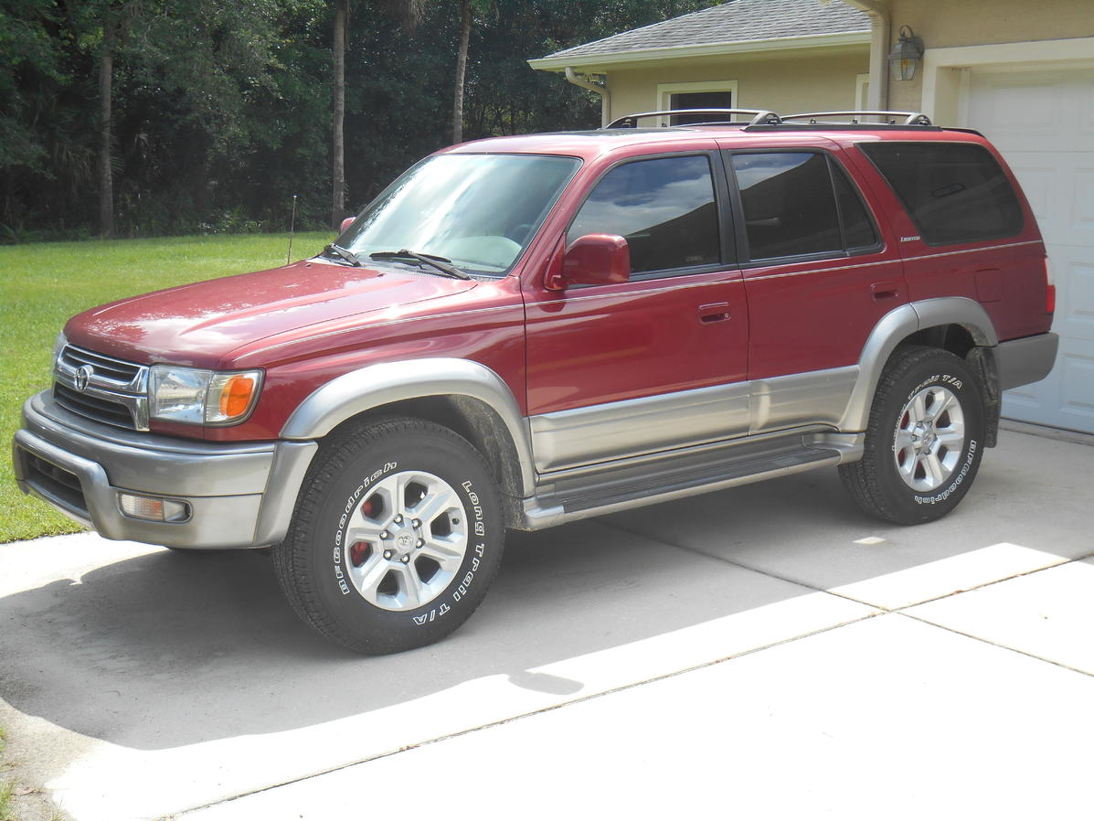

After seeing how good these rims look on your 4Runner and since you stated there were no fit issues, I found a set here in Florida on CL! They are brand new, the guy bought his wife a 2015 4Runner with an upgrade package that had 20" rims. They gave him these back with 25 miles on them. Unfortunately the dealership removed the tires so I will hit up Sam's for a new set. They look sweet and I am looking forward to installing them. Thank you for your post, it made it easier to buy the rims since they did not have tires that I could check fitment with. I had to eyeball it with just the rim in place, but they looked sweet even without the tires!
I will post pics as soon as I wear out my current tires!
LOVE The New Rims!!!
Wow, what an awesome difference. No interference issues, just like the other members stated (Thanx!) in this thread. The look really sets off the whole thing and shows off my brake upgrades.

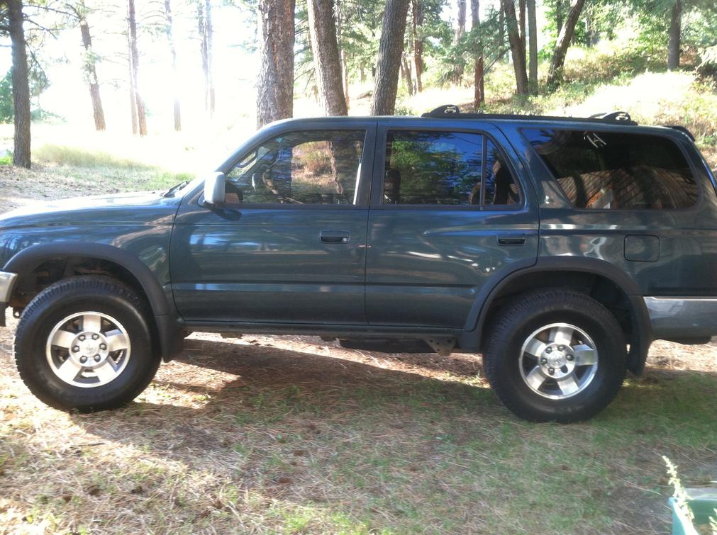

I am running 16" Tundra TRD wheels off an 06'. Dont really know the specs on them but they seemed similar to the stock 3 spokes that I pulled off.
I think these wheels look pretty good and think I am one of few that actually run them. Maybe I am the only one?

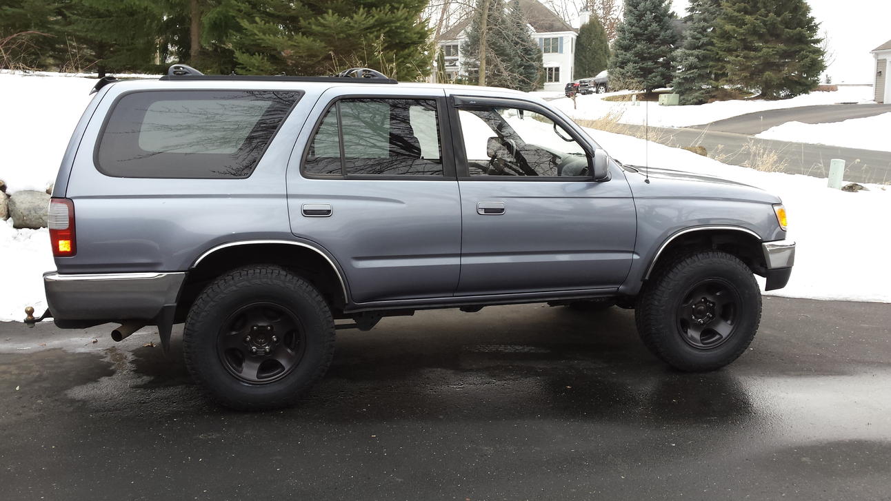

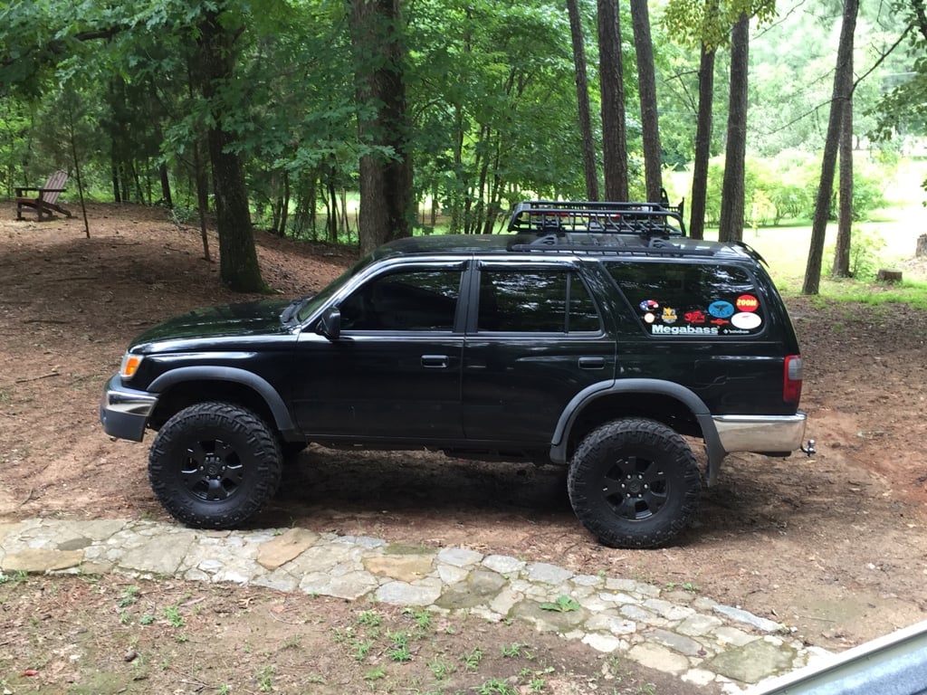

I put some 3rd Gen Tacoma TRD Sport rims on my stock 3rd Gen 4Runner without spacers or mods. No problems with fit, I have not experienced any rubbing. I have them posted on another T4R thread.

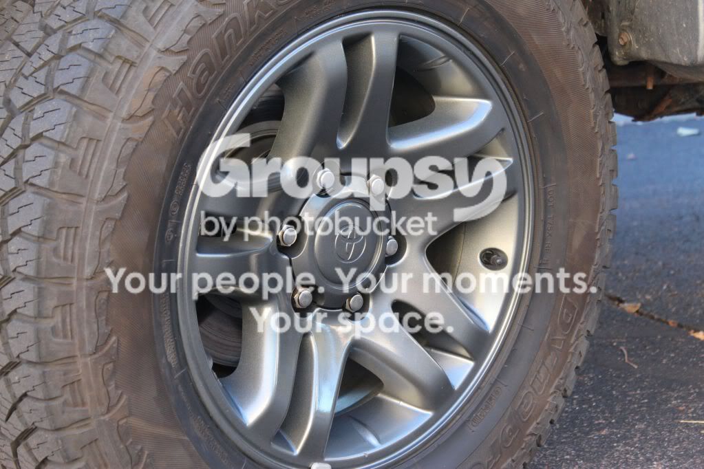

Here is my 1998 SR5. Bone stock with Landcruiser wheels painted metallic Bronze.
