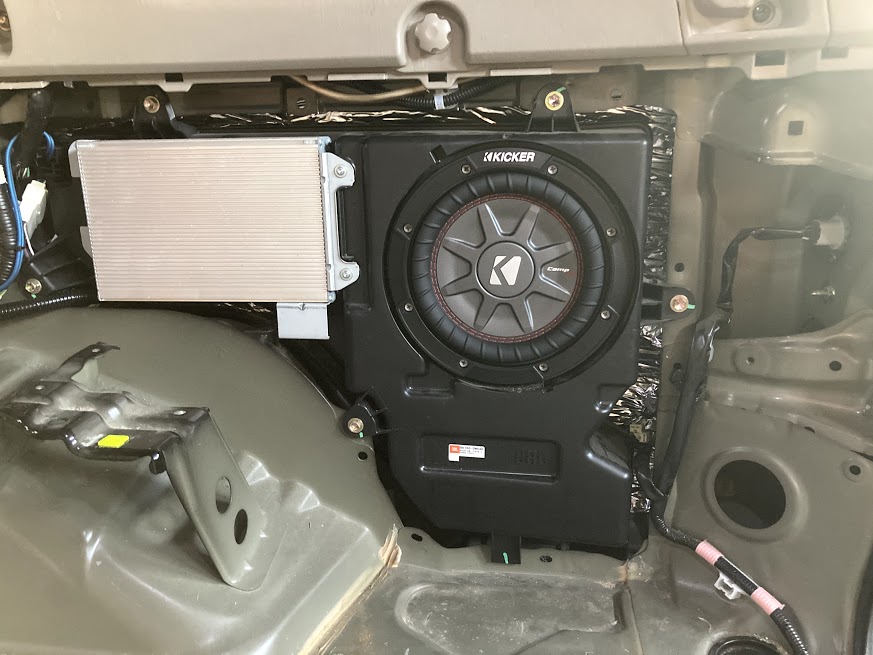

I finally had the chance install the amp and the sub. It was a long process but if you're patient it comes out well. The only problem I had was that the amp I used (Kicker 46CXA400.1T amp) was great for size but was too deep. That in turn made the top clip not connect too well. I also had to shave one tab on the cover panel. Still a great little amp and the gap is minimal.

I just installed kicker comp 8in shallow in the stock sub box yesterday. You just have to align the sub as centered as you can when you screw down the sub. I looked thru the grill and the speaker rib are cleared. There is a slight gap between the panel and sub. I`d say 1/16th

I did listen to it when I was bumping it. No rattle from the grill area but definitely rattle from everywhere else. LoL. In hindsight, I should have add a layer of foam on the speaker because the stock subwoofer had a grill with foam on it. But so far it’s not touching. Make sure you get some sound deadened on the metal and plastic panel. The box is glued together which I did add more sealant I had from home projects.
